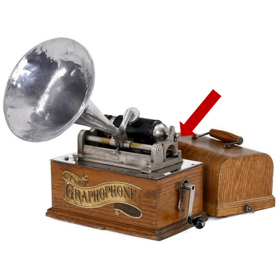

Just as a suggestion, if the mandrel faces resistance when the end-gate is in place, perhaps the issue is on the other end from the plate you are trying to remove. On the end gate is a bearing that the pointed shaft on the end of the mandrel fits into. This bearing may be moved in or out to adjust the tension on the mandrel by a screw - Red Arrow in the picture. Loosening the screw pulls the bearing away from the pointed mandrel shaft, providing more room (less tension), tightening the screw moves the bearing closer to the pointed mandrel shaft, providing less room (more tension).
I cannot remember if there is an additional set screw on the back side of the end gate that secures the mandrel bearing screw. My N is still packed, and inaccessible at the moment. I just grabbed a picture from the internet.
As well, the holes on top of the bump outs in the end plate you are looking to remove are channels for oil ('ve added red arrows to your picture and attached it here). It may serve you well to put in a light machine oil (many conversations on the forum about what kind) to ensure the gears are well lubricated. Just make sure the holes aren't plugged with gunk.
Hope that helps.
Shawn

Thank you , Shawn! I had already adjusted and lightly lubricated the bearing on the end gate to minimize resistance, and I've also lubricated the channels you point to with sewing machine oil. That did improve matters, but the mandrel still encounters more resistance than I'd expect.
There are also two channels for lubricating the feed screw. I'm planning to clean the feed screw as well as possible while it's in place and then relubricating that as well.
Thanks again!
