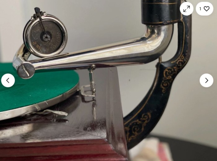

For a late Victor 5, it still has the slide in type elbow ???
And what about the reproducer, should it not be an Exhibition Reproducer ?

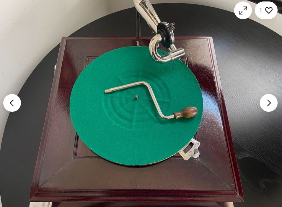

A completely genuine and original machine but the finish on the case and horn is absolutely awful. Its a project machine and not worth the asking price, even if it is quite uncommon.

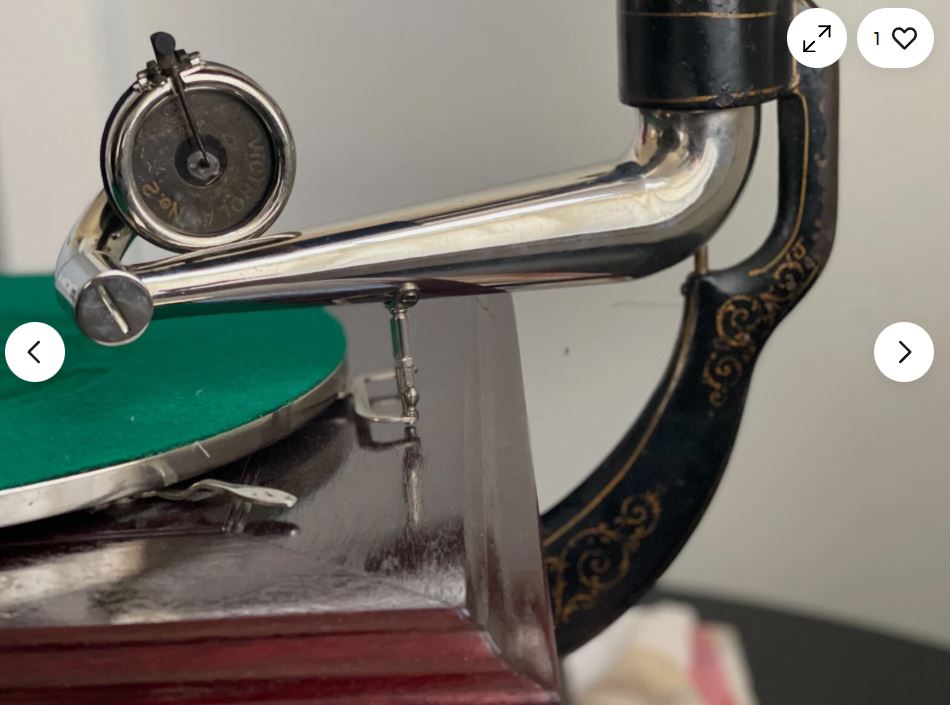

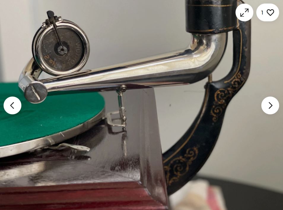

The first picture shows an Exhibition fitted, but the others show a Victrola No.2.JeffR1 wrote: Thu Jun 12, 2025 9:48 pm And what about the reproducer, should it not be an Exhibition Reproducer ?
The listing states Exhibition, but the pictures are misleading and need amending.

Yes, it's definitely one of the rare late production mahogany V-V models, as mention here -- http://www.victor-victrola.com/Victor%20V.htmJeffR1 wrote: Thu Jun 12, 2025 9:48 pm ... And what about the reproducer, should it not be an Exhibition Reproducer ?
According to the "Victor Data Book" by Robert Baumbach, the late V-V models were equipped with the #2 sound box. Also, according to an illustration provided, the brake stop post attached to the tonearm is also correct.
As for the finish, it looks to have been redone at some point. There was a post on this forum a few years ago that discussed the restoration of a mahogany V-V -- viewtopic.php?t=46183 -- but as usual, all of the attached images are gone. This one -- viewtopic.php?t=51840 -- however, does show the finish in its original (as found) state, though it looks like an earlier model (?!?)
I can't tell if it was coated with a polly varnish or shellac. It seems to me, though, that a careful refinishing job might make it look more original, providing the original stain and grain filler is still in place. I'd image it matched the "piano gloss" mahogany finish of the standard tabletop and upright Victrolas of the period.
