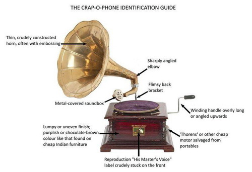

The thing to avoid is what is known as a "Crap-O-Phone," which I understand is readily available in China, India, etc.. These are relatively easy to spot, once you familiarize yourself with their key features.
If you do an online search for Crap-O-Phone, you'll probably find dozens of references.
The reason to stay away from them is because of their horrible build quality and sound quality. They in no way are similar to the quality outside horn models produced during the early part of the 20th century.

I have been searching online and have only found new players or "crapophones".
