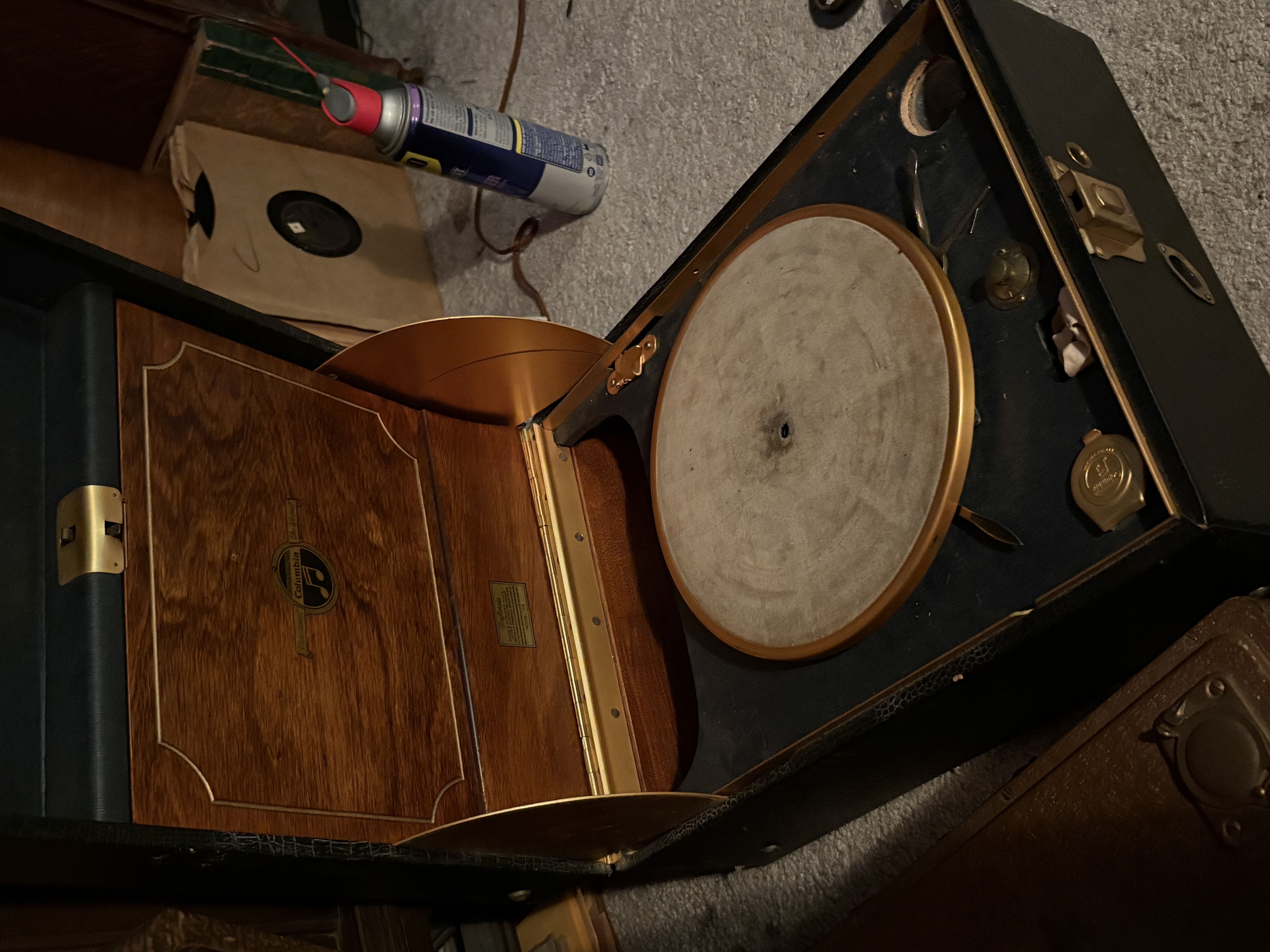

I have a Columbia 175 portable that I just can't get at the motor of. The motor has one of those screw-on spindles but even after removing it, the turntable is thoroughly stuck on the spindle. I don't know how to get the motor board off of the case, I have removed all of the screws around the perimeter of the turntables to no avail. Anyone know how to get these things apart?
The offending machine ^
Columbia 175 Portable Dissassembly

The turntable is probably "glued on' with old grease. Try tapping around the edge with a mallet or piece of wood to loosen it. Then grab the edge and lift up. You can also try to hit the spindle while lifting... Eventually you should have success.

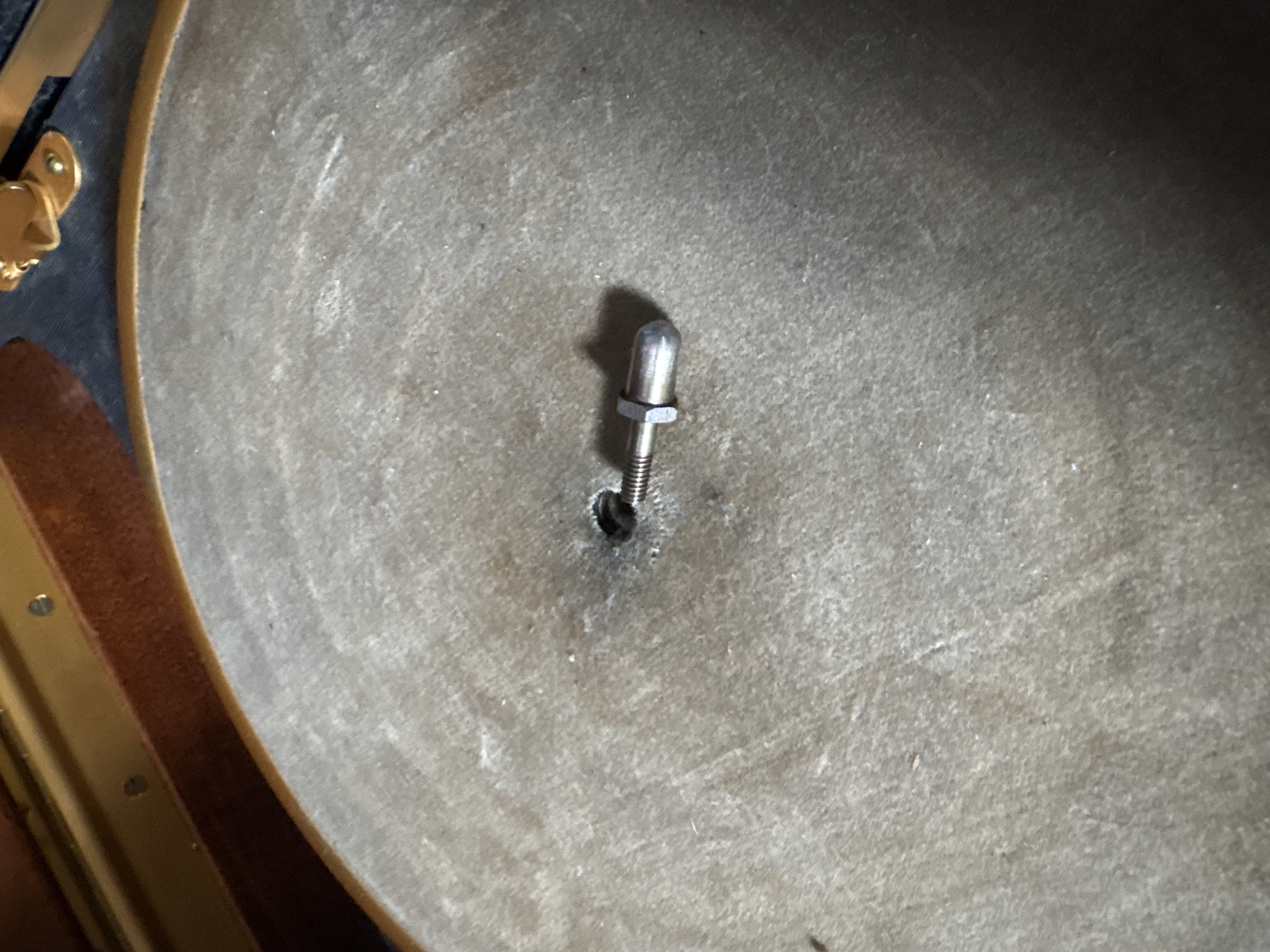

Unscrewing the spindle is necessary because it acts as a nut, holding the turntable in place. I have been keeping it partially unscrewed while I used the mallet to give me a place to apply pressure while allowing the platter to break free.Inigo wrote: Sat Sep 20, 2025 2:25 pm Could be easier if you screw in the spindle, then use the mallet, then unscrew again... Is it necessary to unscrew the spindle to extract the platter?

Here is the spindle situation.

You could also insert wood wedges around, under the platter, to help it out, and then give kicks with the mallet... small repetitive kicks.
You need to give them with the aid of a blunt punch or something, and to be sure that the kicks go where they are needed. Your idea of using the spindle itself, half screwed, it's the same I would do.
Eventually it will start to lean off the spindle. Be patient and careful.
Wish you luck! Turntables can be very stubbornly attached are years of use.
