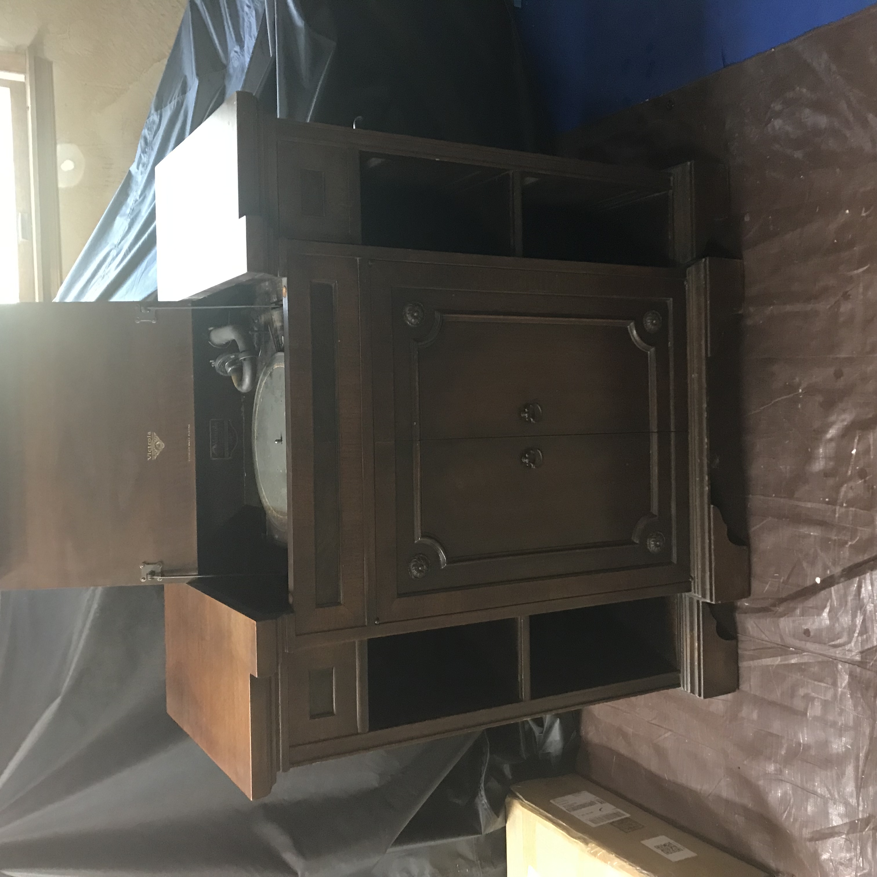

I recently purchased the Victor 8-35 ( pictured).
By all accounts, it hasn’t been monkeyed with in the past.
I was surprised when I got it home and could not get the crank to engage with the female end of the motor.
I verified that I have the correct crank, and the crank engages fine on my work bench with the motor board out of the case.
When I look through the escutcheon with a flashlight,
It looks like the receiving end is close to being lined up. but slightly high.
This would indicate that the spacers between the motor and motor board are worn, I think???
A big deal to fix or other thoughts?
Thanks,
Gene

Remove the two crank escutcheon wood screws.
This will allow plenty of wiggle room to get the crank to mate with the motor.
Then reinstall the wood screws.

Hi Gene-- I've had the issue come up at times-- You're likely correct, that the felt washers may be flattened. They aren't really "spacers", they are noise dampeners that reduce vibration between the motor and the motor board.
If, as you say, the motor seems just a bit high, replacing (or adding to) the felt washers would lower the motor a little and may give you the alignment you need for the crank. At times, I've used pieces of rubberized flooring underlayment or even leather for the washers-- Mainly something soft and flexible to dampen the motor noise transfer.
You could also adjust the escutcheon, as was mentioned, but be careful that the crank isn't rubbing on the edge of the escutcheon too much. Over time it will wear the finish off your crank. We've all seen cranks that actually have a groove worn in them from rubbing against the escutcheon.

After many hours of trying to get the crank installed in the motor, and without doing anything different. the crank magically lined up and mated with the motor.
Go figure.
Maybe the cursing helped???!!!
