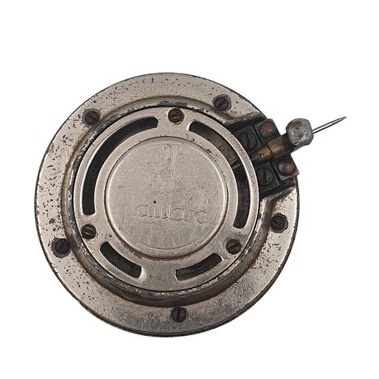

I have another sound-box which may have the same kind of connection maybe ? (Photographs 'below'). It kind of looks similar perhaps.
I have been keeping it in my garden pond for a few years ha ha !
Anyway, from what you have said I guess this one is much earlier than the one 'above' and belonged to an external horn gramophone ?
Thank you very much for your help as always.

by Inigo
Curiously the 5-screw arrangement and the large diameter back reminds of the latter Paillard Maestrophonic soundboxes of the 1930s

Inigo wrote: Sun Nov 09, 2025 1:22 pm Curiously the 5-screw arrangement and the large diameter back reminds of the latter Paillard Maestrophonic soundboxes of the 1930s
Thank you Inigo.
I don't know anything about the Paillard Maestrophonic sound-boxes (purely my ignorance).
I had not considered that the 5 screw arrangement may be significant.
Very interesting.
