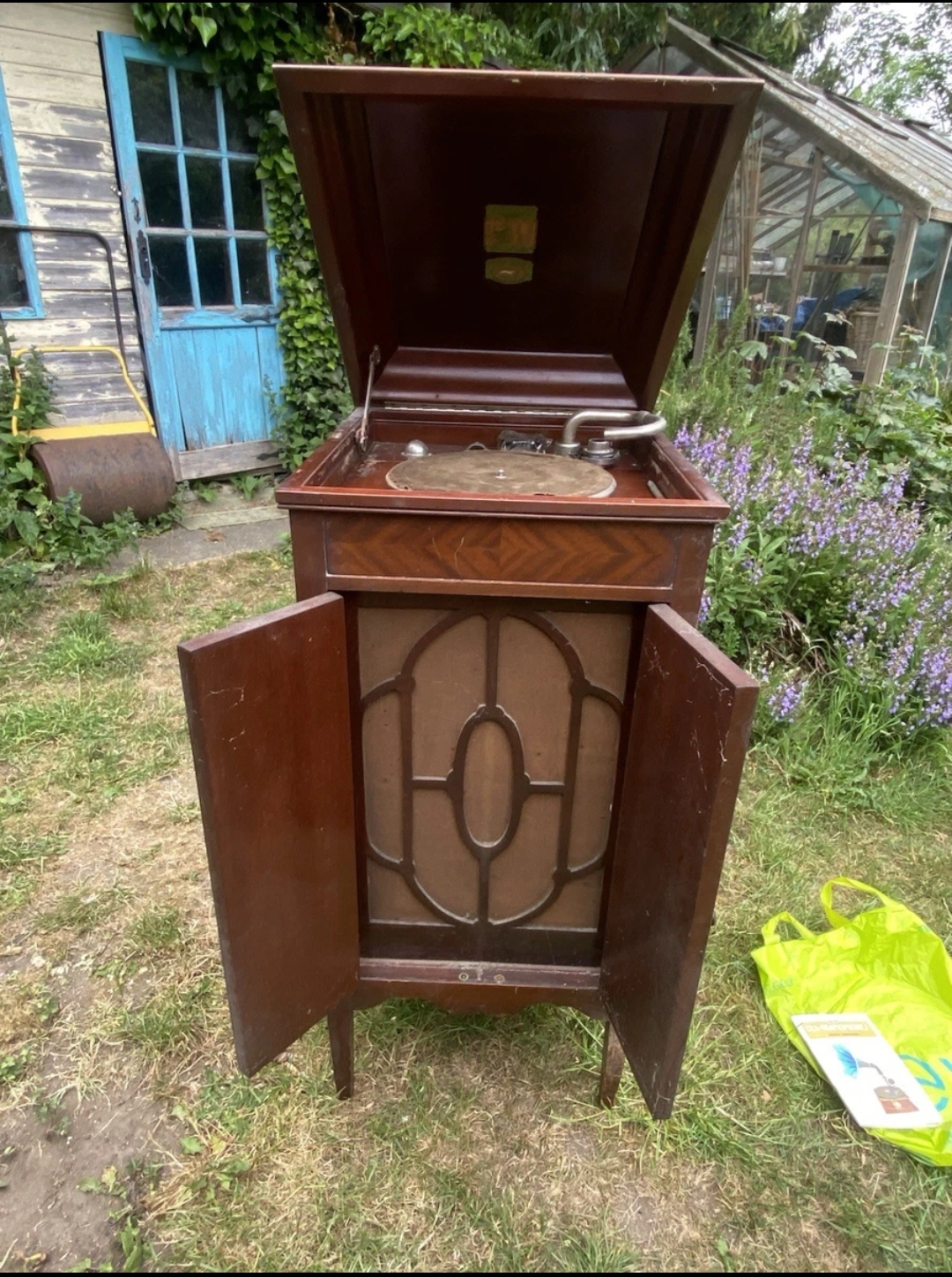

This is the basic version of the MP22, lacking the crescent shaped tonearm and counterweight of the de luxe version.
The seller states that the horn is missing. This is unlikely as the horn is built into and forms part of the sides of the cabinet, but prospective bidders would be well advised to ask the seller to lift the motor board and photograph what lies beneath .
