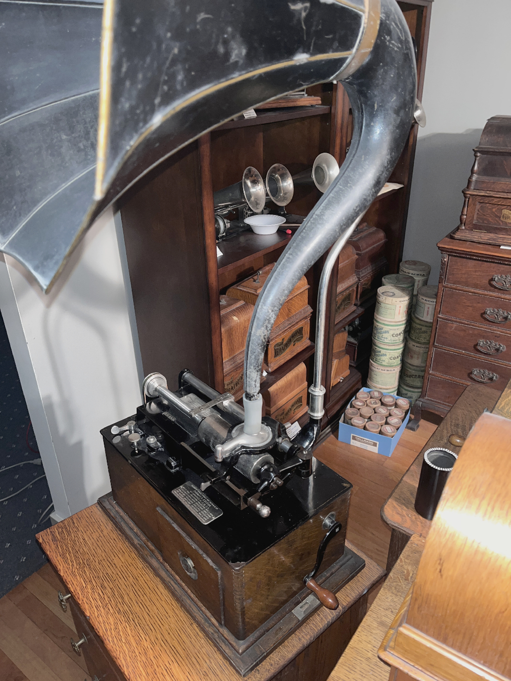

Re: 2/4 Spring motor or Class M ?
This is a spring motor I bought at a house auction a few years ago.
With combination attachment, Diamond B reproducer, and cygnet horn.
What's even more amazing is whoever did the upgrade didn't cut the cover to fit over the back bracket.
Chuck
Chuck

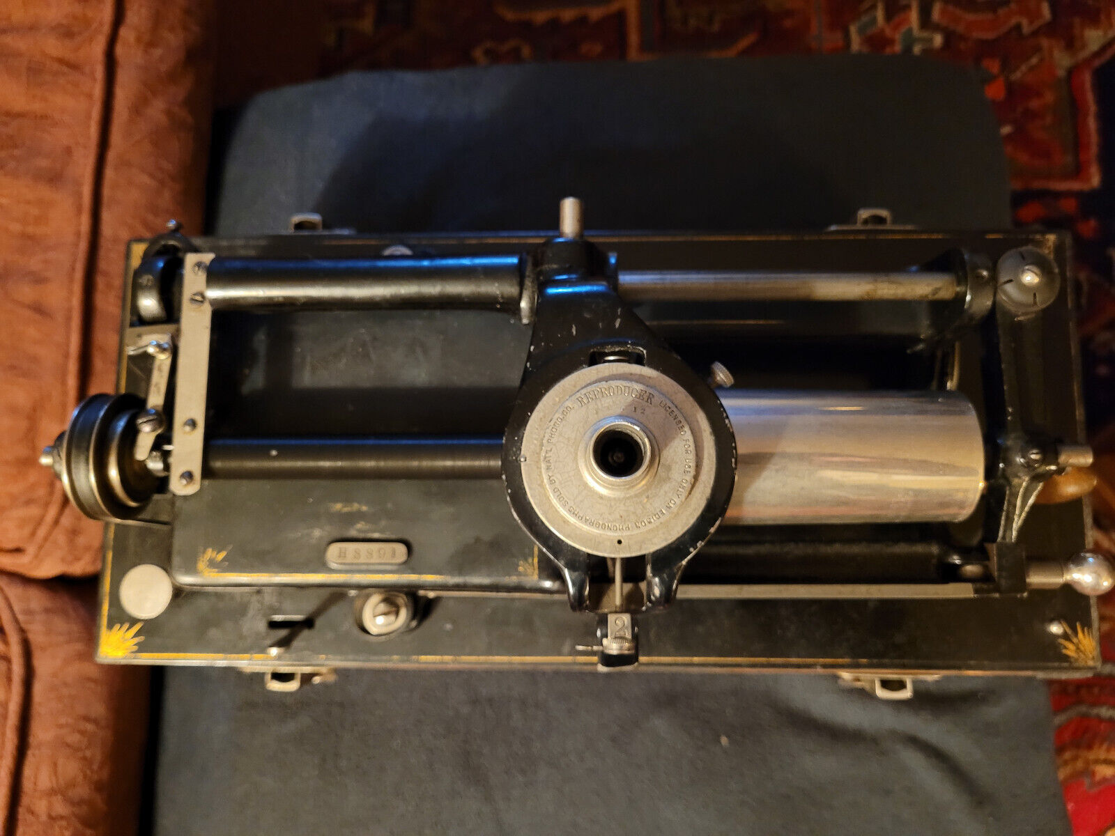

Okay - there is a late Class M with a 2/4-minute attachment and a Model O Reproducer. I was unable to download the picture to this site, but it's shown on page 103 of Antique Phonograph Gadgets, Gizmos, and Gimmicks, by Fabrizio & Paul. Here's an informal snapshot...

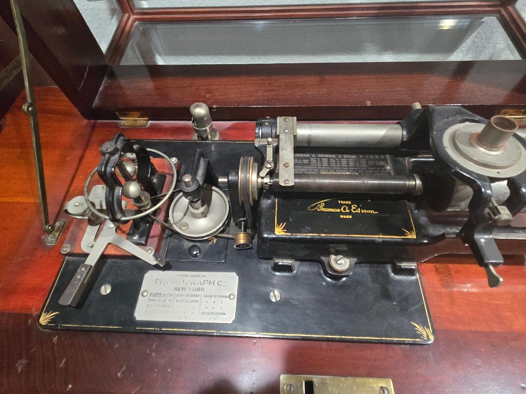

How about some pics of the earliest Homes and Standards to be "Amberolized"?
Edison Home 3391. No bolt holes to accomodate a cygnet horn on the case. O reproducer is pot metal and stuck in carriage.
