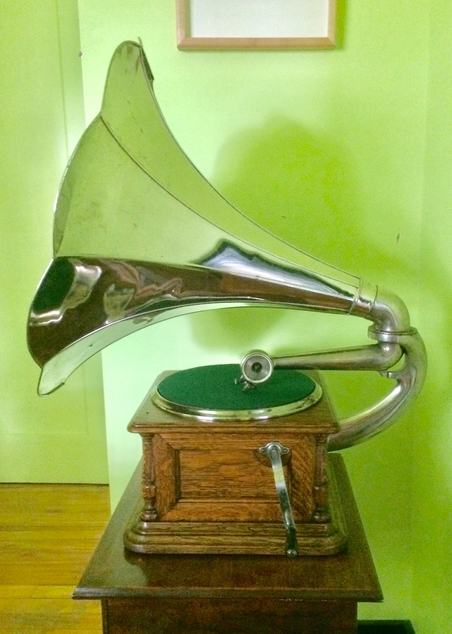

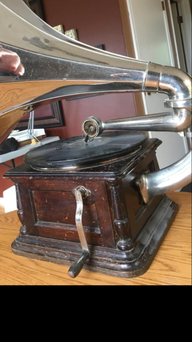

I asked my question about the decal earlier because I was about to restore the finish on my Columbia BII.
In the before picture you can see that someone had recoated the oak case with a mahogany coloured finish. Luckily, it was shellac, and it came off easily with denatured alcohol (methyl hydrate) and 0000 steel wool and a rag or two. For the nooks and crannies, I used a fine artist’s brush and more alcohol.
I had to take the finish right off because of the mahogany-dyed recoat, and I refinished it with fresh shellac, applied in the French polish method. I thin the shellac quite a bit, but it does not take long to build up a finish to the desired gloss and there is no chance of runs or lumps when done this way.
The non-crank side base edge piece was missing as you can sort of see in the before photo, so I had to fabricate that, but other than on the new piece, I did not use sandpaper at all, just the 0000 steel wool.

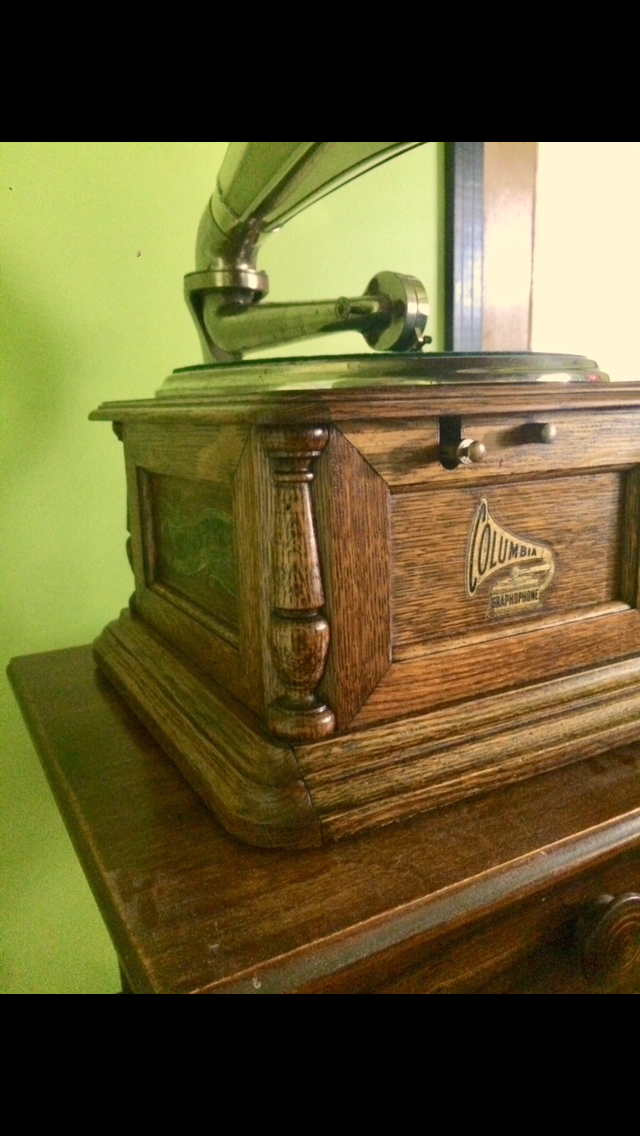

The front decal cleaned up very nicely.
I did not rub on it at all, I just dabbed gently at it with an alcohol-soaked cloth.
The side decal did not work out quite as well, but I will try the gold paint method described above.
Hoodoo
