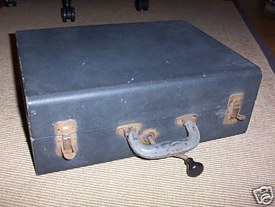

Here's what looks like a very interesting portable:
http://cgi.ebay.com/Phonola-Portable-Re ... 240%3A1318
According to the seller what appears to be an electric pickup is actually part of a concealed acoustic system.

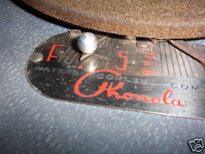

Phonola Dynacoustic portable, wind-up phonograph made by the Waters Conley Company. This is a very unique player as it doesn’t utilize the standard, disc-type reproducer head but employs a type of vibrating rod within the metal tone arm. The arm is made to look like a late 1940’s electric phonograph arm with cartridge but is actually a totally acoustic unit. Wind up motor operates well, steady and accurately and player produces a warm, full sound but with some distortion. Has greater bass response than most normal acoustic phonograph portables. Needle is changed using the traditional thumbscrew located on the front of the arm.
Case covering is intact, somewhat dull but all the outside metal parts (hinges, escutcheon, clasps) show surface rust. Slight separating of fabric at edges near a couple of corners.
Image Image
Image Image
Image Image

There was one for sale about three years ago on eBay, which had photos of the underside of the tone arm and the inside of the case, after the motor board had been removed.
Running the length of the underside of the tone arm is a straight, thin metal bar. The front end is connected to the needle, and the other is connected to a fulcrum like joint, that itself, is attached to the center of a "speaker"--really a cardboard cone--situated directly under the back mounting of the tonearm. (It looks like a conventional speaker is mounted under the tonearm's base in the photograph, but in reality, it's a cone-diaphragm.)
Here's a crude drawing. Hope you can make sense of it:
A similar design concept was used for the Vitaphone Talking Machine (See, Page 197 The Talking Machine Compendium)
