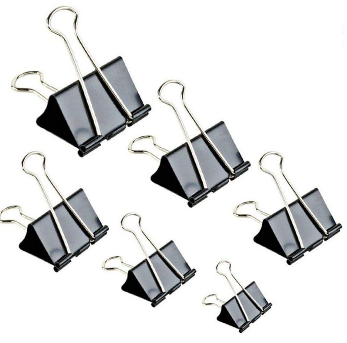

- Posts: 2393
Re: Hit of the Week records
What I've done is to "clip" them in place, using a binder clip like these:
1--Put the record on the turntable.
2--Put a small round piece of cardboard with a hole cut for the spindle over the record.
3--Position the clip as far as you can downward on the spindle to secure everything in place.
OrthoFan
OrthoFan

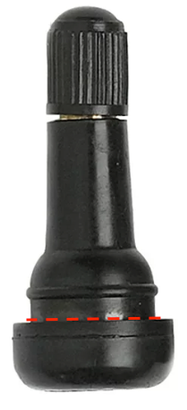

- Posts: 6823
This works great and the price is right...FREE.
To play Hit Of The Week records, use a tire valve as a record hold down. Obtain a Schrader valve from your local tire store (usually free) and cut off the large end as shown. This makes a perfect hold down to keep the records from spinning...
