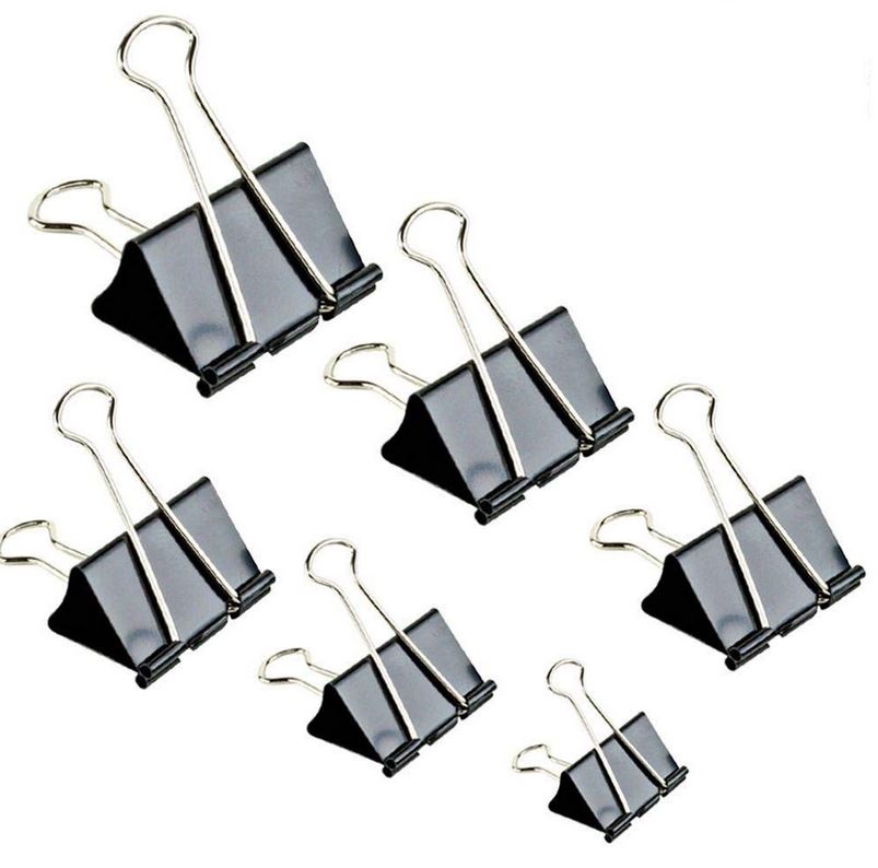

What I've done is to "clip" them in place, using a binder clip like these:
1--Put the record on the turntable.
2--Put a small round piece of cardboard with a hole cut for the spindle over the record.
3--Position the clip as far as you can downward on the spindle to secure everything in place.
OrthoFan
