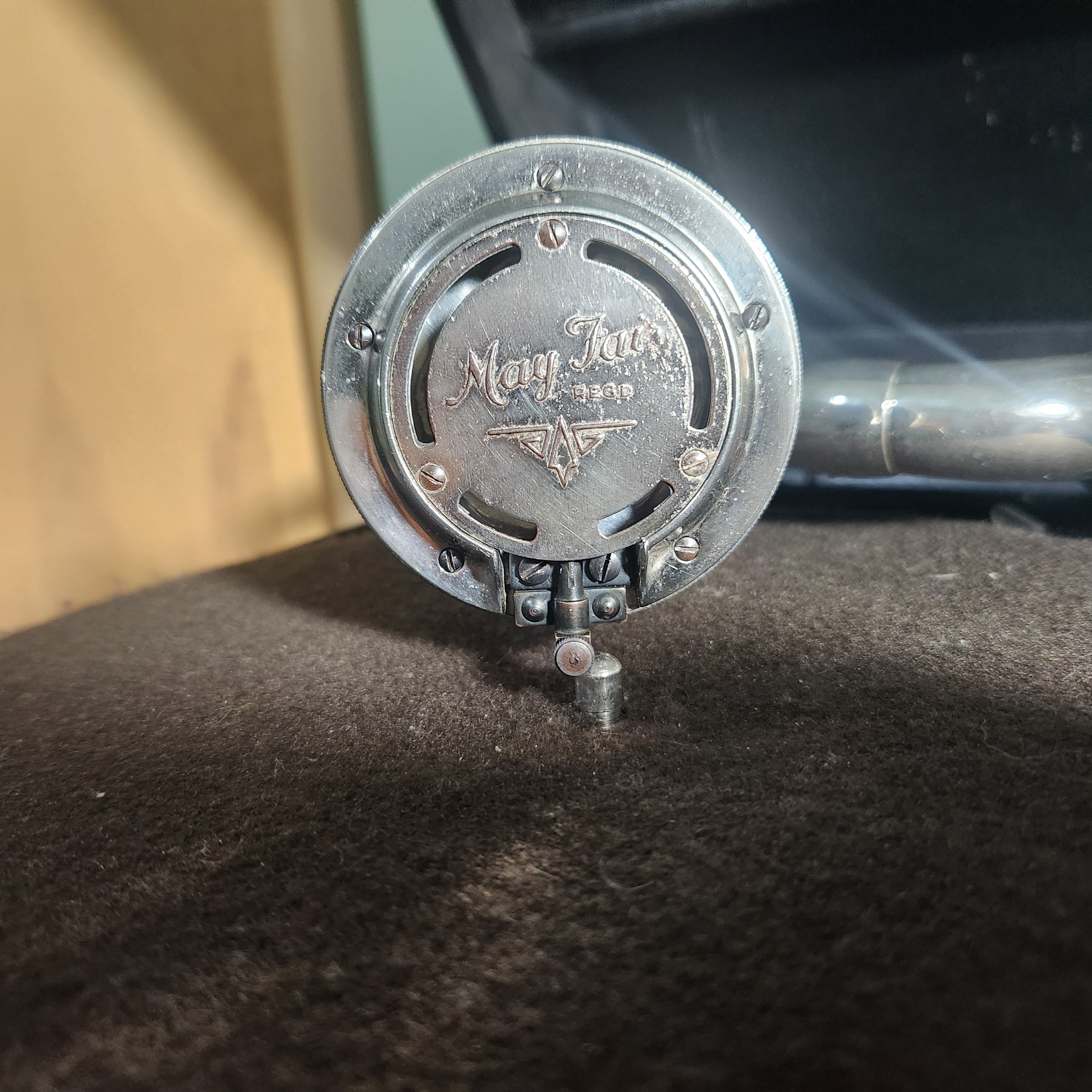

This is how far I have to adjust the reproducer to make it hit the spindle. I doubt this is how it's designed to play, since the needle is vertical And about the comment of vertical records, i did not mean that it swings when playing, when I said the back of a Victrola record, i meant just a blank record, since they typically have a blank back side, that's an error on my part. I only play lateral records on this machine.Curt A wrote: Sun Mar 16, 2025 5:44 pm Ideas if leveling doesn't work:
When the reproducer is swung to the center, the needle should touch the center of the spindle. If not, rotate the reproducer slightly until it does.

What brand is your portable? It may have the wrong reproducer on it - it appears too large.

The correct angle for your needle when playing should be approx. 60-70 degrees off vertical...
It would be better to angle it slightly than to leave it vertical where it digs in.
