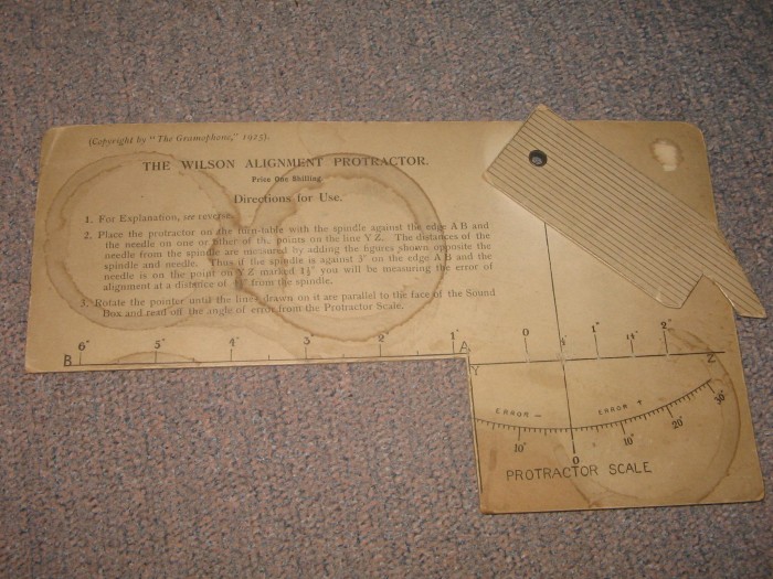

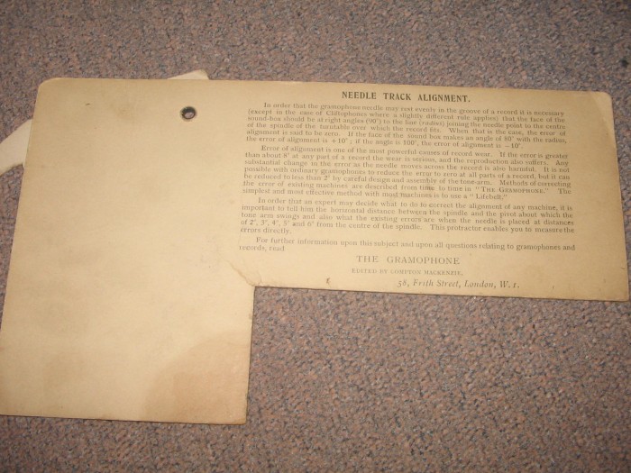

Today I stumbled across photos of the original Wilson Protractor I used to own. Alas, to my eternal regret I sold it before I became involved in EMGs, Experts and thorn and fibre needles, at which point I had no idea of its significance. Has anyone seen another?
A printable document from which one can be made appears earlier in this thread. Perhaps I should update the document to include these images.

Thank you again for your help. Sadly, my printer is currently non functional, so i will have to wait on printing it.Orchorsol wrote: Thu Apr 10, 2025 6:53 am Today I stumbled across photos of the original Wilson Protractor I used to own. Alas, to my eternal regret I sold it before I became involved in EMGs, Experts and thorn and fibre needles, at which point I had no idea of its significance. Has anyone seen another?
