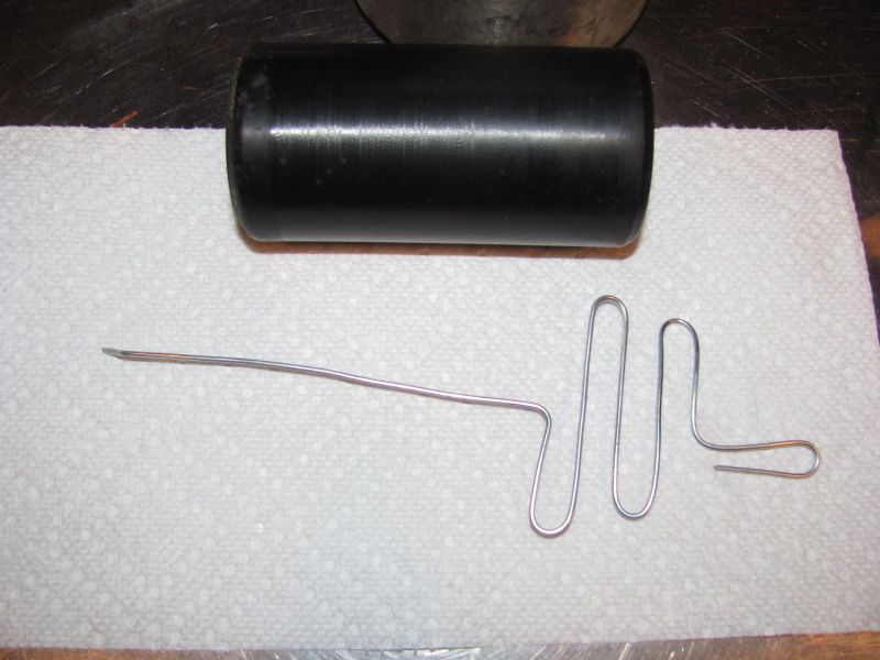

Re: Repairing a cracked cylinder record "Brown Wax"?
Wax welding. It works for me! The record in the photo is not one I repaired. It's only there for scale.
I have sucessfully welded several black wax records from the inside to keep the crack closed when inserting onto a mandrel. However, once you have even a hairline crack, even if repaired, each playing wears the crack larger. If you thought you had a unique title that needed to be saved for posterity, repair and play it once to record; then put the record away.
The paper clip method is how the record DR repairs cracks, he uses an alcohol lamp, make sure to scale your end though so it does not poke through the surface onto the top of the playing surface. Dental wax, can be used to fill the chips.
