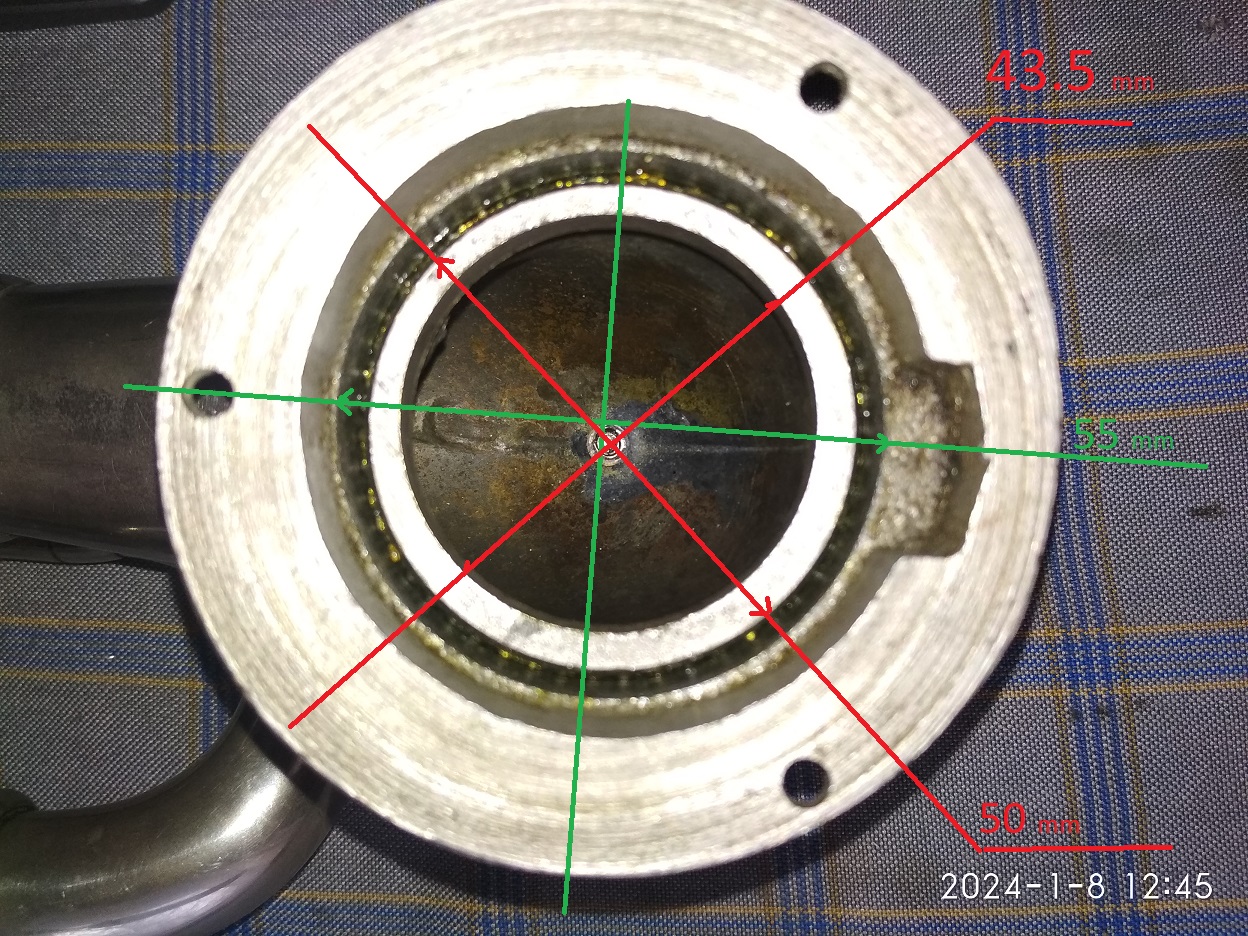

need help on how to attach the tonearm to the horn.
I have a Gilbert tonearm.I want to use the tonearm in a new project.
Tonearm measurements revealed the problem.
The centers of the bearing and the tonearm tube do not match.
What should the insert between the tonearm and the horn look like to ensure a tight seal?
I appeal to the owners of Gilbert gramophones.
What does the transition from tonearm to horn look like in Gilbert gramophones?
Best regards,Aleksandr

It looks - simply put - horrible: just the tubing of the horn facing the tubing of the tonearm, with *large* oval holes on the flange for the screws in order to leave overabundant tolerances.

Thanks Marco,
There are no parts between the tonearm tube and the horn tube?
Then there will be no low frequencies.
Leaks must be fixed.
Can you show a picture of the transition?
Posts: 4674
Re: Gilbert portable.
And the wooden board between them? This could be the adaptor if thick enough... the horn being attached from below and the tonearm from above, leaving a thick piece of wood between them, with the subsequent hole, of course...
