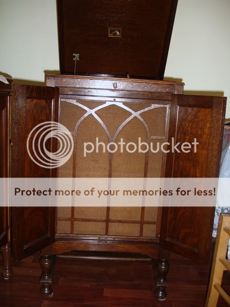

Yes, the escutcheon does look a bit odd...too big a hole and new...but I should think if it isn't "correct" I am sure an appropriate one should be able to be found without too much trouble.
On the cloth covering the horn opening....with the type of cloth used by HMV during this period it is impossible to tell from a photo if it is correct. In real life the cloth is a fine weave and has a gold-ish appearance...however it is almost impossible to photograph it to show it as this. Most photo's come out with it looking almost black...I guess it just must be the weave of the fabric! Let us know when it arrives what the fabric is like and also the escutcheon too.
Nevetheless, its still a nice machine.
RJ 8-)
EDIT: here is a link to a picture I took of the type of cloth it should be. Apologies for the odd angle but I was trying to get the cloth to show in its proper colour!
http://i456.photobucket.com/albums/qq28 ... HMV014.jpg
