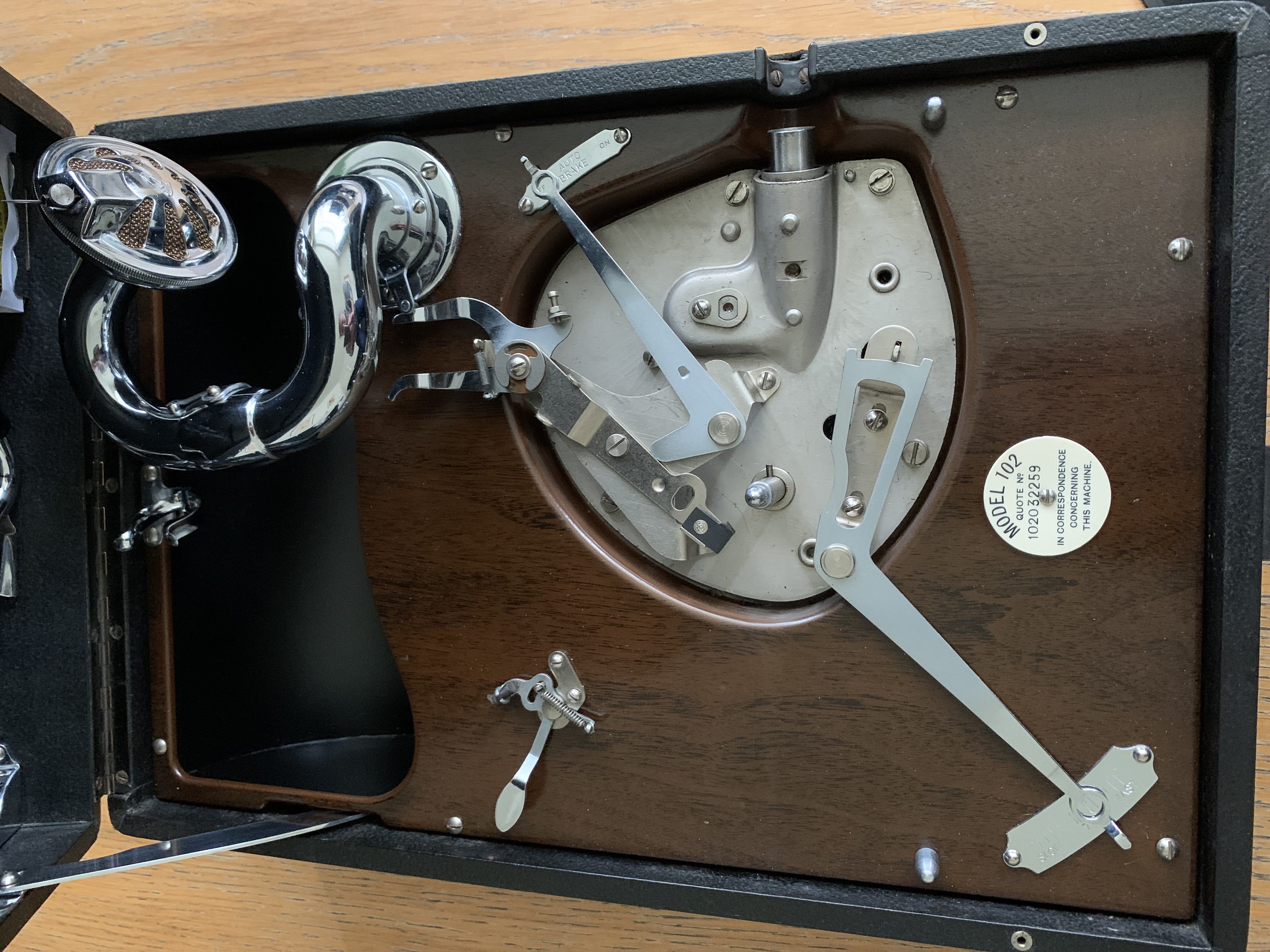

Hi, and I can go lower still! Here's my 102 with the metal motor board and the later autobrake. The no16 soundbox was damaged, I managed to repair it but it still doesn't sound great so I got a no5 which is very nice.
Serial number 1020 32259

Yes, but this number is lower than the highest number reported with a No 5 brake -- and the 'on-off' plate is secured with screws rather than rivets, which as Roger pointed out means that it started life as a 102 with No 5 brake, but was later modified to 102A spec with the No 6 brake, which was available as a kit for this purpose.
MistertT 64
Posts: 4
Joined: Tue Dec 07, 2021 5:07 am
Re: HMV 102 production numbers
Post by MistertT 64 »
Thanks for the information, I didn't know that was the case, all very interesting.
