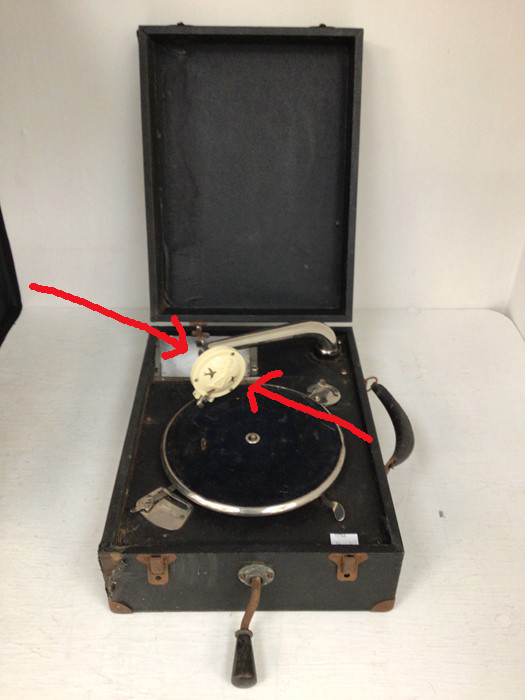

I came across one of these sound boxes (amongst many others)on the internet and remembered this thread so thought it might be of some interest :Lampman5 wrote:Hello
Can anyone identify this unique Bakelite & steel reproducer that is only marked "Made in England"?
Guessing it is from a child's phonograph and appears to be very well made. It is 2 ½" in diameter.
Any information would be appreciated.
Thanks
http://www.londonauctions.co/lot?id=101718

Re: Identification of English Made Bakelite Reproducer???
I came across one of these sound boxes and remembered this thread so thought it might be of some interest :
https://www.the-saleroom.com/en-gb/auct ... 2100b09e69

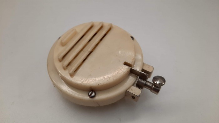

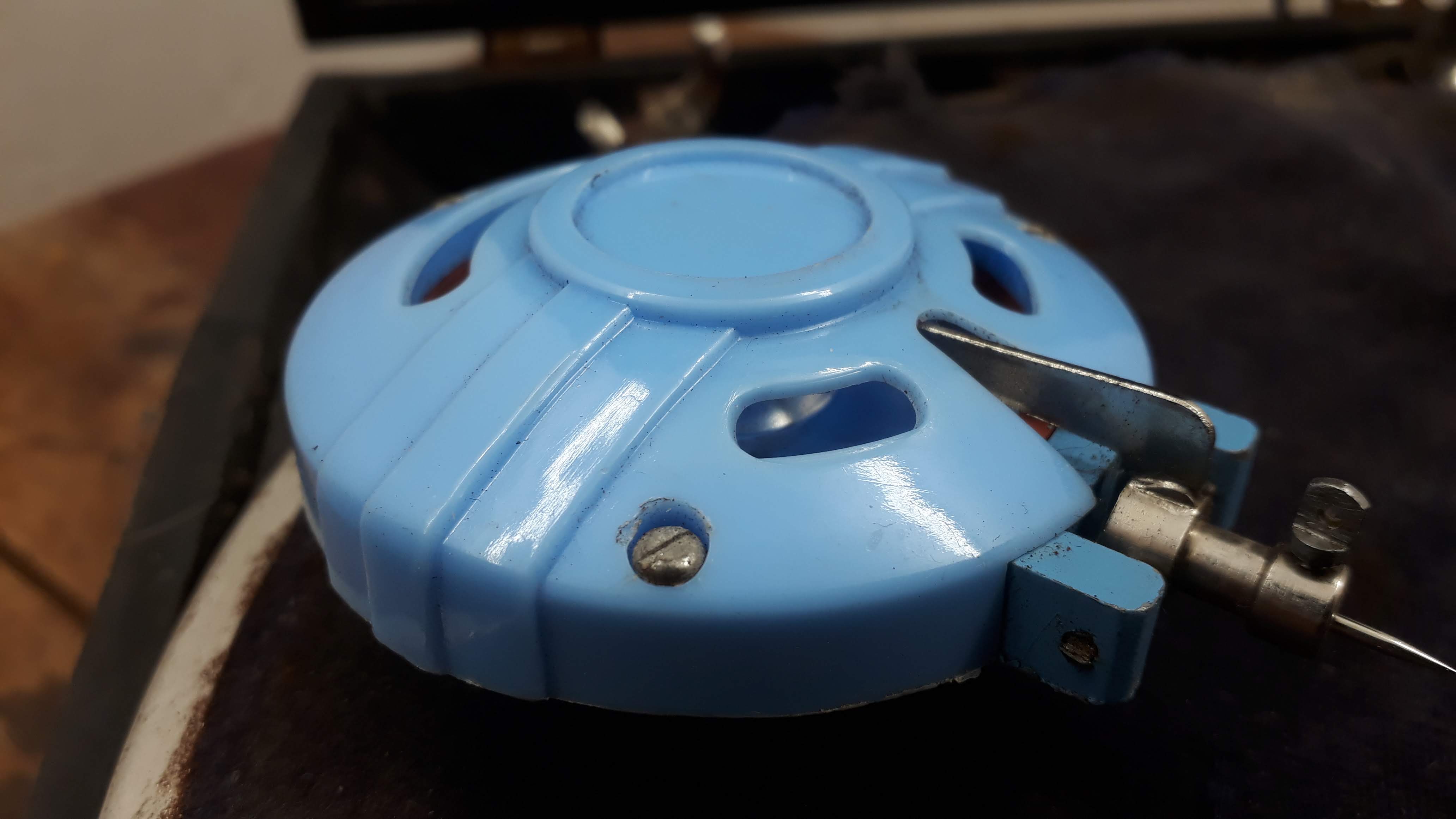

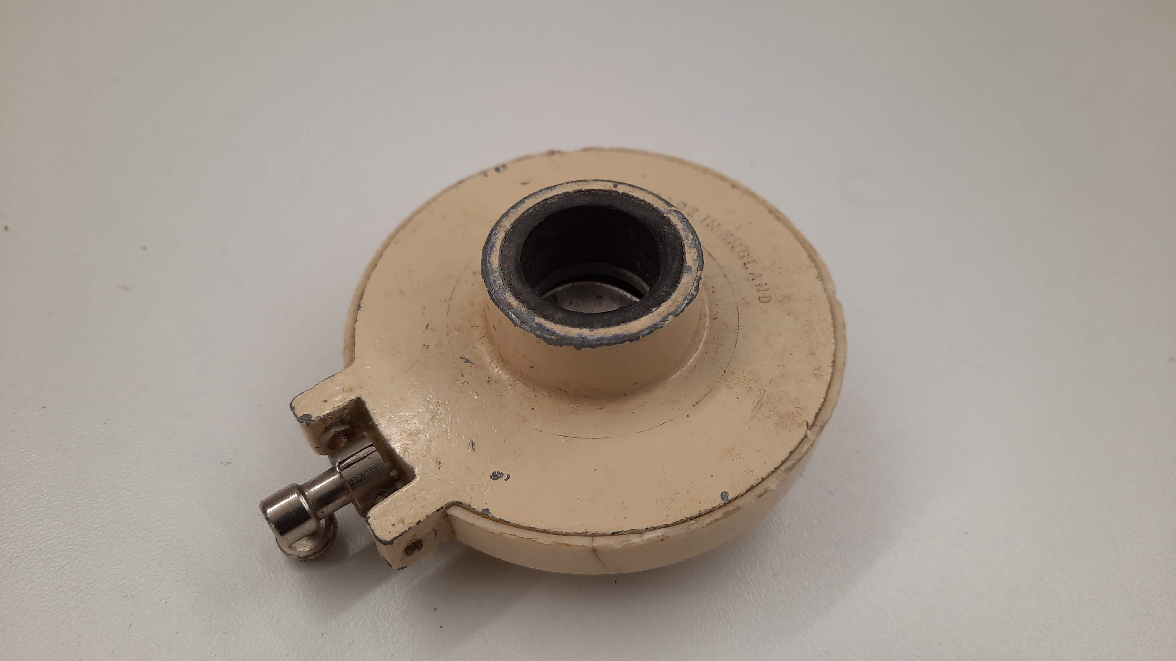

I'm pretty sure this is the same basic soundbox as the one I was 'restoring' in this video:
https://youtu.be/1C4dx5h7TOc
Somebody commented on the video that is made by "Goldring Lightweight No 50 & dates from the early nineteen fifties, they were supplied in display boxes of six ( in three different colours ) to dealers by the wholesalers Lugton & Co Ltd , the trade price being seven shillings +two shillings & fourpence purchase tax . Goldring had been making soundboxes since the nineteen twenties"
I had a look at this website:
https://www.goldring.co.uk/heritage
This shows (in an advert) a picture of 6 of these soundboxes (the one in my video - not the one with figure and birds on) packed in a display box and makes reference to the fact there was 3 different designs (not 3 colours). I have a identical one with a different blue plastic front - and I believe the one which is the subject of this thread (with the figure and birds on) is the 3rd one referenced. In the pictures below there is only one white one - just the front and back of the same one
