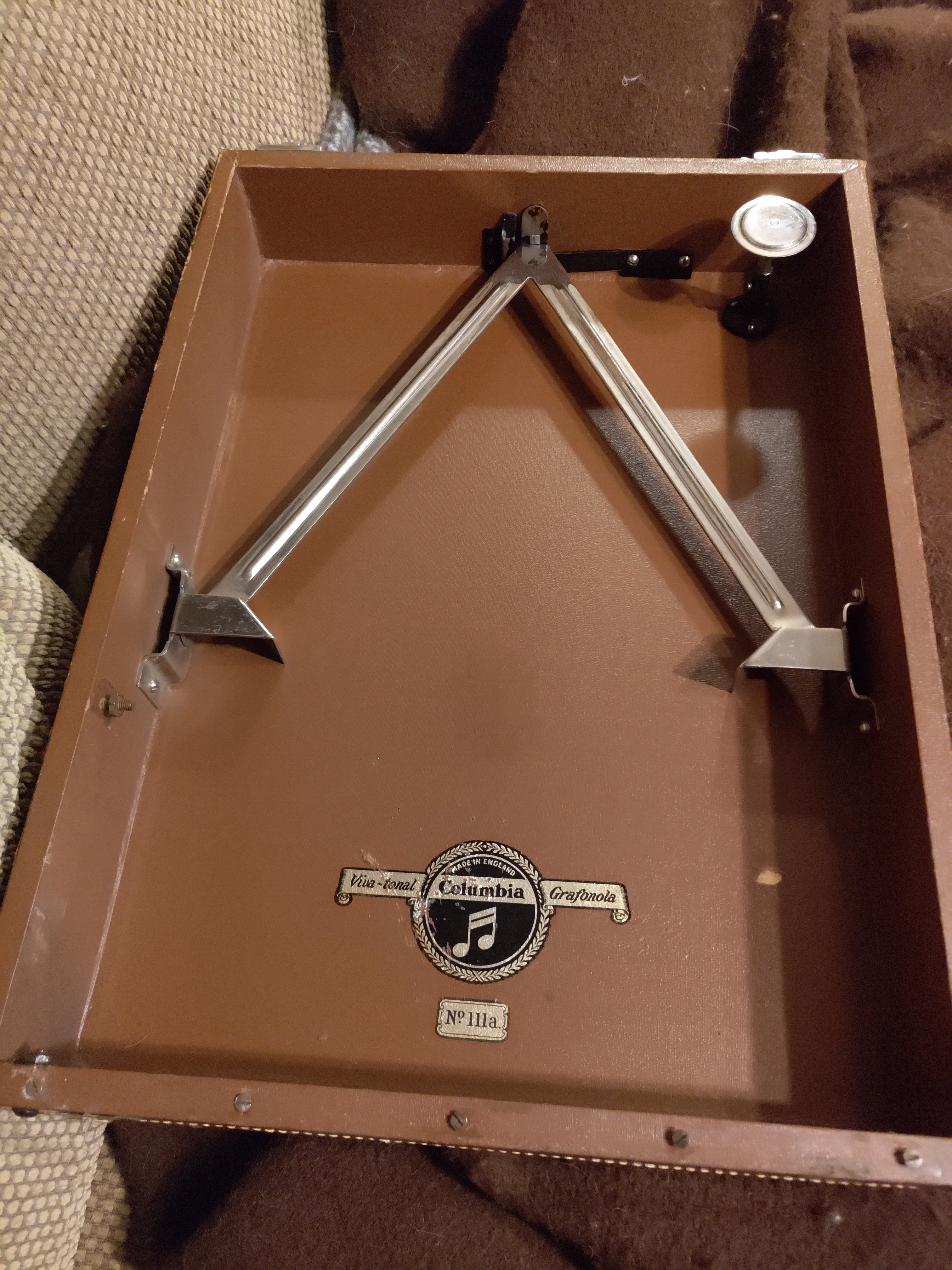

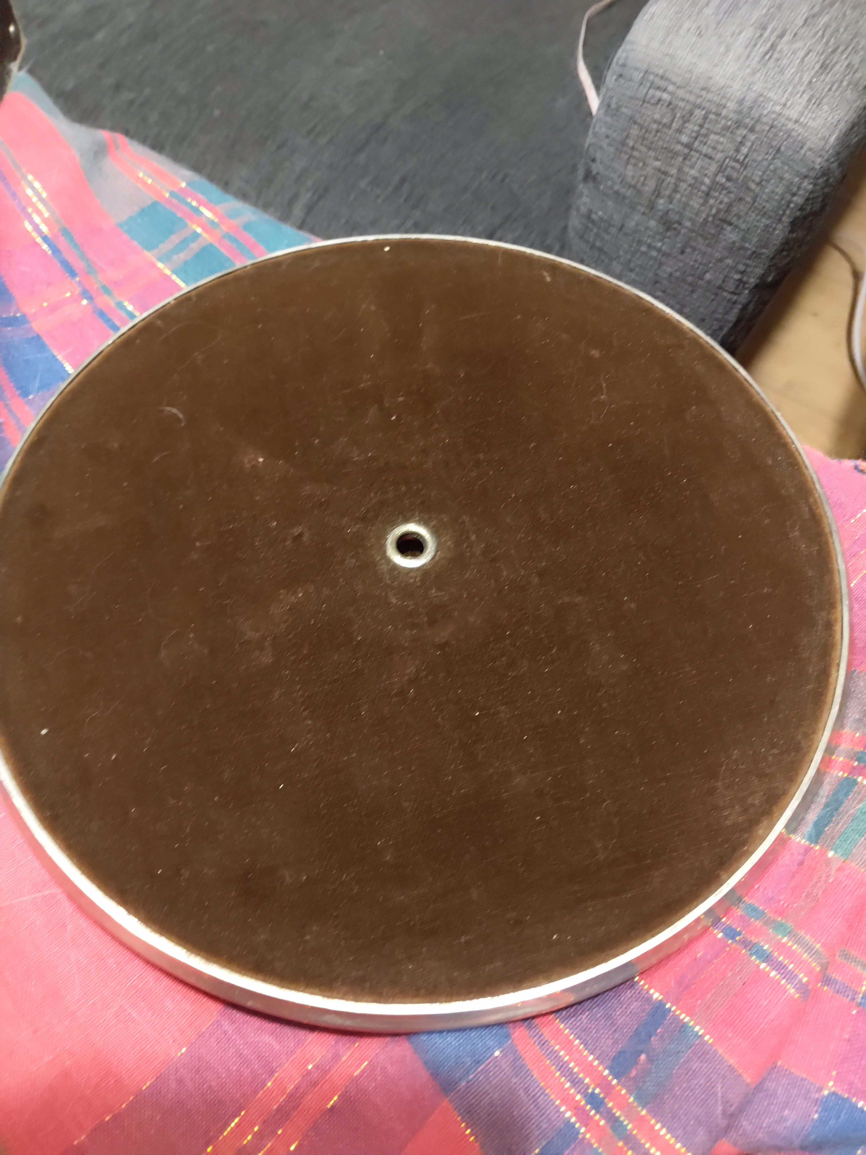

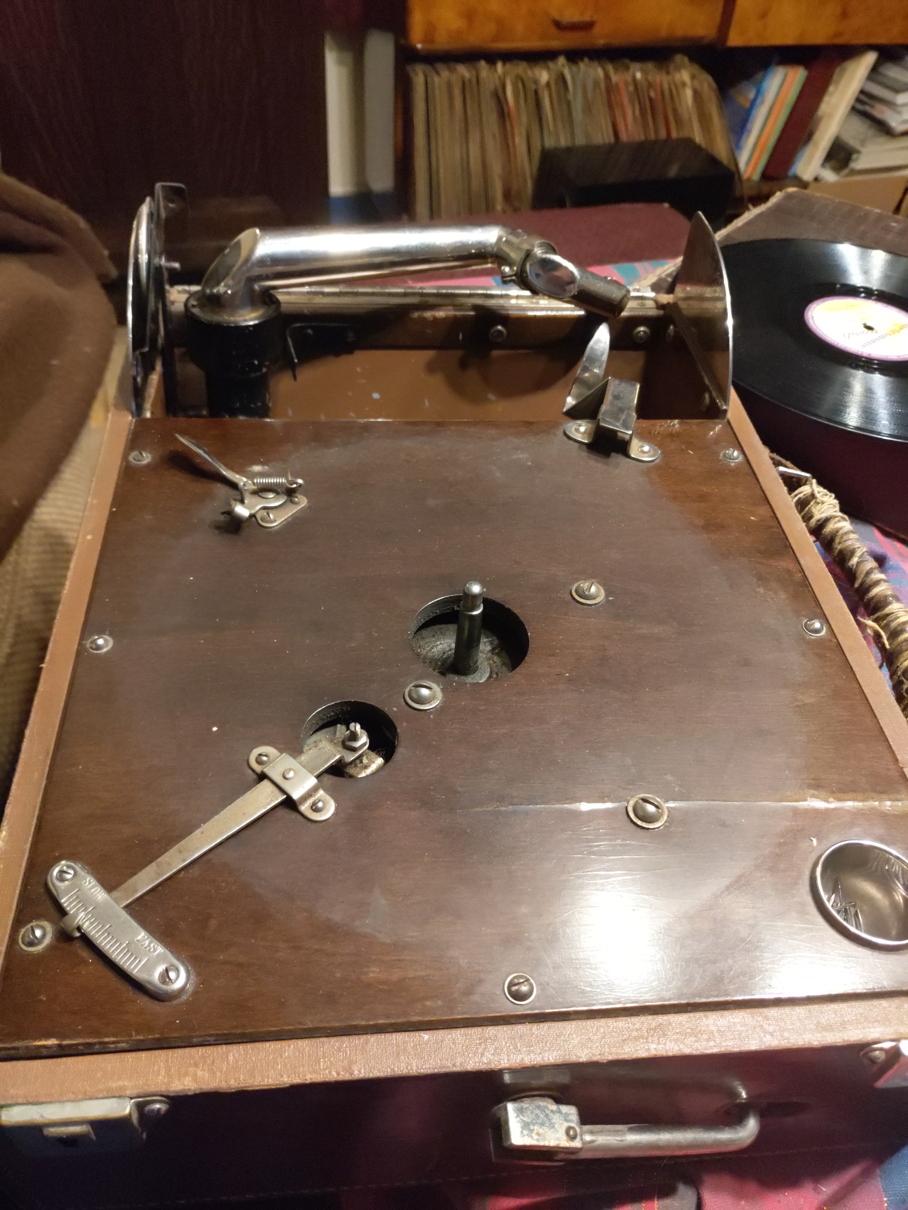

I have promised myself to slow down buying portables, since they all end in a storage locker after getting serviced, due to overcrowded space in my small home from gramophones. But what do you do, when you see a Columbia 111a for sale, and love Columbia portables, and also this portable has been on the wish/hope to find- list for a long time, after reading about this portable here on the forum since I joined the forum now close to 3 years ago.
One week ago, it came up for sale, and when I was offered to have it delivered in my small village !!, it was not possible to resist it of course.
I re open this old thread, since I feel this portable belong and deserve its place here. I also upload some photos, so we can have a closer look at this 1929 Columbia, in brown leather, and with nickel fittings. I understand this portable also was sold with gold plated fittings, but on this portable we have the traditional nickel plated fittings, and I guess this model because of it was named Columbia 111a N.
We can see it has some small issues, but not too bad really. The lid hinge/stay is not working, a metal part has fallen off, and was not found inside the portable. Because of it, there also has been used force to close the lid, which has caused one hinge to break at the back of the portable, and also the long hinge that holds the lid to the body of the machine, has been bent. This last problem is easily fixed, really, but one of the main hinges on the back of the portable needs to be replaced.
1. I have not yet compared the lid stay with the lid stay on a Columbia 9000, if they are exact the same. Unfortunately my two Columbia 9000s are in my storage locker. I also yet can't tell if the broken back hinge are similar to hinges found on other Columbia portables from the same period, I will need to check on that. Maybe I have a replacement hinge on a scruffy Columbia, or not. I would at best avoid to sacrifice a 9000 for restoring this 111a, but if there are no other options....
2. Can someone tell how I remove the winding handle on this front wind Columbia ( Garrard motor)? I don't want to experiment with this portable, ending up breaking something. I have never serviced a front wind Columbia before, and want the motor/board removed safely..
I will upload some more photos of the motor, when I have been able to remove the motor board...

The winding handle is removed by turning it anti-clockwise. It may need a bit of a "thump" to shift it as it's probably never been removed since it left the factory!

Nice machine and well found. The 111a(NP) is a de luxe version of the 112a, so the lid stay and hinge fittings are identical.
The leather case covering is thicker and more robust than the paper thin stuff used on red leather HMV portables.
I notice that the winding handle escutcheon appears to be missing. Again identical to the 112a etc.
