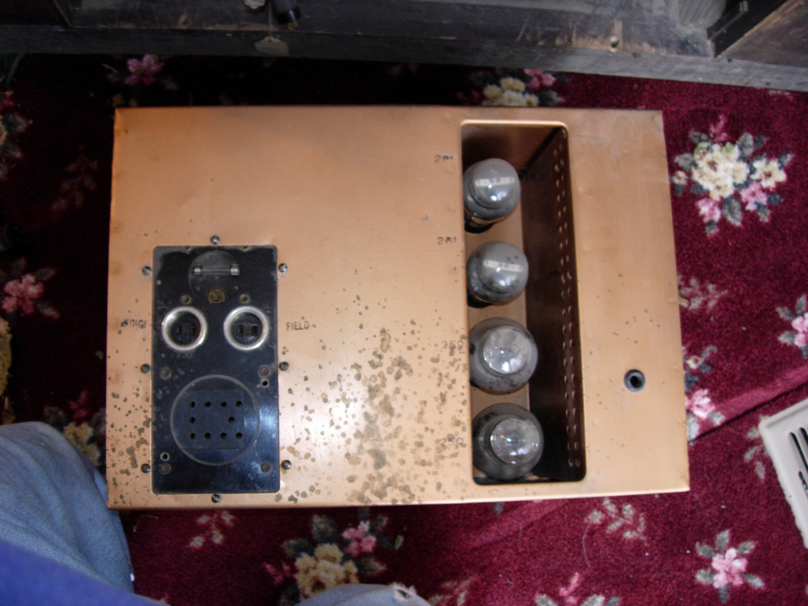

The c-2 uses 2 loudspeakers- mounted one above the other, mounted on the same board- located midway down in the lower half of the cabinet. 2 cleats mounted on the cabinet walls. The receiver has the same control layout on both receivers. A major difference, besides the 2 speakers. is that the C-1 has a much bigger power amplifier and power supply that sits on the floor of the cabinet. You will have at least one correct of the 2 speakers that the C-1 uses . The Peerless speakers use a single turn voice coil. Very unusual design.
The c-1 has a square frame that holds a copper screen that was meant to prevent touching the power supply. And a wood framework with holes and cutouts that was meant to cover the back of radio and phonograph spaces. The c-2 used a screened frame to provide ventilation for the power tubes located on that chassis.
I only mention the speaker, power supplies and amplifier so you'll know the differences. Not that it won't work.
The phonograph uses the same layout, But I don't think the mounting board is the same size.
The radio chassis is the same size - but has fewer components on it by way of the design of the floor mounted amplifier/ power supply.
