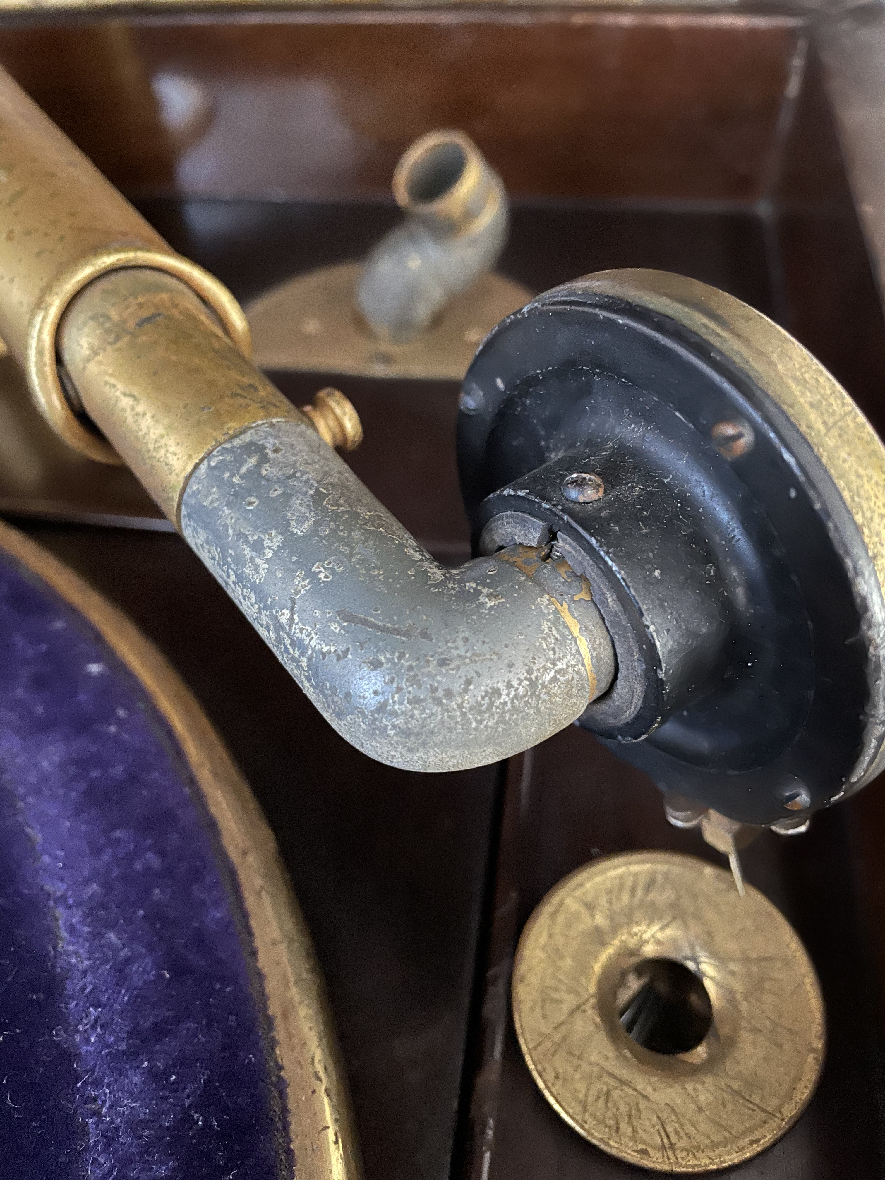

It otherwise seems to run pretty well, though I'm probably not a particularly good judge :lol: I do think the reproducer should be repaired or replaced though if that seems feasible - the rubber inside is definitely all dried out. I'm also not sure that the arm is sitting entirely correctly, as when it comes down off the player it hits the base or the side of the used needle cup, rather than floating above it, if that makes sense?

Welcome, and congratulations on quite a nice machine! You shouldn't need to replace the reproducer, just the rubber gaskets. Rebuilding reproducers is a routine maintenance item for "new-old" machines, and any number of folks here on the forum can do it at modest cost, or you can learn how to do it yourself. Just be careful if it's made of pot metal. You also should have the motor cleaned and lubricated; even if it runs OK, chances are it's gunked up with old grease and dirt that will cause needless wear to the gears and whatnot.
About that "hitting the needle cup" problem: The machine already has three needle cups grouped back at the rear of the motorboard (the one with a cover being for used needles), and having a fourth of different size stuck out far away from them would be odd. I don't know for certain, but I'd suspect the one by the reproducer isn't actually a needle cup but rather once housed a little pad of some sort, now long gone, to serve as a needle rest. Others more familiar with Silvertone machines can verify or correct that.

Post by alang »
That needle cup where the to tonearm is located is actually the used needle cup and should have the lid on top. I have a Grafonola that has the exact same needle cup arrangement. I believe the sound box may need to be turned a bit on the to tonearm so the needle sits in the proper 60 degree angle to the record. It looks like then it might hit that used needle cup better

alang wrote: Sat May 08, 2021 4:56 pm That needle cup where the to tonearm is located is actually the used needle cup and should have the lid on top. I have a Grafonola that has the exact same needle cup arrangement. I believe the sound box may need to be turned a bit on the to tonearm so the needle sits in the proper 60 degree angle to the record. It looks like then it might hit that used needle cup better
Andreas
So I guess the idea is that the user loosens the thumb screw and the used needle drops straight into the waste cup. That makes a good bit of sense. Thanks--I learned something today!
