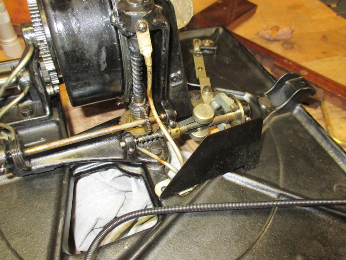

The oil would not flow from the cup under the turntable on my Sheraton S-19 Phonograph. With the motor plate upside-down I plan to clean them, but, before I start the location of some seems to be wrong in that the felt doesn't touch a rotating part.
Is there a method to clean them out and is there a good picture of how they should be positioned ? I have attached a picture before I have done anything to them.
Marc

The felt doesn't need to touch. Just needs to be near enough to let a drop of oil fall on the bearing. Before you clean the tubes out, do you have replacement felt to put back in the ends?

No, I have no replacement felt or for that matter even know how the felt is held in the tube.
I have worked on clocks and Edison Cylinder Machines, but this is the first Diamond Disc Phonograph I have taken apart.

I just push a fine wire down each hole to make sure there's nothing solid obstructing the tube, but I don't push it hard enough to push the felt wick from the tube. As far as I know the wick is not glued or clamped to the tube but is just compacted enough to hold itself in place.
It really shouldn't matter much about dust in the tubes because the oil would seep through most dust anyway.
I do use the wire to expel air from each line though, and once each tube seems to be full of oil, I fill the cup and leave it, and probably only refill the cup again every 2-3 months.
You'll probably find it actually just air stopping the oil from disappearing straight away and they're not really clogged or need cleaning out.
