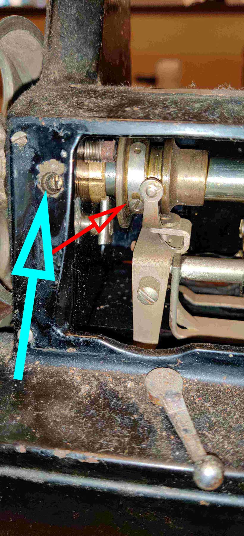

Hello dear friends. I am in dire need of your help. I recently acquired a dictaphone model 12 type B. for some reason that I do not remember at the moment, I unscrewed the screws on the mandrel which keep the spring-loaded cylinder holders in place. now I need to take out the mandrel in order to put them back in place and put the screws back. but the problem I am facing is that I can not figure out how to take the mandrel out???
any help would be appreciated. thank you in advance

I don't know if the picture below will be of any help, but I thought perhaps it might give you a better idea of where the mandrel shaft should be attached.
The end of the shaft is threaded so there must have been some sort of nut or something screwed onto it there.
Then there's a slot that goes all the way through the shaft, and about 5mm past this slot is a small hole drilled into the shaft, but it's only about 2-3 mm deep, and it doesn't appear to be threaded, so I guess it was used to anker whatever collar or pulley is attached there. It was just way too long ago for me to remember now

The above picture is really helpful and confirms what I thought - the mandrel is held in by a nut on the far left end. I am making a tool (best I can!) which comprises a flat bar with 2 x 2mm (1/16) screws in it to unwind the nut. The problem will be that the nut has been in there for a century-plus! I will lock the mandrel using a leather belt and apply some heat to the nut end and hope!
I didn't want to take it apart that far - I am slowly cleaning each bit ready for oiling and refitting, so at least if I can extract it I will be able to clean in the mandrel housing.

The flywheel two pin end nut will not come undone until you release it by unscrewing the screw pointed out by green arrow.
The red arrow screw holds a pin that also needs to be removed.
Be careful when releasing the mandrel as there is a metal post slotted in the slot in the mandrel inner bar.
I took loads of pictures when dismantling and without them I'd have been lost.
