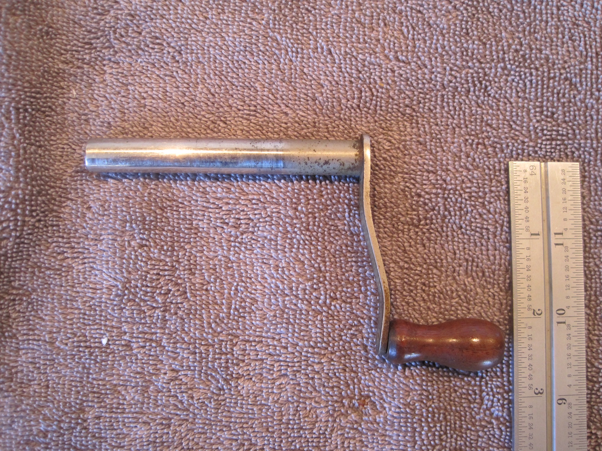

Kevin Clark
Posts: 157
Re: Zonophone phonograph
Post by Kevin Clark »
Photos provided show what style crank you need. The motor winding shaft engagement pin is located .500 in from the end of the crank. Inside diameter of the crank shaft tube is .330 and the outside diameter of the shaft is .437. I do have a spare motor out of a late Victorized Zonophone Parlor machine. It is the same motor as yours only a single spring. Spring is broken or disingaged from the winding shaft but is complete. If interested I will have to dig it out and take a look at it but I remember the motor being in good condition except for the spring. Price is 100.00 plus shipping. I do not have a spare crank.

Hi everyone,
Can someone please confirm which crank I need to complete this machine? Is it the one pictured in Kevin's post?
Thanks,
David
Posts: 6456
dzavracky wrote: Wed Dec 15, 2021 11:27 pm Hi everyone,
Thanks,
David
David,
Yes, Kevin's crank is the style you need. It won't be easy...
