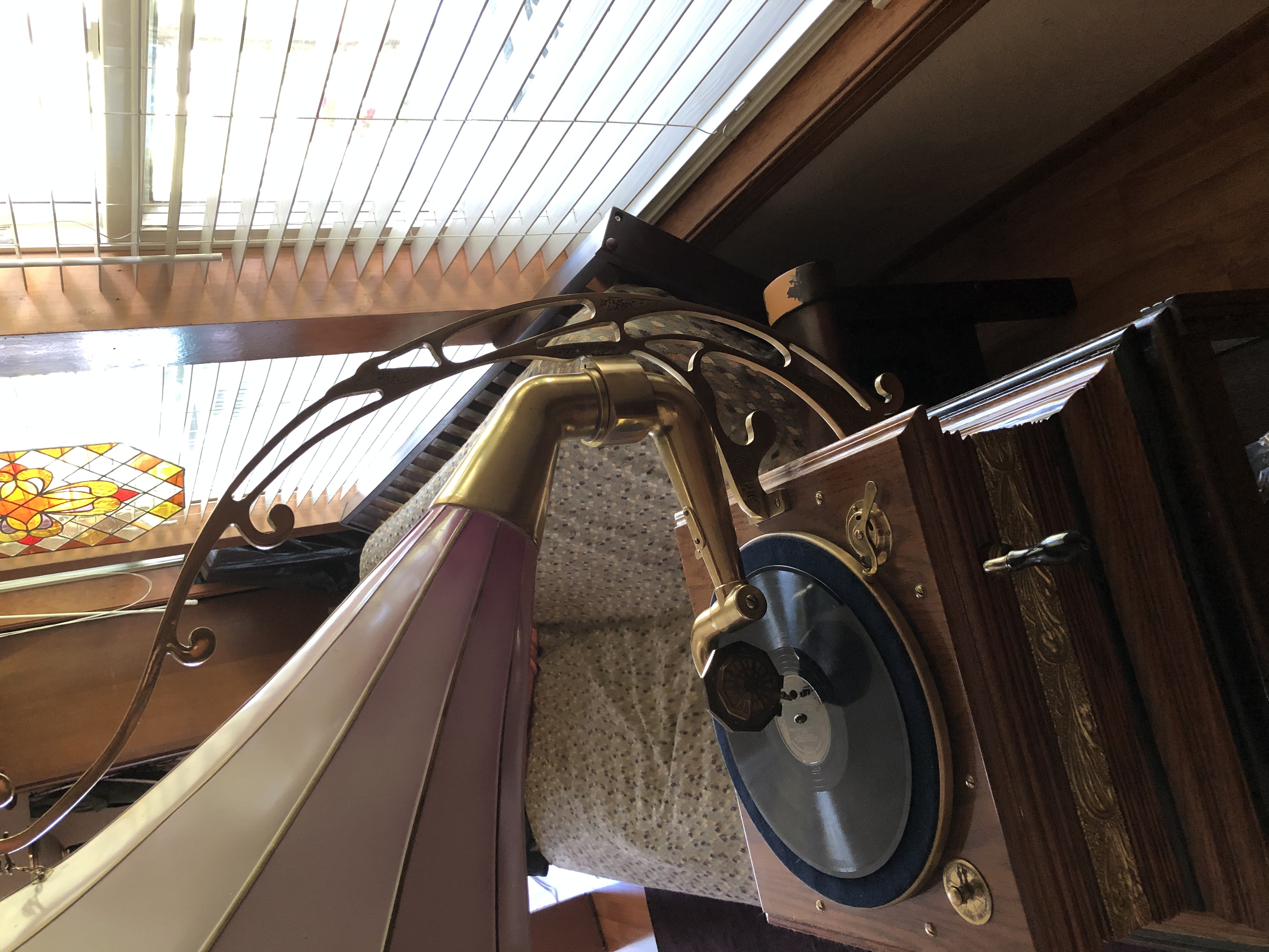

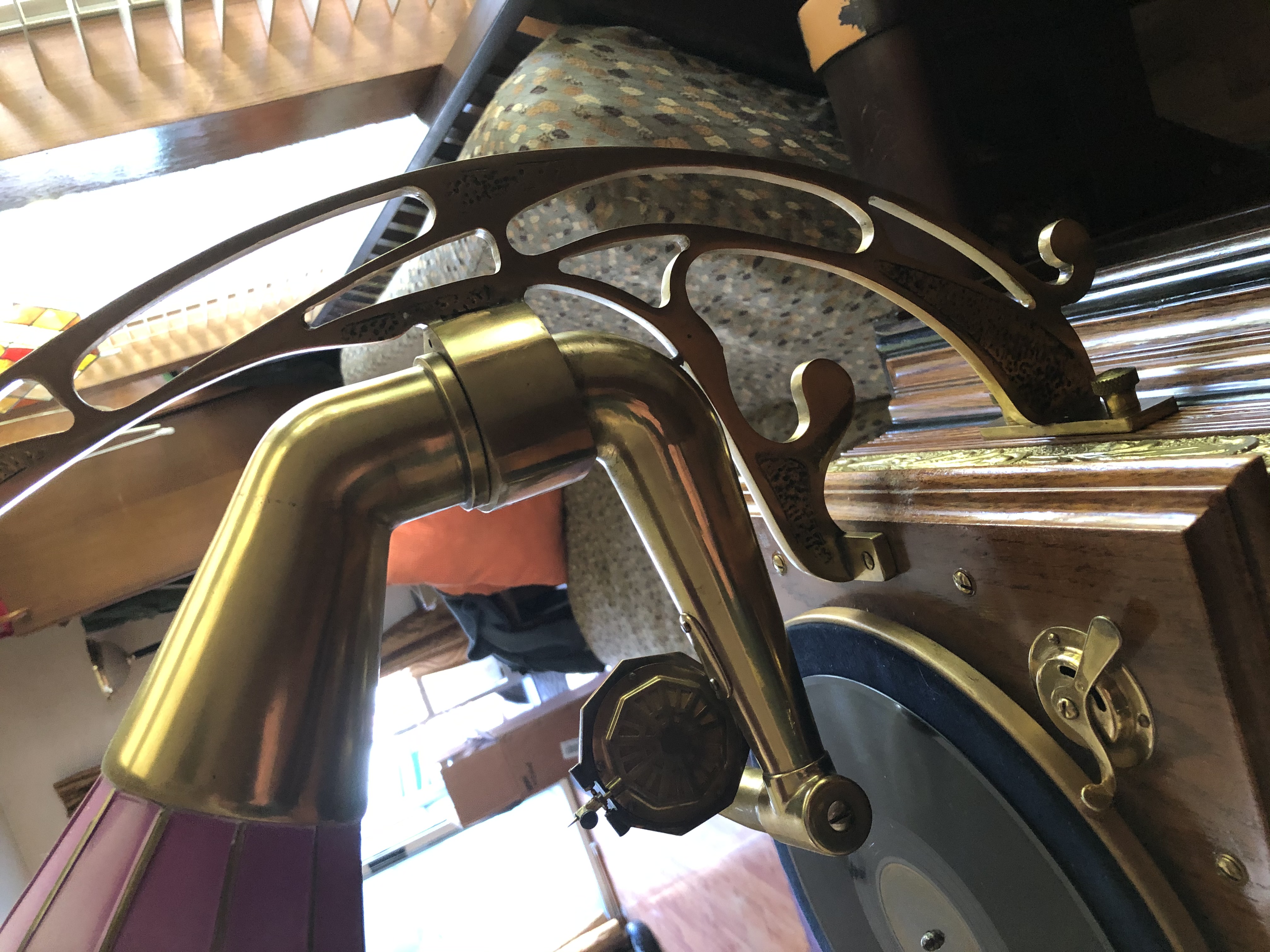

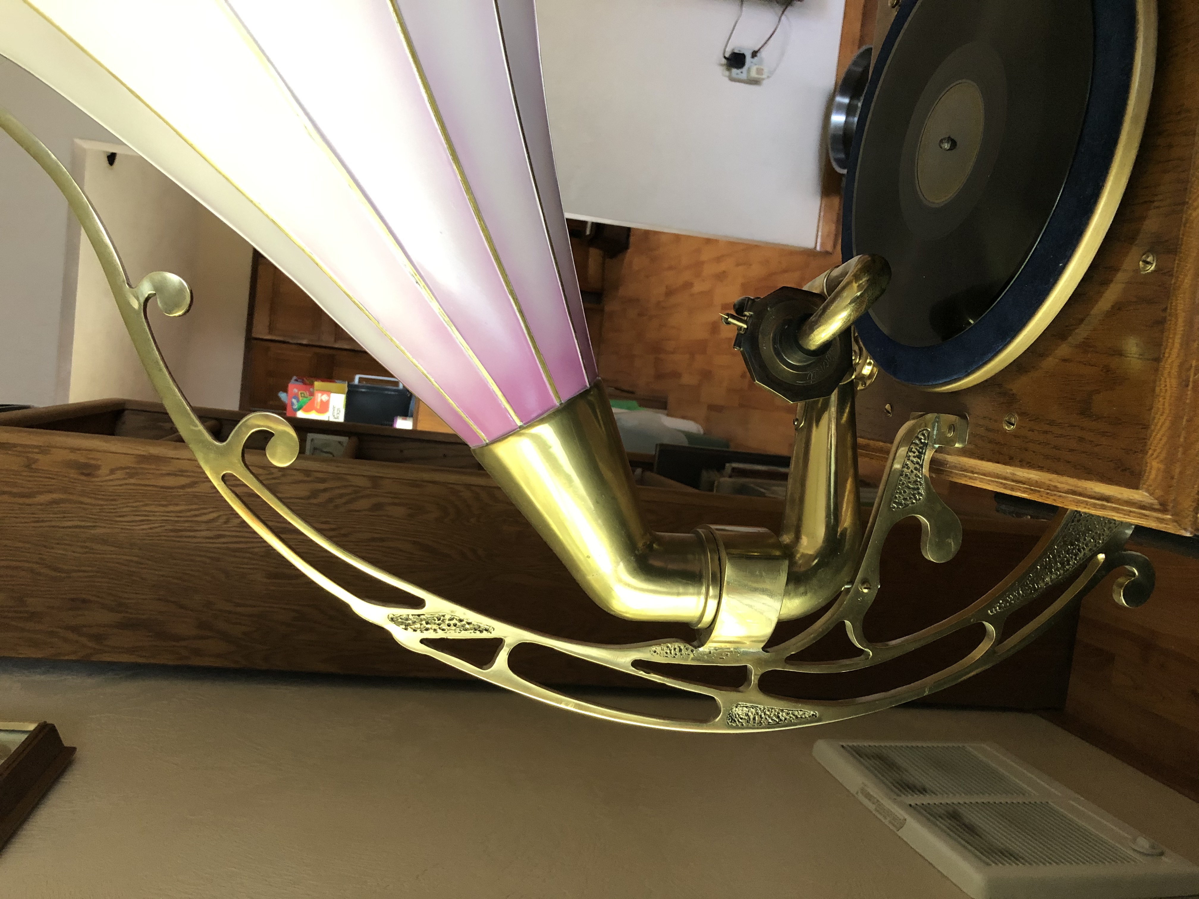

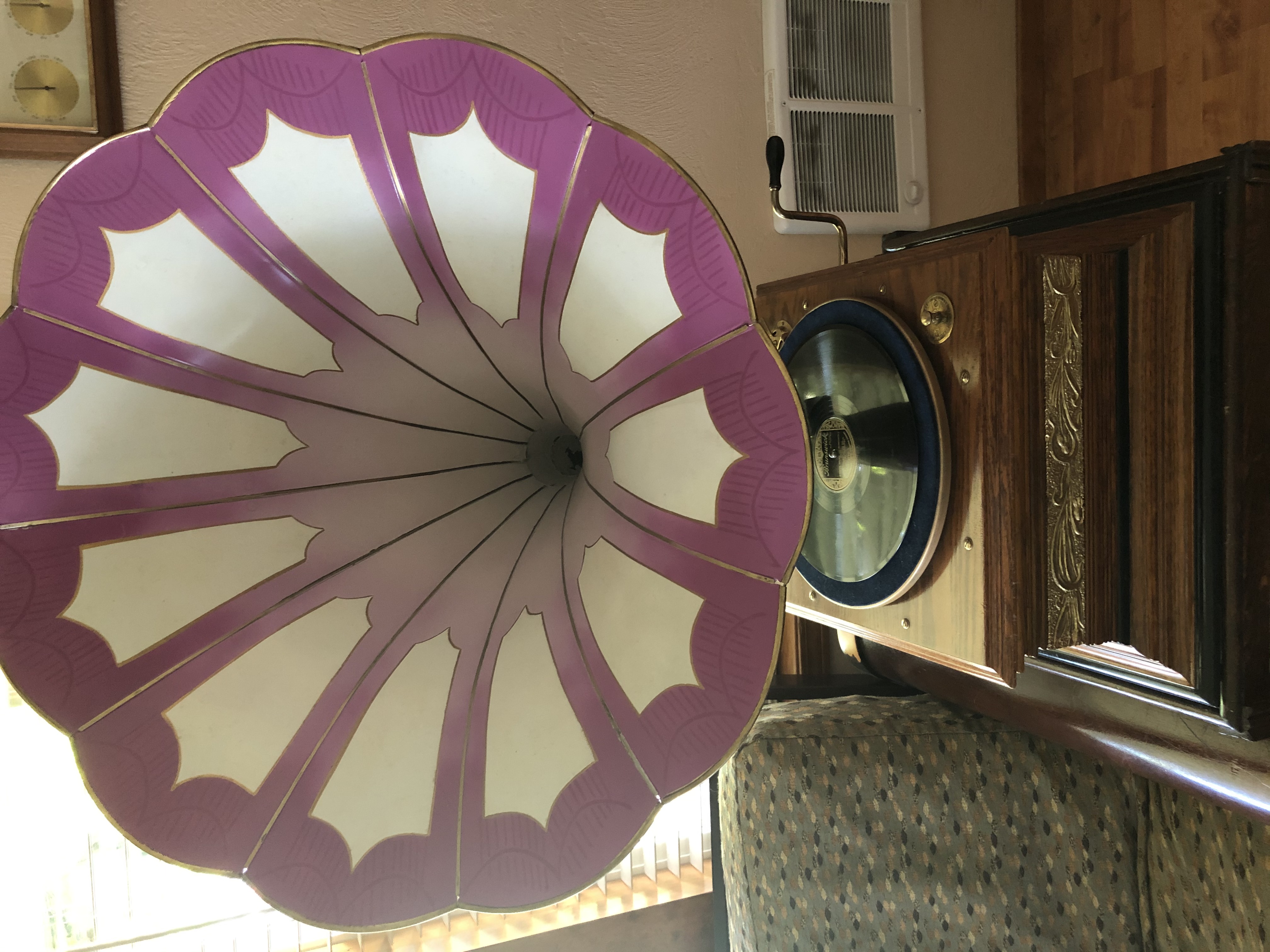

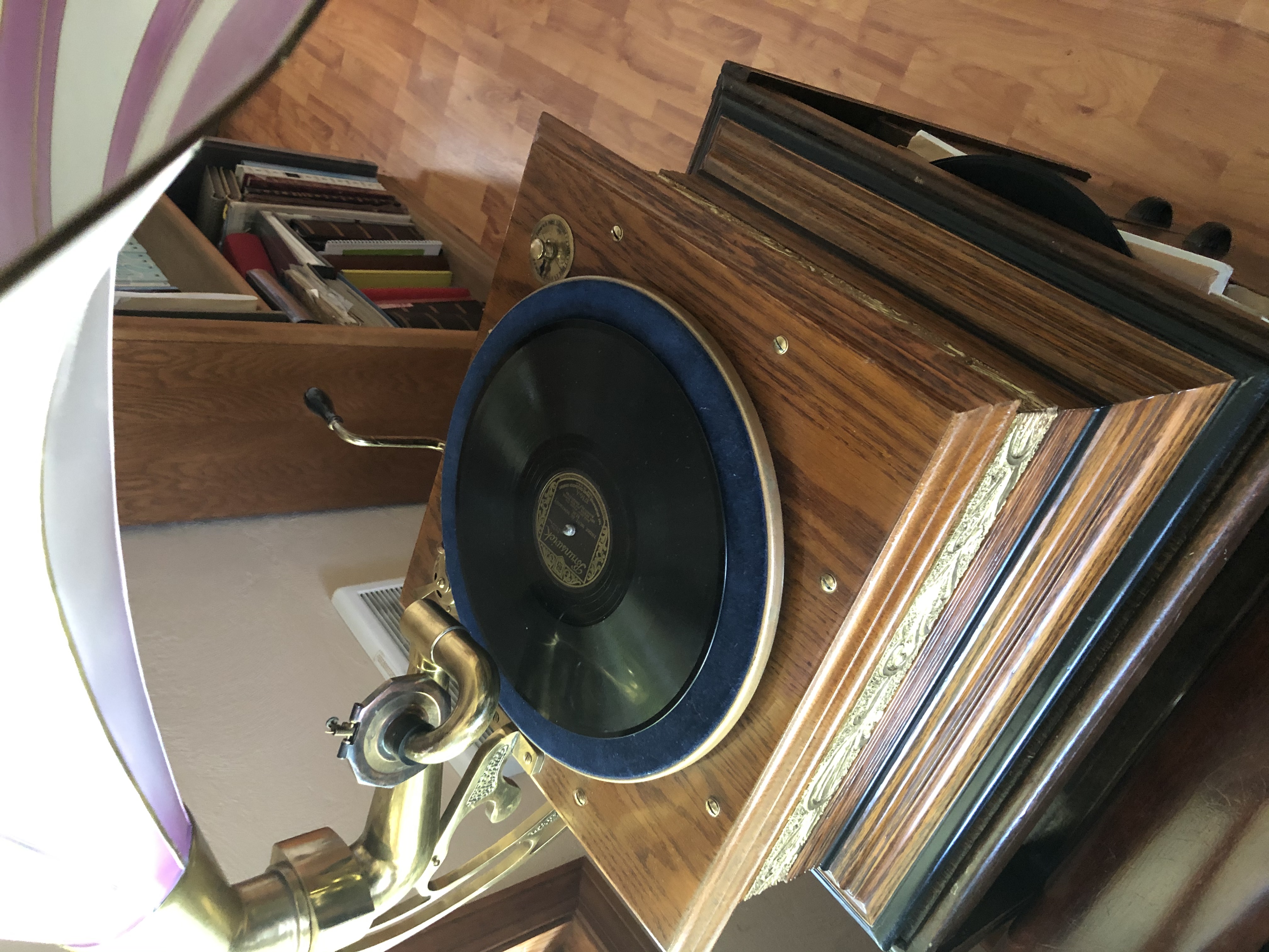

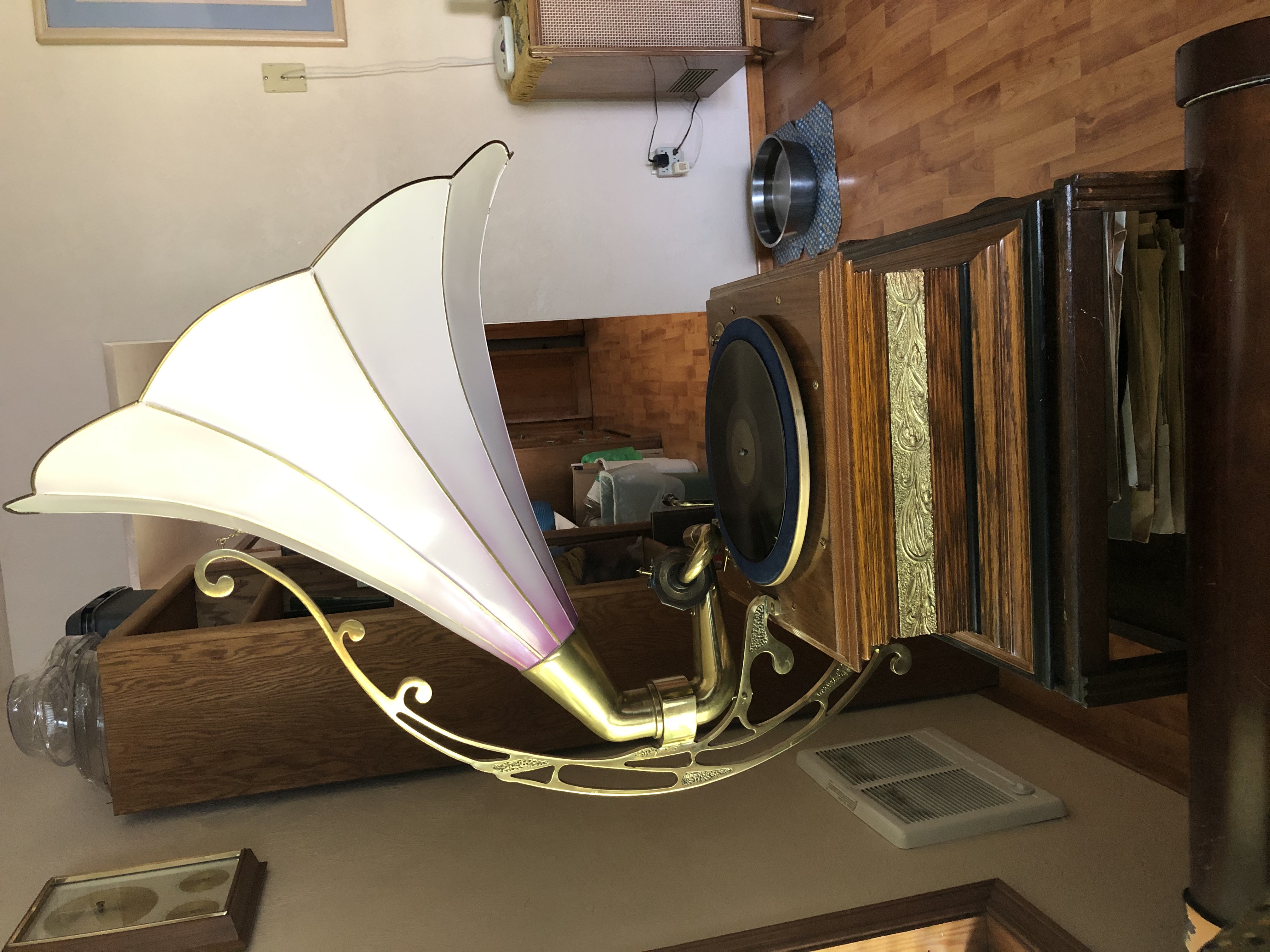

Finally- here's the machine in question. There's a lengthy backstory as to why I HAD to have this machine that I don't have time to type out right now. You can see the HMV/ Victor influence here, and as I stated previously, the machine has a huge 4 spring motor identical to the HMV 32 machine and higher- end Victrolas.
It is massively overbuilt and heavy. The motor runs whisper- quiet, and the sound is incredibly good, even compared to a Viva Tonal or Orthophonic machine. the Goldring Aristocrat really works well aurally with this machine. The horn opening is a very good size... 58,4 cm or just over 23". There are no re-drills or anything amiss on the cabinet to indicate any remotoring. I am wondering if these were hand built machines, as the only two others I have ever seen are the one in the Marty book (which sold at auction recently) and the one in my grandparents' attic when I was a wee lad that got me started on windup machines.
