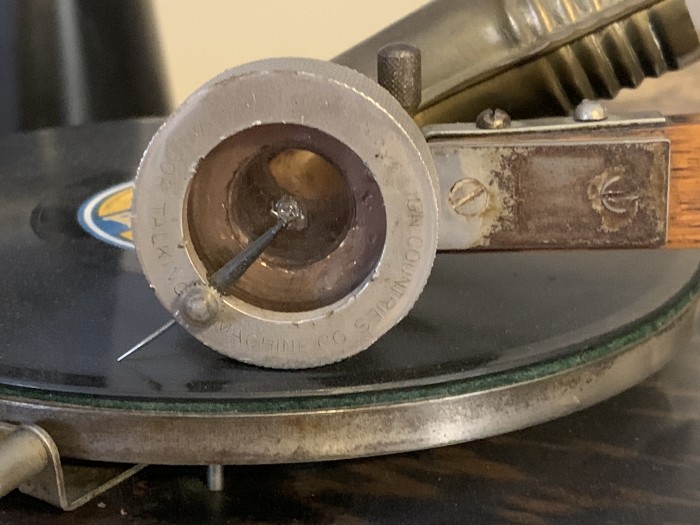

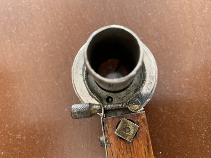

I have a problem with my Vic R reproducer that I need help with. The reproducer hits the record before the needle does. I found a needle that is much longer than most but even that doesn’t work. If this was an Exhibition reproducer I would just simply rotate it a bit but this reproducer has a locking alignment pin on the back. What is the solution?

From the looks of the tool marks on the front and the glob of "glue" on the needle bar, I'd guess it was taken apart and put back together with the front and back sections misaligned.

I agree with Chuck... someone probably took this apart to possibly rebuild it, without realizing that it has to be put back together exactly as taken apart. That means before taking it apart you need to mark alignment references - like a line across both parts to be able to put it back exactly in the same position that both halves were in originally... Failure to do so, results in the needle bar being at the wrong angle for the needle to properly contact the record.
The only way to correct this misalignment is to take it apart again (not easy, since it is press fitted and requires breaking the mica to separate the halves) and re-assemble it in the correct orientation. I have done one and would not care to do another, so if you are unfamiliar with Concert reproducers, I would suggest sending it to someone who is and have them correct the problem.
