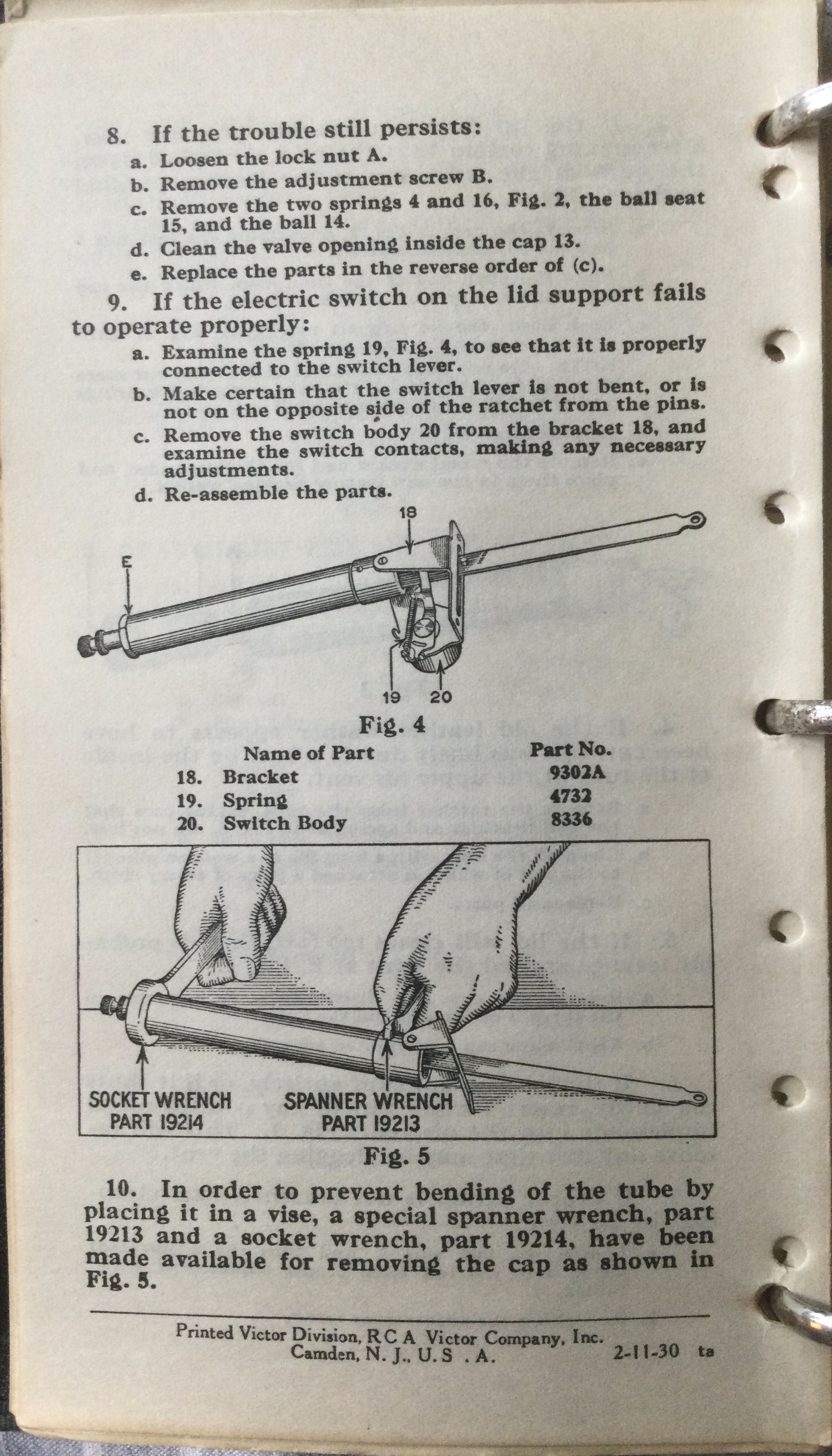

Victor Service Bulletin No.10 Air Lid Support

Victor was a large organization with substantial dealer support. Here is one of the service bulletins supplied to the dealer service department that today’s collector may find useful.
