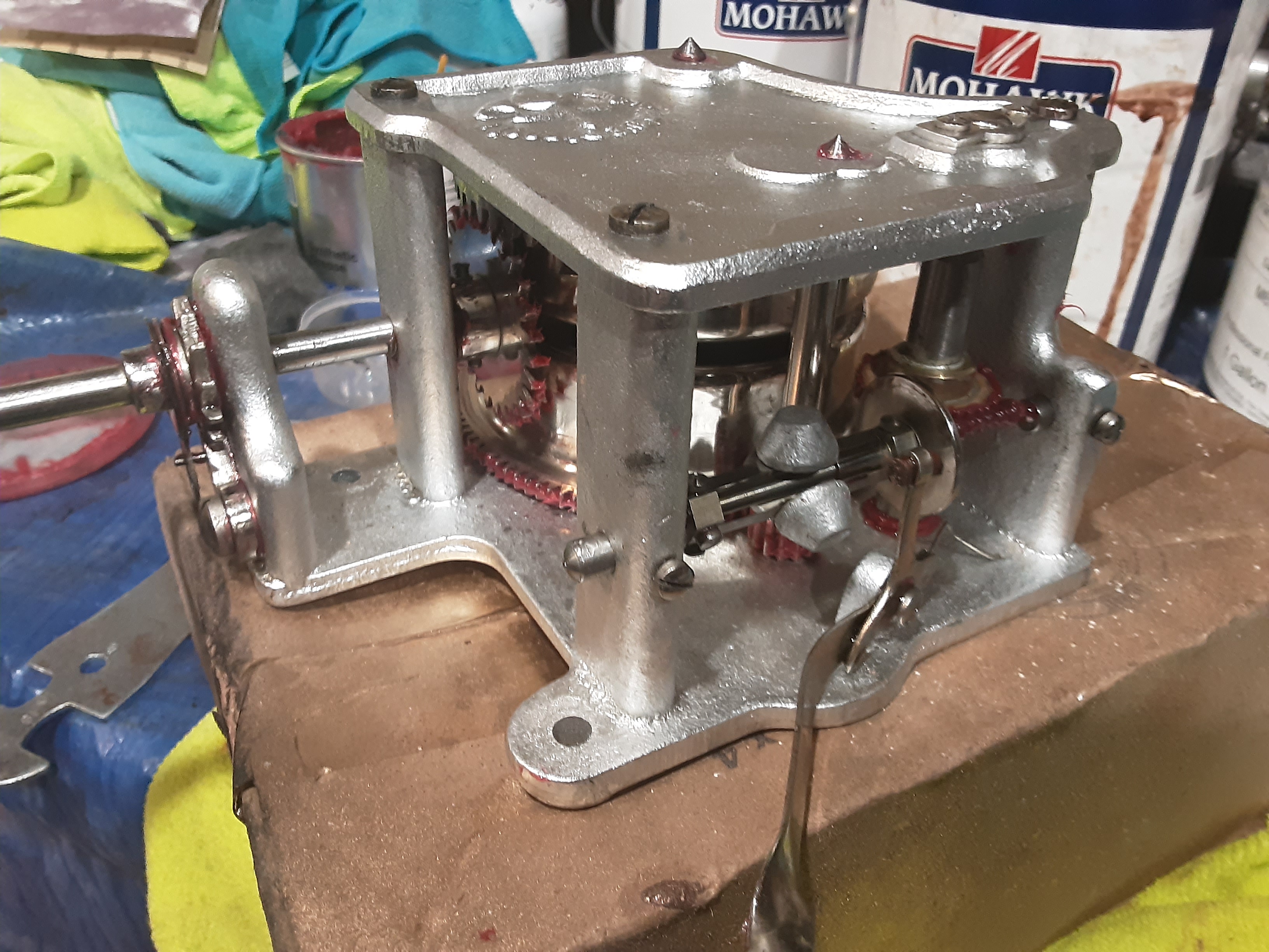

Here is my latest restoration, a Sonora Baby Grand that I brought back from the brink. This one was stored for a long time in a damp basement and had veneer damage, corrosion and other problems including a broken spring. It turned out pretty good. I had to cut the felt myself since I couldn't find that color already cut to size. Also had to modify a key on my grinder from another key I bought that was similar in size & shape to a picture I saw of a Baby Grand key. The rest of was pretty straight forward tear down, restore and re-assemble. Tested it tonight, it sounds clear as a bell :lol:
Here are some before and after shots
Here is stripped and sanded
Here are some shots with a flash:
Here are some without flash:
Here is the motor before and after:

WOW! Yes, I'd read your experience with the rebuild of the springs. not an enviable job, but just look how this turned out eh? Your repair on the grille - well, I can't see the repair anymore.

I chemical strip the carvings several times and brush with a light brass bristle brush to get finish out. The flat parts get 120 then 220 sanding. The finish is sprayed on with 400 grit sanding between coats. There is more to it including vinyl sanding sealer, color matched mohawk ngr dye, mohawk grain filler, mohawk finishers choice lacquer, mohawk buffcote lacquer for top coat.
