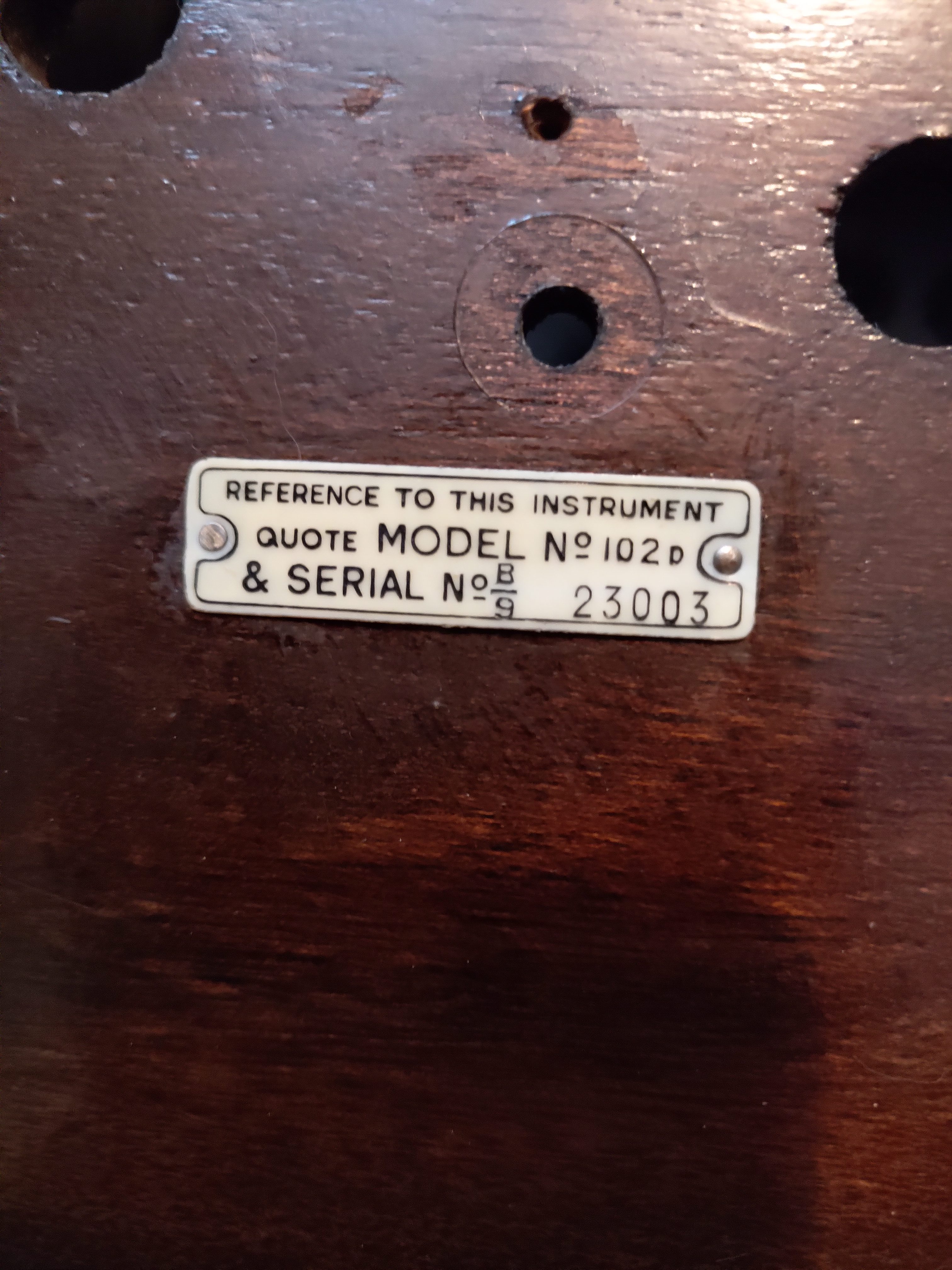

I bought a black HMV 102 last week, since the motor board and case looked so good. When watching the seller's photos, I paid attention to the fact that the carrying handle was not Pakawa, or at least not the normal fittings that goes with the Pakawa carrying handle. Since the machine looked so good, my immediate thought was that someone at some stage had changed the carrying handle, since we know the Pakawa handle often break, or rust, or both.
However, when today screwing out the bolts holding the carrying handle, I witnessed there were no traces from what we know as the original slots and fittings for a Pakawa handle, and this machine actually seem to have been released from Hayes with this carrying handle! I have myself never seen a similar handle and fittings on a 102, but maybe someone else has, if so,,it could be interesing to know it. I actually had to release the nut holding the bolt belonging to the handle close to the winder area to be able to release the motor board from the case, without releasing the nut and pulling this bolt the motor board would not release, since the bolt prevented the horn to be released.

The handle you have is a wartime replacement for the Pakawa version. Dealers were warned that due to a shortage of some components, different ones were to be fitted. It may well have been that the factory that supplied the Pakawa handles suffered war damage, but we shall probably never know the real reason. This handle has been seen on many 102s.

As Barry says, this handle is not uncommon. It is also much easier to remove and replace than the Pakawa.
The "Made in England" plaque on your machine identifies it as an export model.
