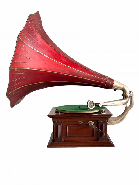

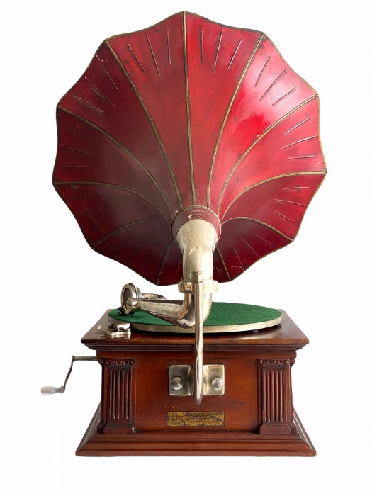

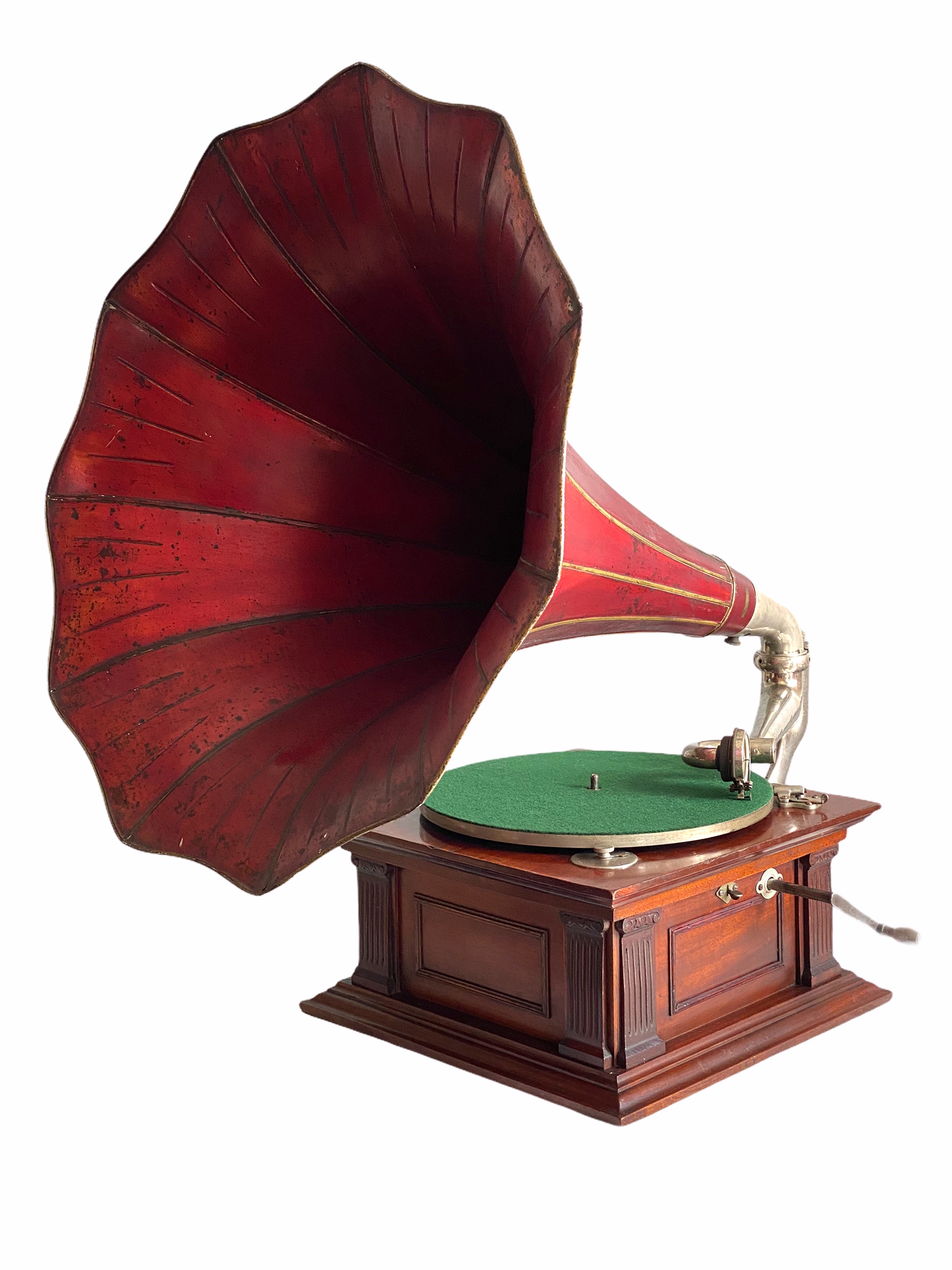

This Monarch Senior was marketed as the "Ionic" given the style of the columns.
This style is arguably up there with what I think is the most aesthetically pleasing of the HMV cases. Attached is a photograph of my own machine.
