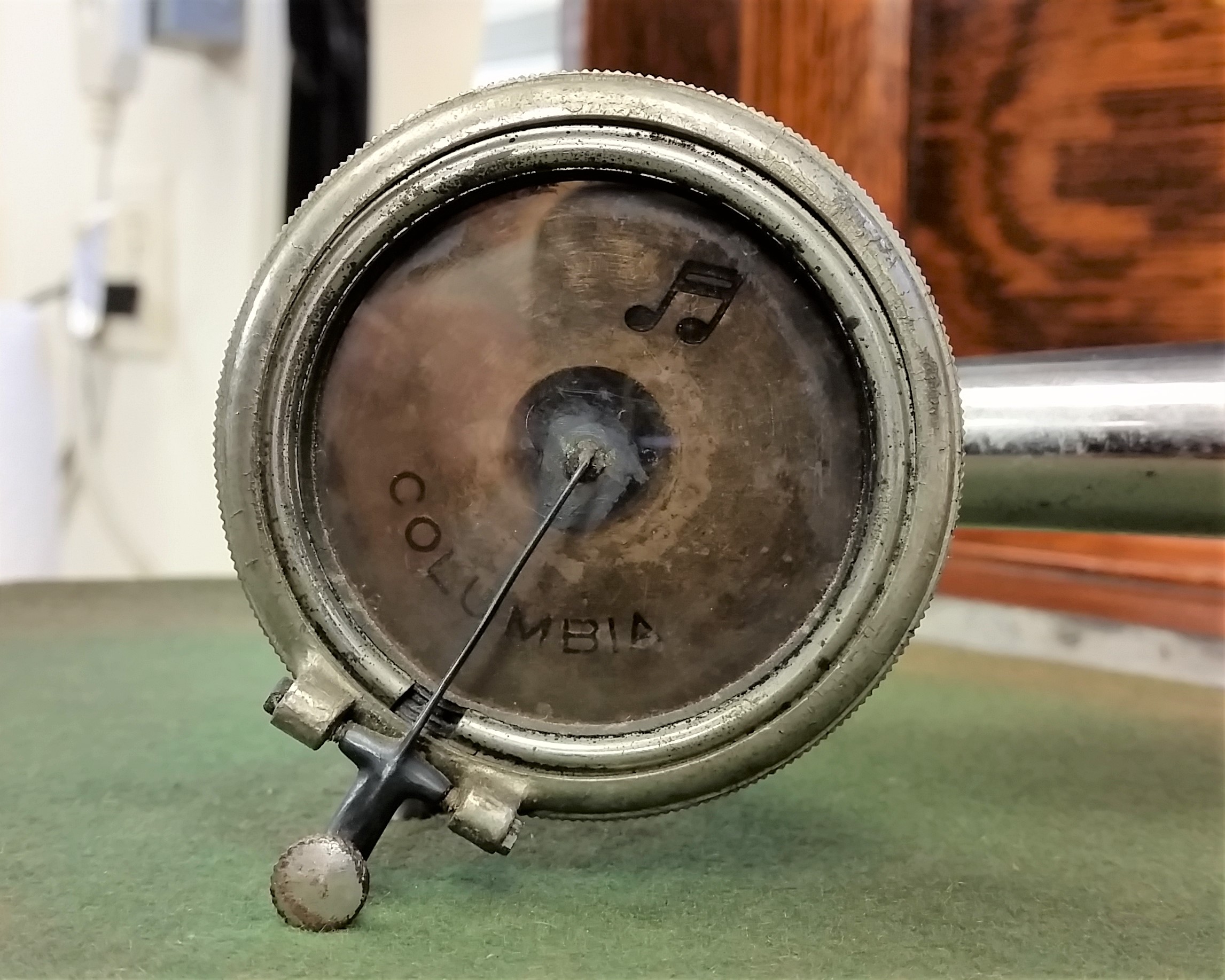

Well I went and did it, got another talking machine to spend hours on. I have been able to hold off for a while. This machine is rough and has had a hard life. It appears to be a Columbia Favorite/50. tabletop in oak. I took one look at it and just about walked away. Dusty, dirty and dried up, missing horn louvers, sitting in a shed. But opening the lid made me look further. It is amazing that these machines always look good under the hood. Decal still shining on the tiger oak. The reproducer and tone arm was intact, the mica had no cracks or delamination. I pulled the turntable off and everything looked good. I wound it up and cut off the brake and she started to turn, gravely at first but after a couple minutes started to quite down. She ran for a good 5 minutes, promising that although grimy nothing broke to speak of. I had brought a couple needles and a disk so I put a needle in the reproducer and gave it a finger rub. Hey we got sound. Wound her back up and put on a disk. Dropped the reproducer onto the disk and it literally puffed dust out of the horn but we had music.
So now what? Start a list.

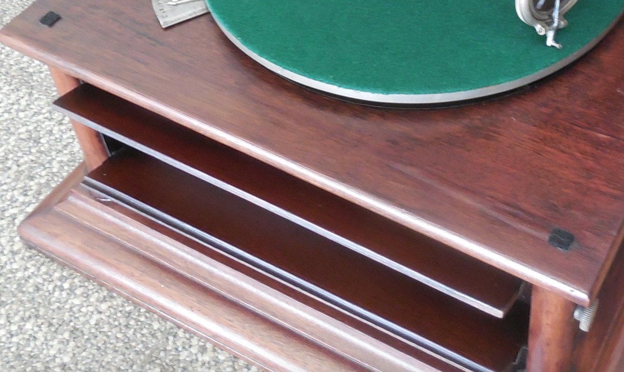

After a lot of searching on the forum I did find this Columbia Favorite in mahogany and I think it is a model match for what I have.

Re: Columbia Grafonola Tabletop Barn Find
That’s a Columbia favorite... interesting that the decal doesn’t say favorite though. Yours is an early model with the speaker doors.
I used to own one awhile ago. Here’s what it looked like.
David
EDIT: I just realized yours has slats not doors.
David
