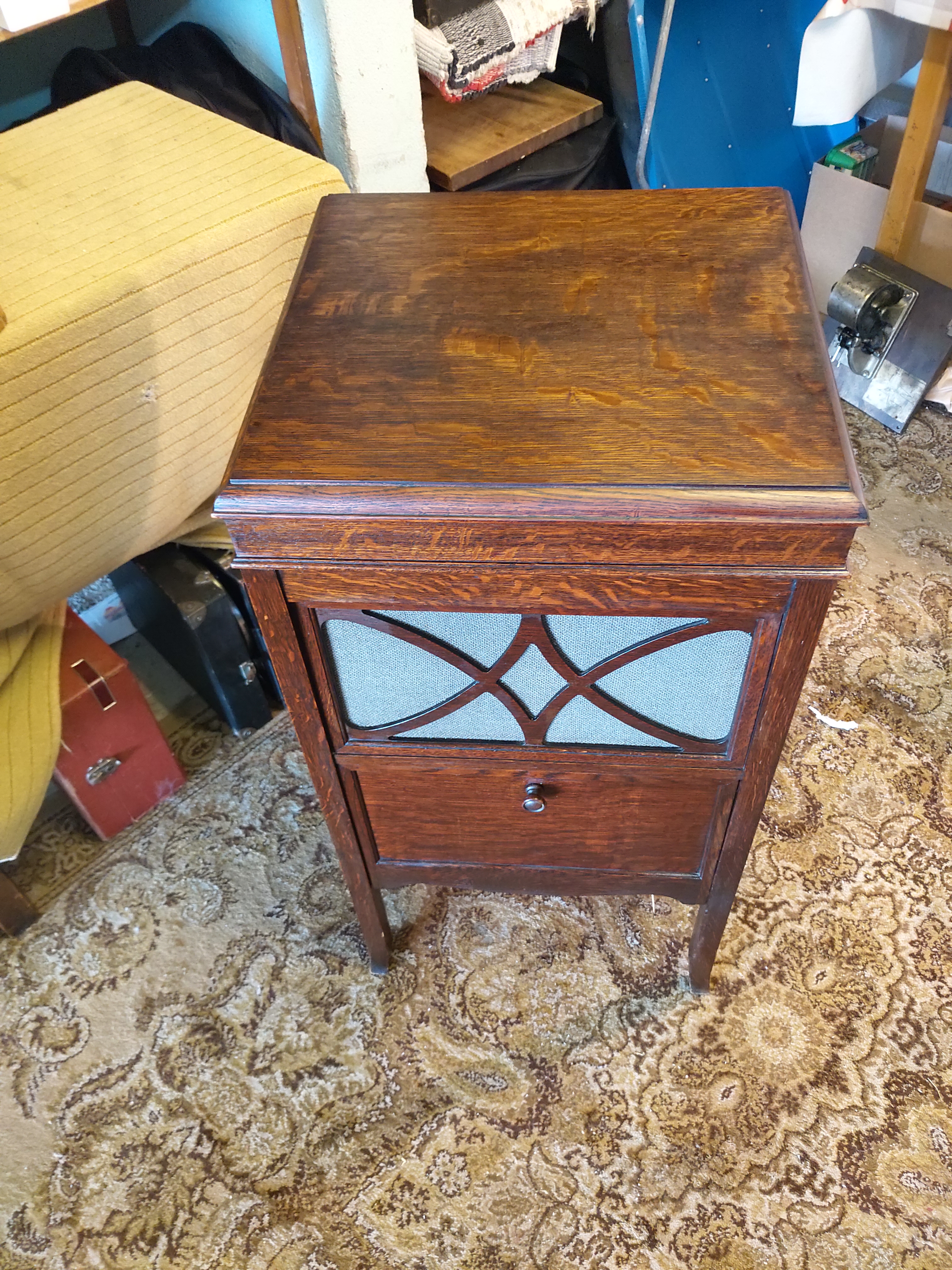

In October last year I purchased an oak HMV model 156, and made an agreement with the seller to pick it op, or have it delivered, in spring this year. One week ago, I took a 400 km drive to collect it, since I anyway was out to collect a horn gramophone in a nearby city. I have not seen another model 156 for sale during the last 2 years since I started collecting seriously, and was quite suprised to see another model 156 put up for sale 2 days only after collecting the 156 bought in October last year. I was a bit hesitant this last time, since my storage locker is over crowded, and (wallet close to empty;)) but the price was a not too scary 120 euro, and since it this time was a mahogany model 156, I decided to take pity on it, and drove another 200 km to get it back home, for restoration this summer. For those interested in seeing the horn on this model 156, I can upload some more photos when I will later this spring service the 32 motors found in these machines. From the photos we can see there is a small variation on the two machines, the lid stay and the two slots ( what are they for?), close to the needle boxes found on one of the machines. So far only the mahogany model has been cleaned with Swarfega, and in addition carefully handled with fine steel wool on the doors before adding Howards Restor a Finish, since the machine had some rather deep scratches on the top lid and also on the doors in front. There are still some visible scars on the top lid, and also a water ring,,,but I don't agree with myself if I should leave it or not at this point, since if I use more steel wool, I will now easily break through the old layer of what I presume is cellulose lacquer? And, I am hesitant to over restore these fine cabinets, really.

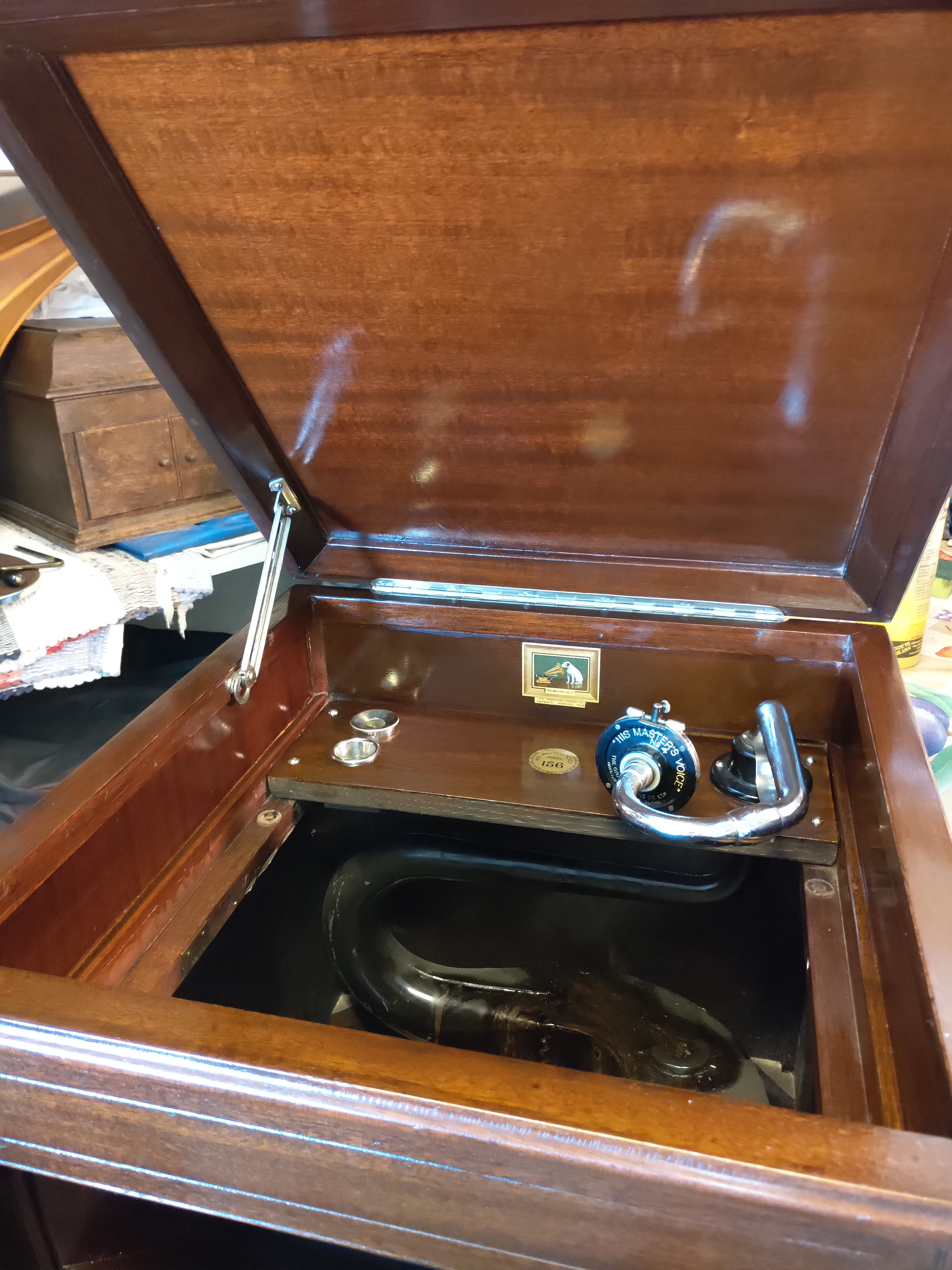

The two slots on the motor board of the oak 156 are for holding tins of Tungstyle needles.
There is also one such slot on each of your grey 101's.

The mahogany 156 is probably the older of the two as it doesn’t have the tungsten needle tin holders.
It is curios that your oak 156 has a straight runner between the legs and not the curved runner that is normally found.

I am about to complete the restoration of the two HMV 156 machines, but would like some opinions/advice.

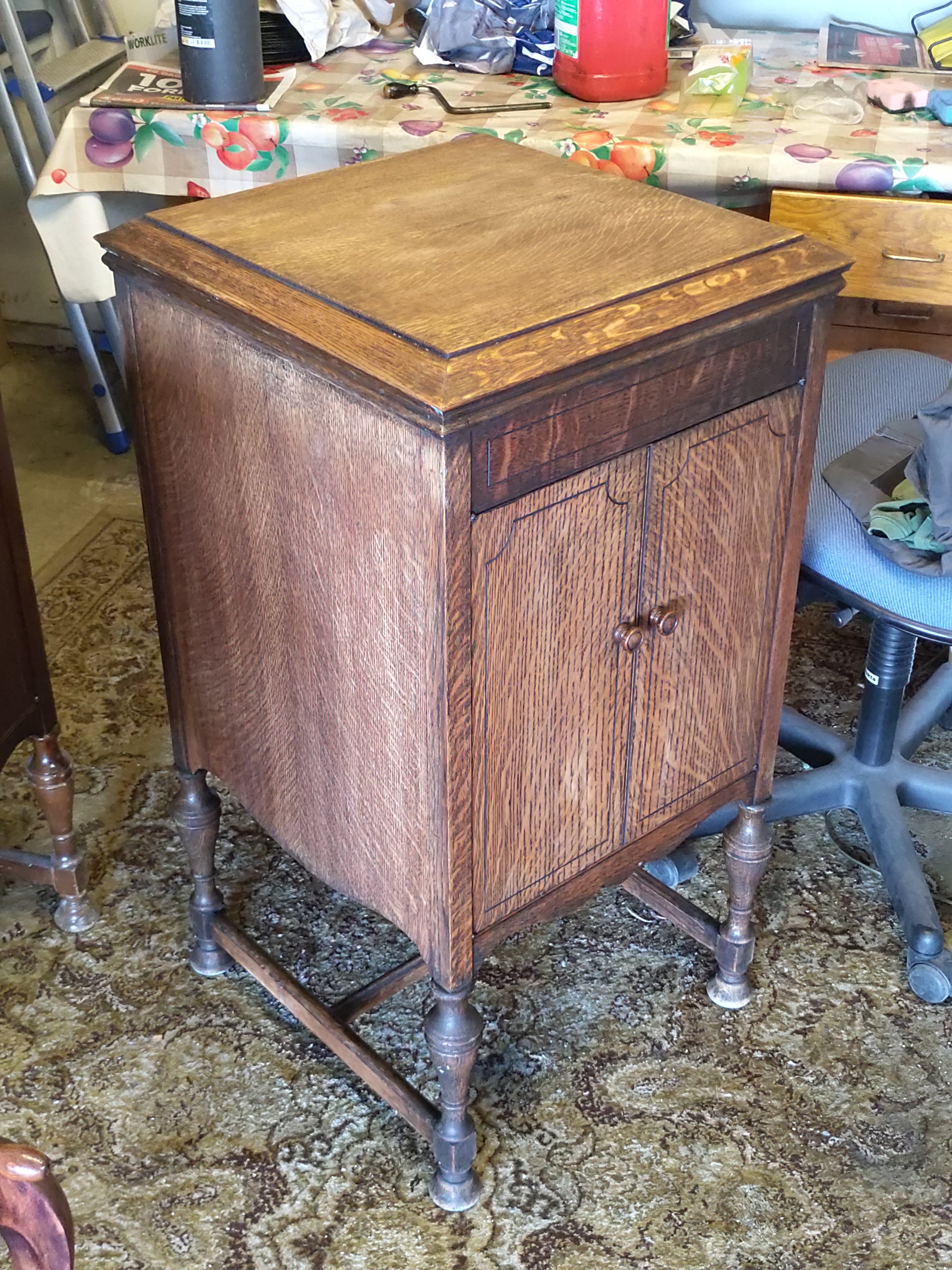

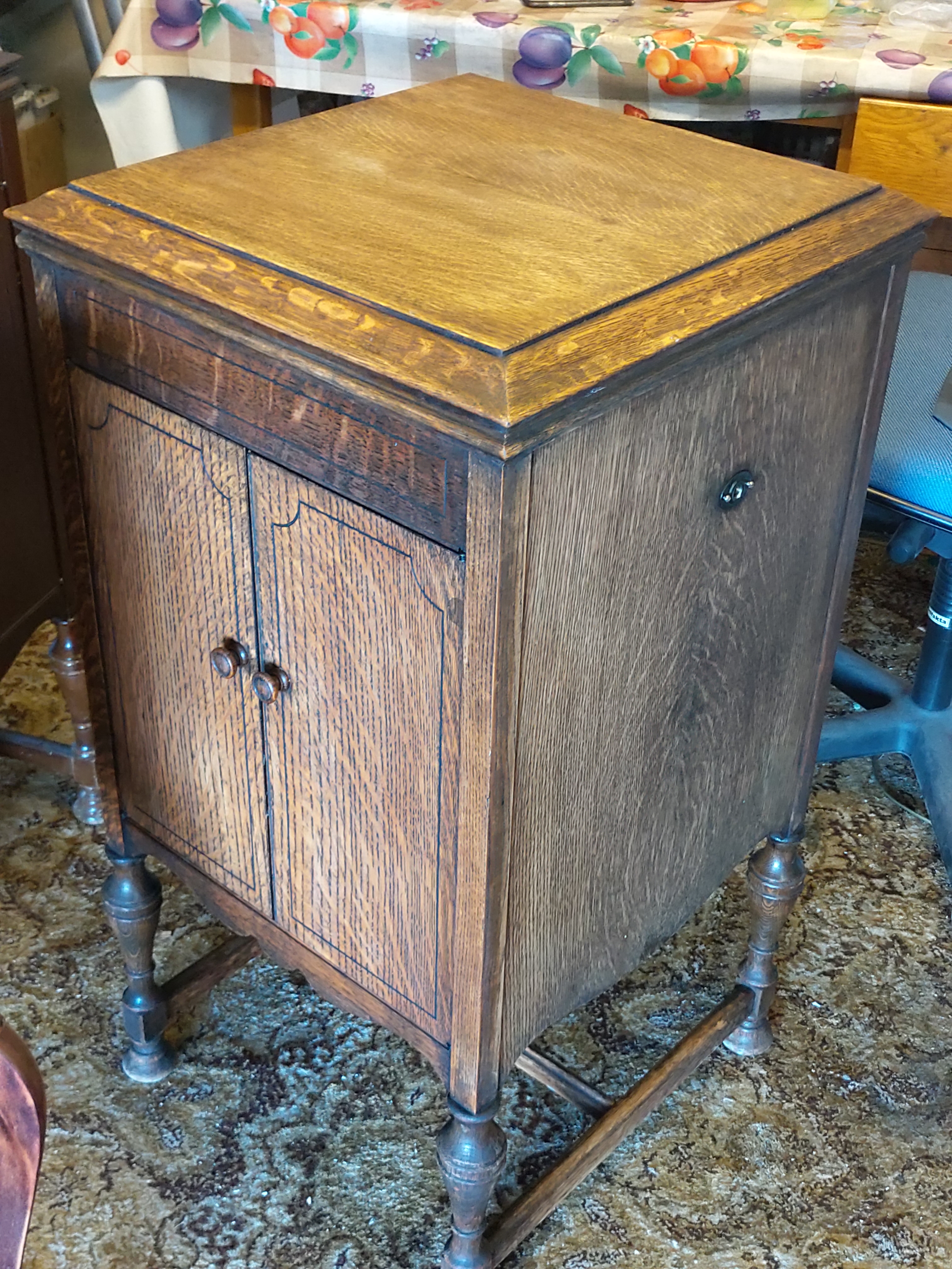

1. The dark oak cabinet is so light, I don't know what has happened to it, since it was not manufactured in this color?
We can see the upper front panel under the lid, has a darker color, that corresponds with the color inside the machine
Would you do something to it to darken it? I am about to add Howard's Dark oak Restor -A-Finish, but after testing a bit on the back side, it does not really darken much the color, since the cabinet is so bright.

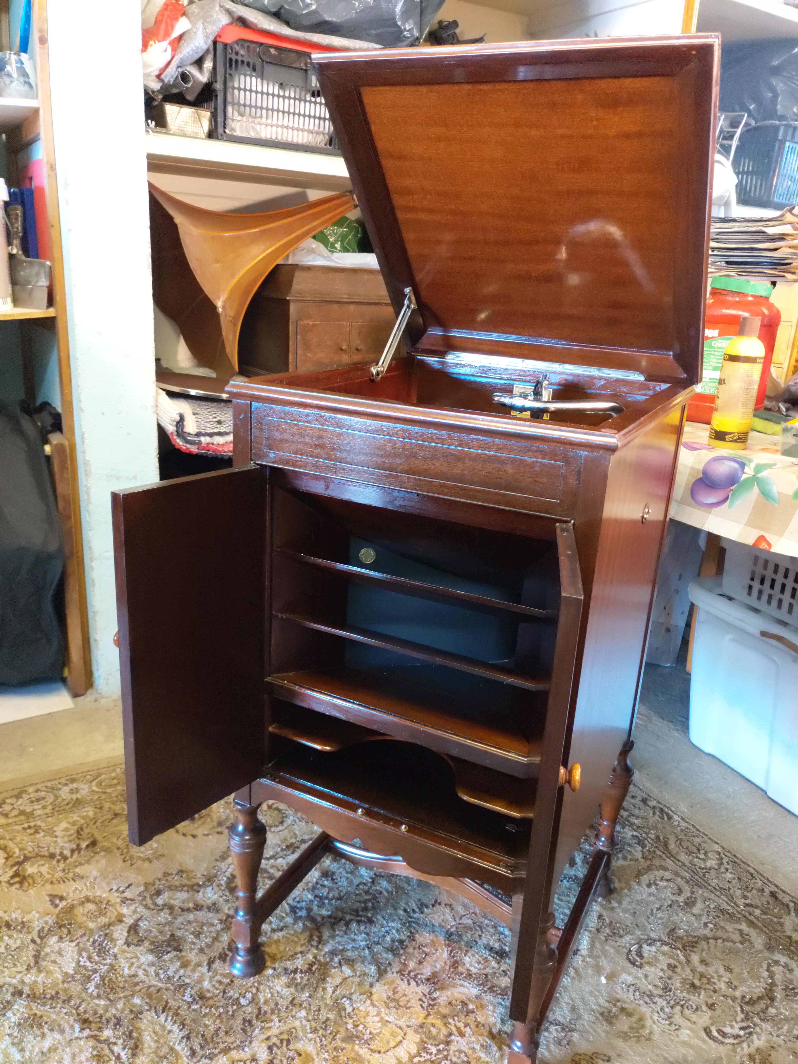

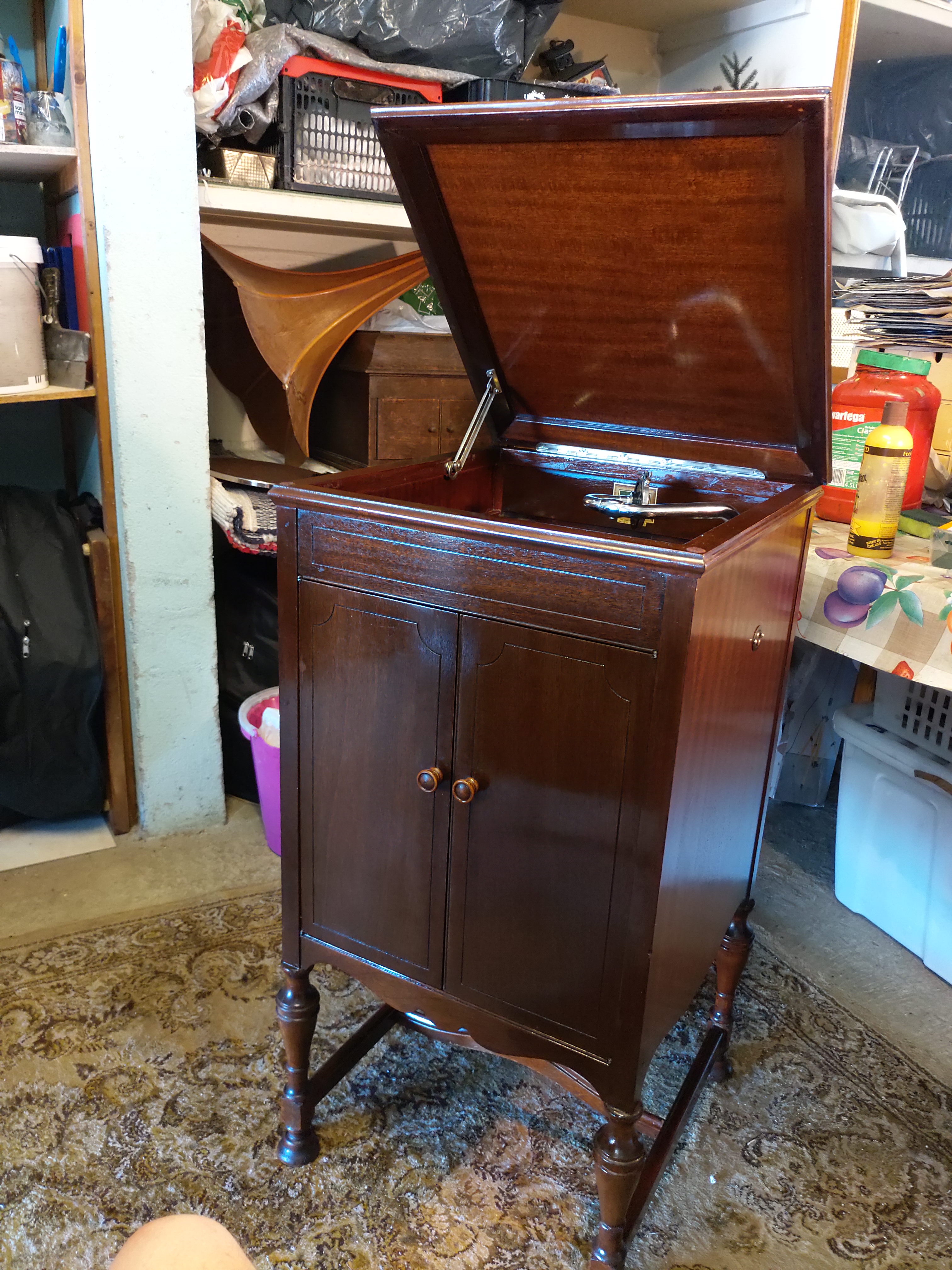

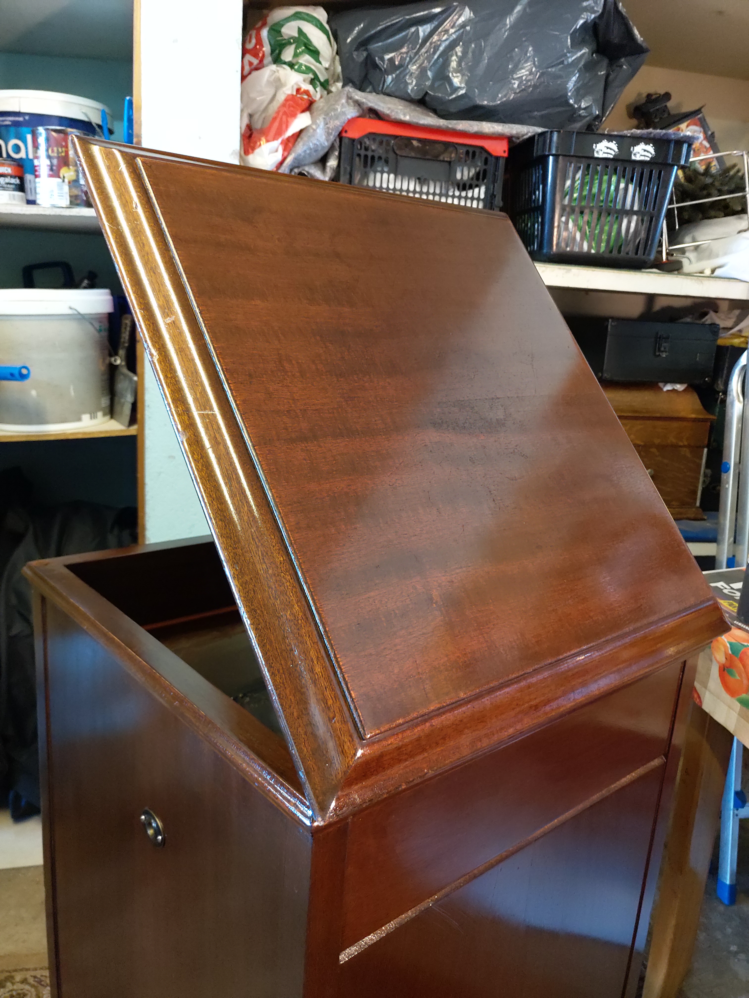

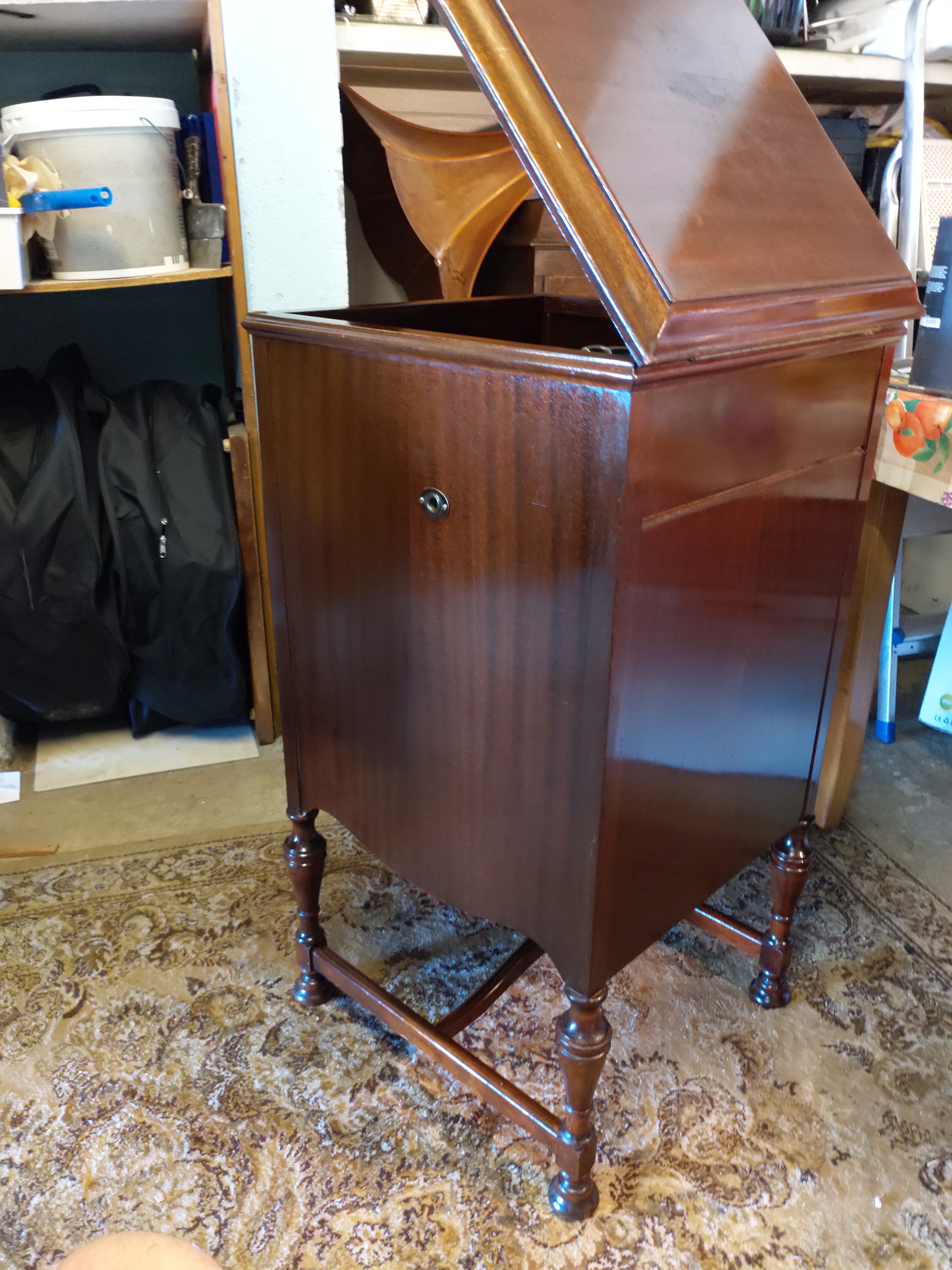

2. The mahogany machine is getting beautiful, only gentle cleaning with Swarfega and adding Howards Restore -A-Finish and ending with Polish, made this result.
I had to use 00 steel wool on the doors to remove scars, and it was successful. However the lid plate is not perfect, even after using steel wool, that has removed many rings and scars, I dare not go deeper in the veneer, since we know what will happen then, the wood panel under the veneer will shine through. We can see traces of rings from glasses. Would you do something more to the lid plate? Is there something one can do, apart from removing the veneer top plate, something that I don't like the idea of getting into...

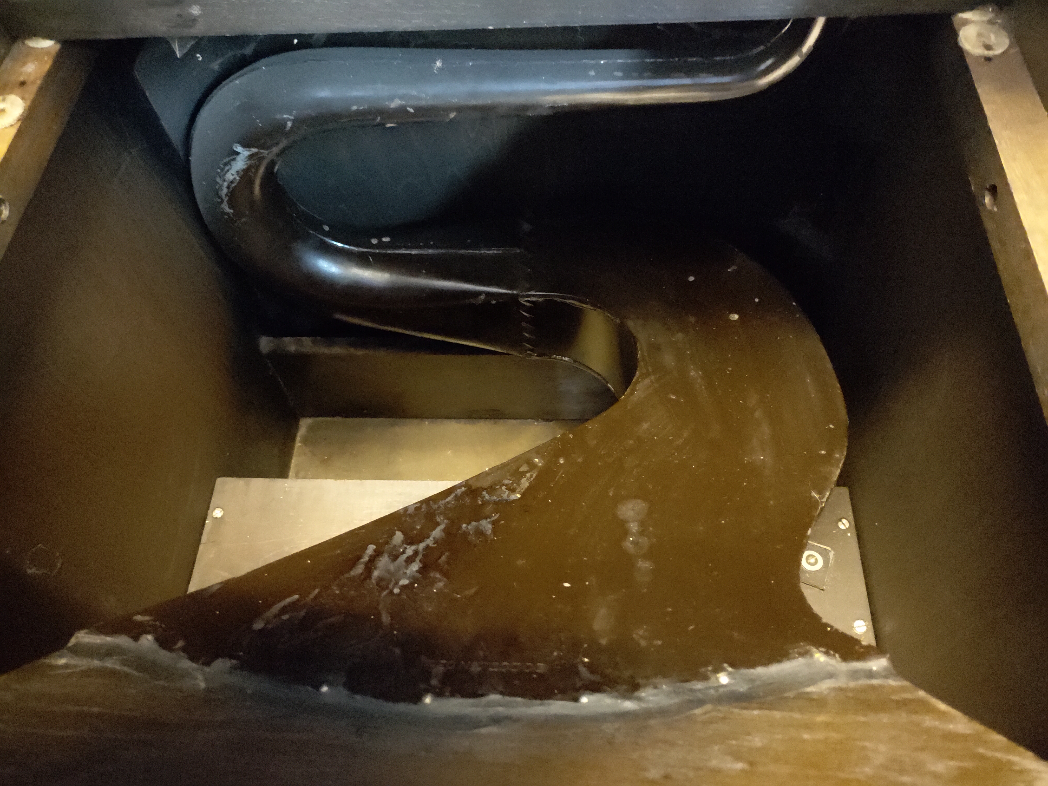

I am also attaching a photo of the horn on the 156, in case someone has not seen it, and want to see it.

My advice on the mahogany cabinet finish would be to STOP. It looks good as it is.
The oak cabinet, I would lightly sand then stain with a dye stain to get the color correct and even. Then apply varnish/lacquer/shellac, as you prefer, for a finish coat. Howard's Restore-A-Finish is great... if you have a finish to restore. However, in this case, the finish is gone!

I wouldn't rub that lid any further though otherwise you will get through to the veneer. Deep indentations are better left alone and just accepted for what they are.

Jerry, I have had the same feeling about this oak model 156, I need strip it, and then use a wood dye to add the correct color. The problem I had earlier with HMV cabinets are that light sand papering does not help much, I need get rather deep to remove the coating, if not the new layer of dye will not attach and it all looks horrible. On my cabinets, where I have stripped motor boards, and sometimes the lid, I have used Liberon Dark Oak Spirit Wood Dye. I watched the late Graham Barber using this product in his videos after stripping the lid of a cabinet. He was using a shaving blade to strip the lid, but myself I have now turned to carefully using a grinder, to avoid destroying my hands and fingers on the tedious work. Last summer I also stripped a complete light oak Odeon cabinet the same way, and it worked well. One has to be careful though, as Steve also reminds, to not get through to the veneer.
If someone has a good tip for the upper cover (Shellac/varnish/lacquer) that makes it shine a bit, after using Liberon Spirit Wood Dye, I will be happy to receive it, and it must be a product available in continental Europe. I had a extremely hard time getting Howard's Products into Scandinavia, it was constantly stopped in the customs worldwide because it is flammable, but at one stage I was able to get 4 bottles into Scandinavia ( Dark oak, and two shades of Mahogany, and Golden Oak), and they have saved my restoration work for sure.

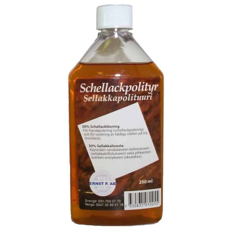

Update 2: I finally found and ordered a product this morning that I will try to use for a top layer, after using the Liberon spirit wood dye on stripped cabinets. I am posting a photo of the bottle, and will also post photos after using it on my cabinets.
It will be very interesting to see how it works.
