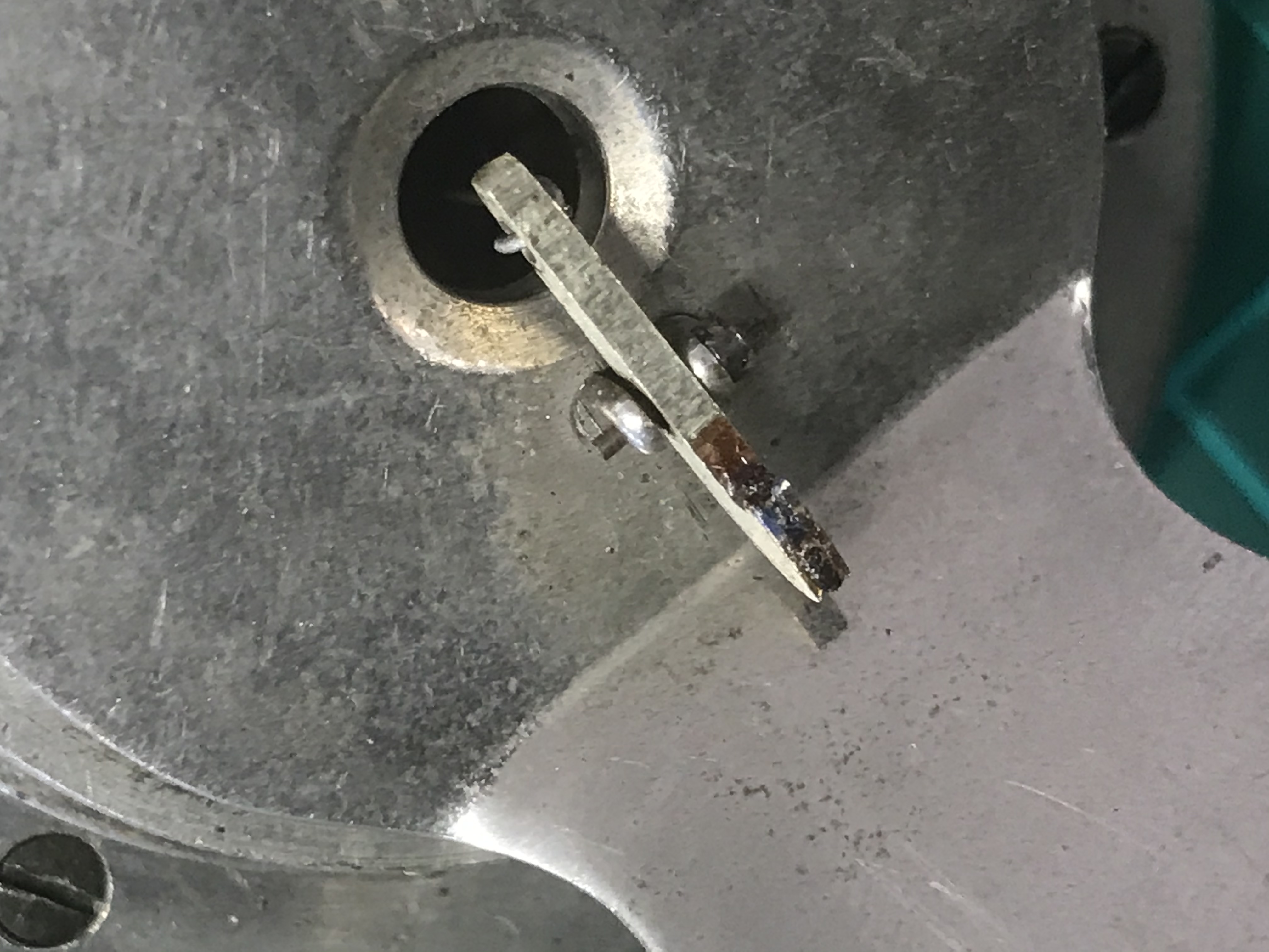

Missing a Edison home phonograph governer, the machine runs just now powerfully enough without the governer. Also does the model r reproducer stylus supposed to look like that? Help would be appreciated
Posts: 8276
Re: Strange Edison phonograph governer WANTED
The machine pictured is a Standard, and someone has installed 2 Victor governor weights. Three Edison governor weights should help the problem.
The stylus and stylus bar currently installed in the Model R Reproducer is the two-minute variety, which - as you suspected - is incorrect. A four-minute stylus bar and stylus will allow you to play four-minute cylinders on a machine with the proper gearing.
It's possible that whoever modified the Model R Reproducer did so because the Standard is a two-minute only machine. Without a picture of the upper works, we can't tell.

Hello thanks for your reply, the upper works of he machine has a 2/4minute gear selector and I tried an amberola cylinder on it, the reproducer needs a lot of restoration but the amberola cylinder was kind of working. Any ideas on how to straighten up that wire in the reproducer?
Posts: 8276
There are a few things happening:
1) The machine has its 2/4-minute attachment set in the 2-minute position.
2) An Amberol record (not "Amberola") will not play in the 2-minute position.
3) The reproducer pictured is a Model C, which is meant for 2-minute records - not Amberol records.
4) The Model C reproducer is not properly seated in the arm.
This article may be helpful to you:
https://www.antiquephono.org/basic-anti ... onal-tips/
Best,
Governor Flyball

Maybe it is the photograph. But I could not see the little "doorknob" sapphire two minute stylus on either reproducer.

2/1. I put it in the 2 minute position to play a normal cylinder as shown
3. the reproducer in it at the moment is a model c since I took the original out to play a normal cylinder
4. How do I seat it into the arm? It has a little hole at the top which fits in this ending (not sure how to explain it)
Regards

@governor flyball thankyou for your help, here are some images attached :

Thomas1899 wrote: Mon Jun 14, 2021 3:25 pm
Regards
By loosening the thumbscrew at the 1:00 position of the arm, then gently repositioning the reproducer, the little pin at the 12:00 position will align with the notch and the entire reproducer should be able to be gently pushing down into a fully seated position.
Governor Flyball was correct - there is currently no stylus in the latest pictures you posted.
