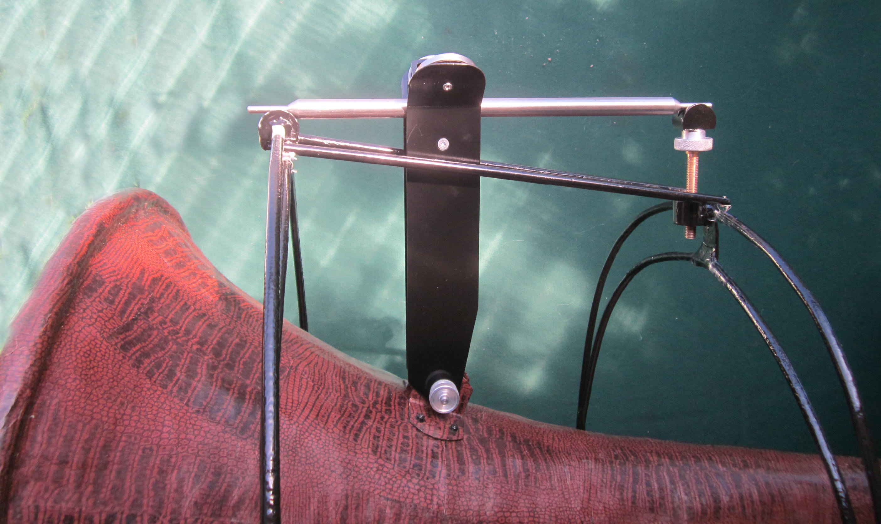

Re: PAPER HORN "BALMAIN"
View of angled wheels ON steel rod.

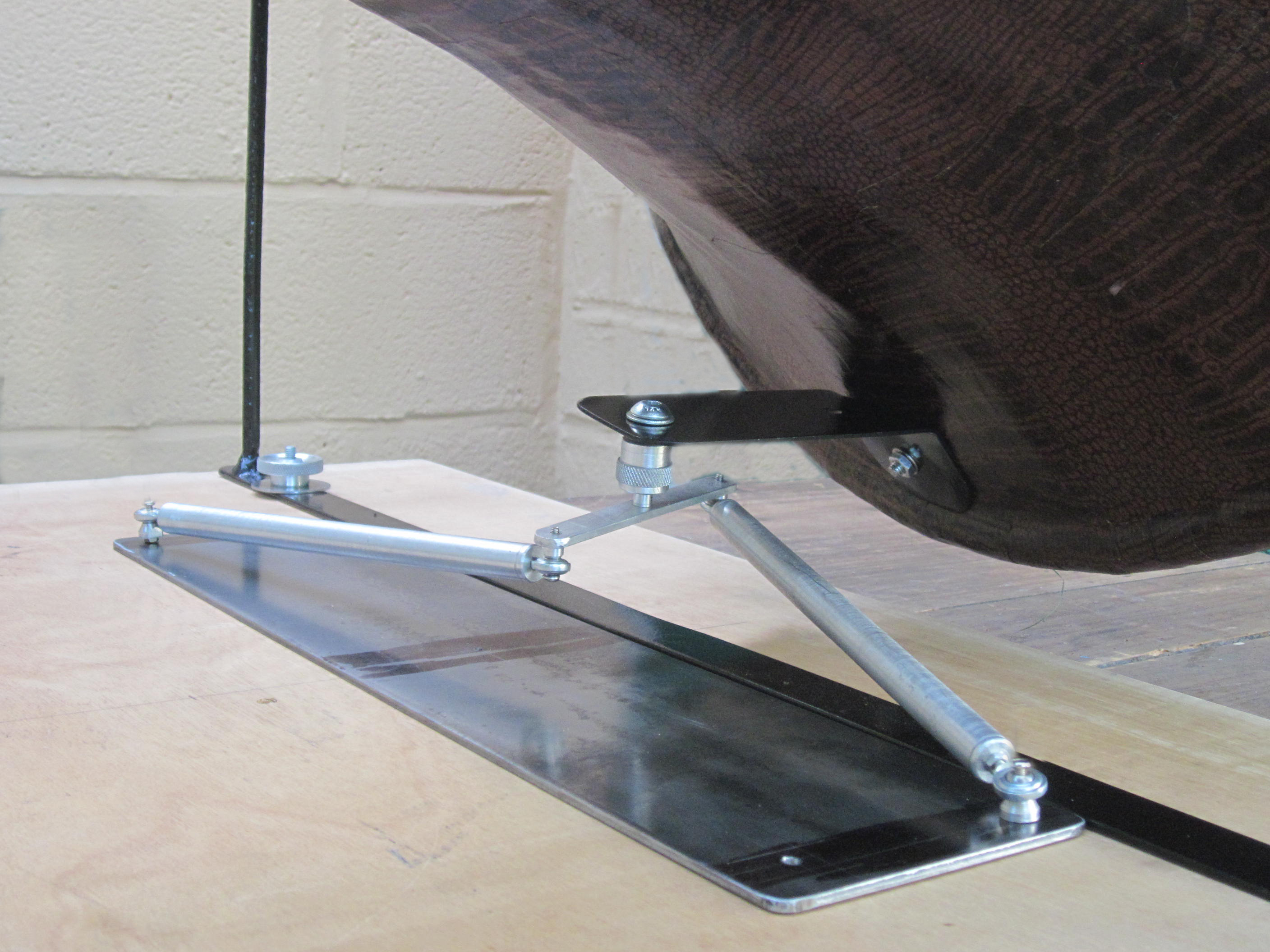

Large view of WATT LINKAGE attached to bottom of horn with a bracket.
Nice arrangement! What a fine work!
I never heard before of that Watt linkage... It's like a kind of pantographic device!
