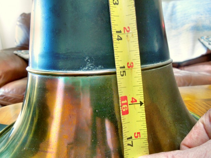

My original AH horn has a total length from the small end to the base of the brass bell of 15 inches.

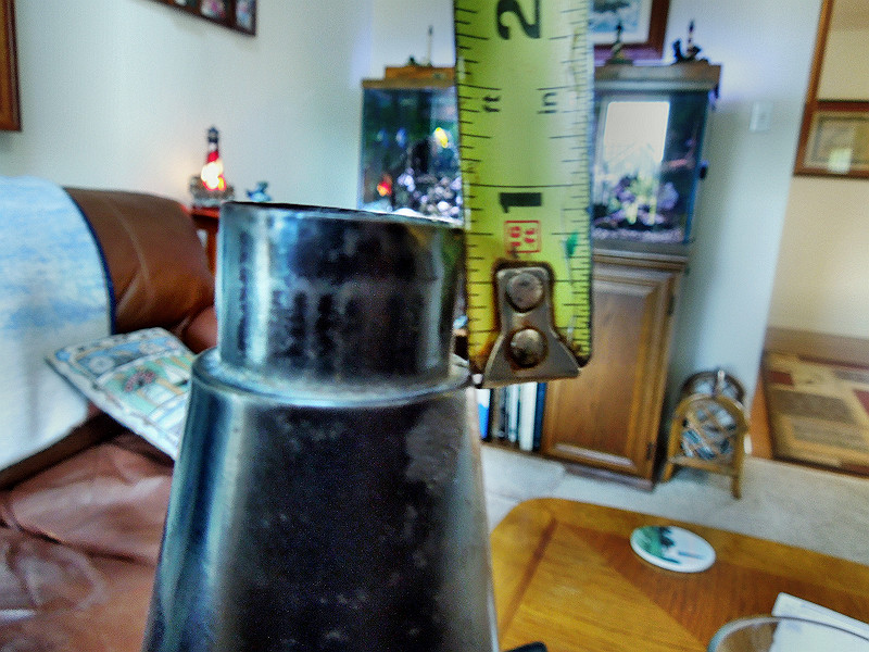

The length of the reduced area that fits inside the elbow is a hair over ¾ inch.

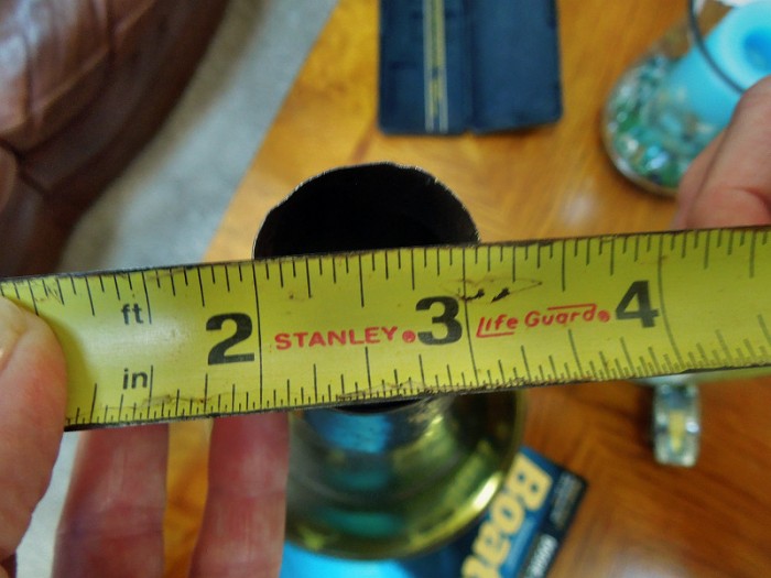

The diameter of the reduced area that fits inside the elbow is just shy of 1 ⅛ inch.
See attached pic's
Hope this helps.
Blizz

Thank you so so much - I really appreciate your trouble
this is exactly what I need.
