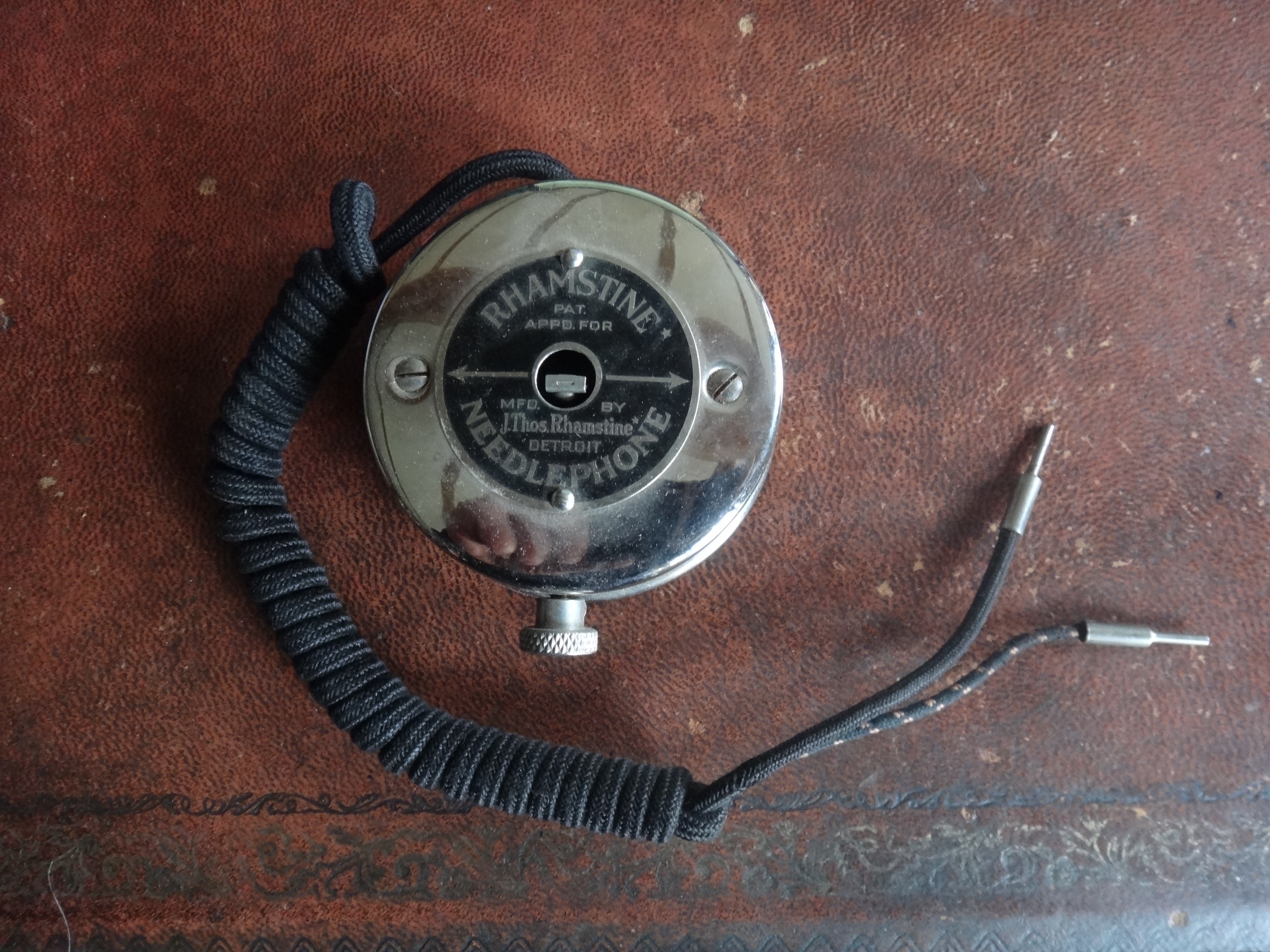

The one I have come across is called "Needlephone" by Rhamstine which I found on eBay (USA) quite recently. Unfortunately, although it looks as though it has never been used, it is not in working condition and I have not yet had to time to determine the fault but the coil might need rewinding. A friend has one which works well.

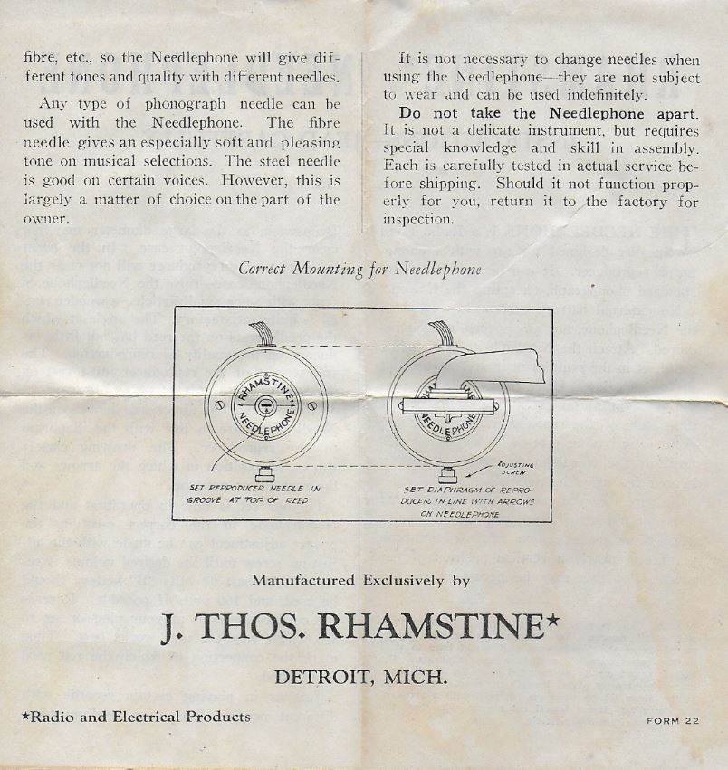

Nevertheless, something is surprising. First they say no batteries are needed, but later in the instructions they talk about using a 67volt, or better 100 volt battery!!! What am I loosing?? :?:

Inigo wrote: Fri Jun 18, 2021 3:37 pm Nevertheless, something is surprising. First they say no batteries are needed, but later in the instructions they talk about using a 67volt, or better 100 volt battery!!! What am I loosing?? :?:
The instructions are assuming you are using a battery powered radio, and although I really know very little about these I believe the B battery was the high tension battery. More voltage presumably meant more volume and that would make the the Needlephone work better. Thanks

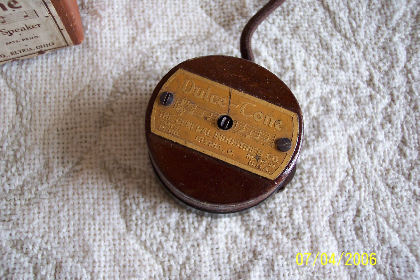

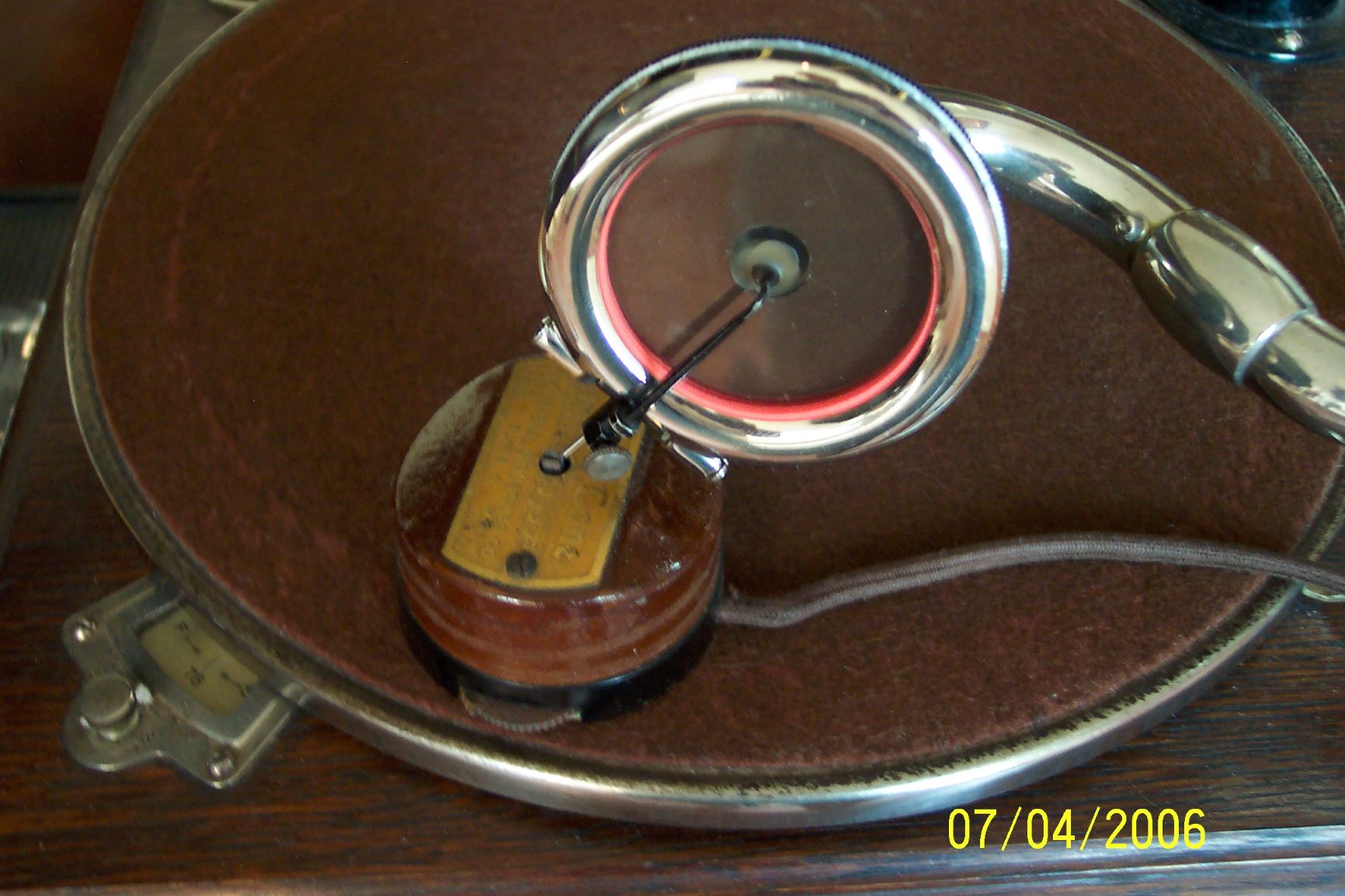

Here's some pix of one I bought at the Union show 15 years ago. It actually worked reasonably well. As stated in an earlier post, it does take a bit of power to drive it. I was able to attach a CD player to a keyboard amplifier and connect the external output of the amplifier to the Dulce-Tone needle gizmo. Imagine listening to ABBA's "Dancing Queen" through the horn of an HMV 32. :monkey:

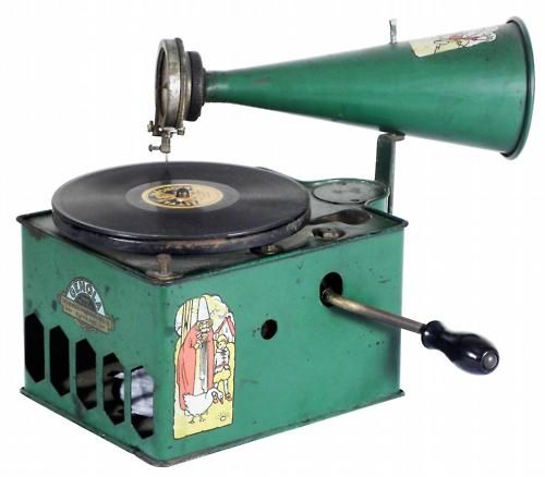

Your Dulce-Cone was made by the same company that made Genola toy phonographs... interesting.
