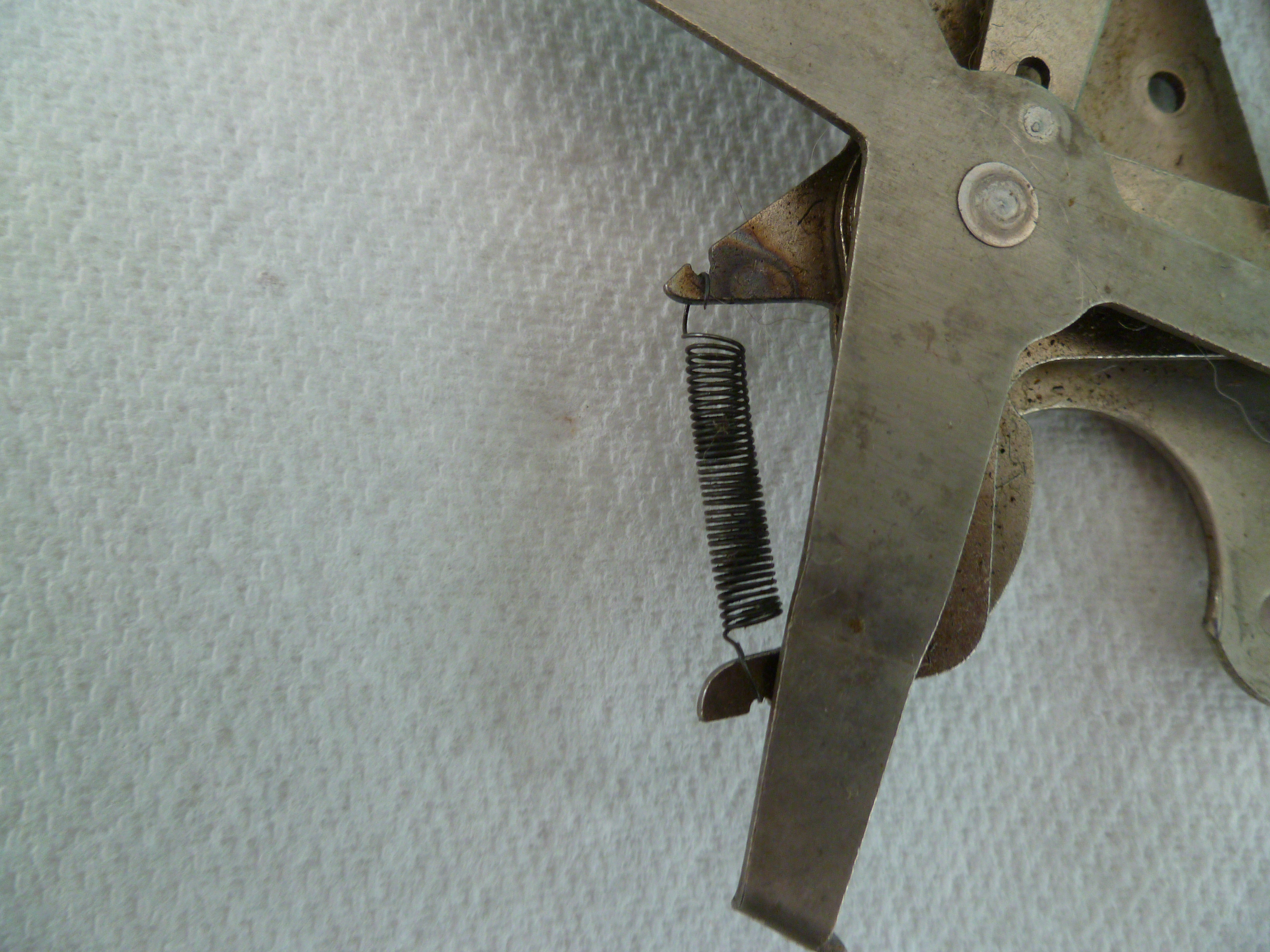

This blue HMV 102 came into my hands today, and there is a problem with the main spring, it is broken or slips at one end, I have not yet had the time to check. However, this is the first time I have got hold of an early 102 with this no 5 autobrake. There is a small cotton thread at the end of the brake, that I already have removed. I believe this is substituting a broken/lost small spring, even if I can't see this detail on the brake in the HMG book. This autobrake looks very complex to my eyes, and I think it is causing the motor to have problems. I am tempted to remove it completely, do you agree? I have a few manual brakes that for sure will work much better, if I at all can repair this auto brake, something that I doubt.

Oh dear, the infamous "universal" brake rears it's head again! I have two 102s with this brake, and know from experience that they are a nightmare to get working correctly. However, apart from the missing spring, everything seems to be present, so it would be worth the trouble to get it going correctly. I will take and post photos of mine tomorrow, just to double - check. Whilst admitting that they are not the most reliable of autobrakes, when the DO work, they are trouble-free about 90% of the time, and just require a tweak occasionally. I wouldn't remove it, or add a manual brake, both of which would detract from the machines originality.

As you can see, there is another tiny spring on the reverse side, in case yours is missing. The long spring is a fairly weak one, so you may need to experiment with various ones.

Thanks a lot for posting the photos, Barry. I have the small spring on the back side, luckily. I will try to look at some different autobrakes that are found on some scrappy portables, and see if one can be used. Thanks to your detailed photo, I am actually able to see the size of the spring in detail. I will also try to understand how this autobrake is working, since at the time of writing this, I still have not grasped how it is functioning. I will clean all the parts, check the spring etc..before trying to reinstall the autobrake.

I'll try to explain as best I can. You will have to re-instal the brake in order to see how it works. Then replace the small eccentric circular plate and nut that you had to take off in order to remove the assembly. Now wind the motor, and you will see that as that eccentric plate revolves, it causes the curved plate (on the right) with the teeth at both ends to rock backwards and forwards. Now move the tone arm inwards VERY SLOWLY, and you'll see that the striker arm that is hit by the turntable hub (as on the usual 102 autobrake) starts to move into the centre. It is knocked backwards by the rocking plate, but when the arm comes to the end of the record, and either stands still on a record with no run-out groove, or moves in and then backwards, as in a record that does have a run-out groove, then the rocking plate will gradually engage with the teeth on the striker arm, and move it in fully to be struck by the turntable hub, and thus stop the turntable. Note, though, that in the case of the record not having a run-out groove, so the arm stays still, it can take quite a few seconds before the mechanism goes through it's paces and stops. Good luck!nostalgia wrote: Mon Jun 28, 2021 7:51 am I will also try to understand how this autobrake is working, since at the time of writing this, I still have not grasped how it is functioning.

If you can't locate a proper spring, you may temporarily try with a rubberband, as rubberbands are easy to find and come in all sizes. As written earlier by Barry, it should exert only a feeble recall force, not a strong force that would stuck the parts in place.
Remember that the "red washer" area is painted red as a reminder that it shouldn't be lubricated. Personally I would try the autobrake "as is", possibly it will work at first try. Only in negative case I would try to disassemble and clean parts like the red washer area, which is an adjustable friction and once disassembled needs to be readjusted by trial and error.
