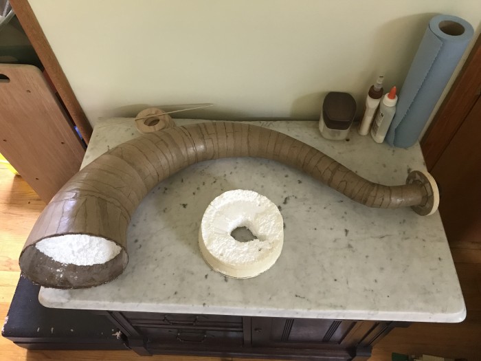

I’ve been visiting relatives for the past few days and haven’t made much progress on the horn, but I did get a stash of paper bags that seem to work better than the others that I tried, so I may not need to buy more paper, at least until I start work on the next section. I tried hammering out the former again, with no luck, so I made a rough sketch of a curved wooden “ramrod” that fits through the throat of the horn without catching anywhere; if it fits as well in practice as it does on paper, it should be able to transmit the force from the mallet to the former more efficiently than the Lego version.
The horn seems quite sturdy even at about 1/16” thick; I’ve tried pounding on it with a mallet to try to loosen the former, and it doesn’t show any signs of damage (although it also doesn’t show any signs of letting go of the former…). Has anyone else made EMG-like horns with plastic-like glue and thin paper, to say how their strength compares to the original horns?

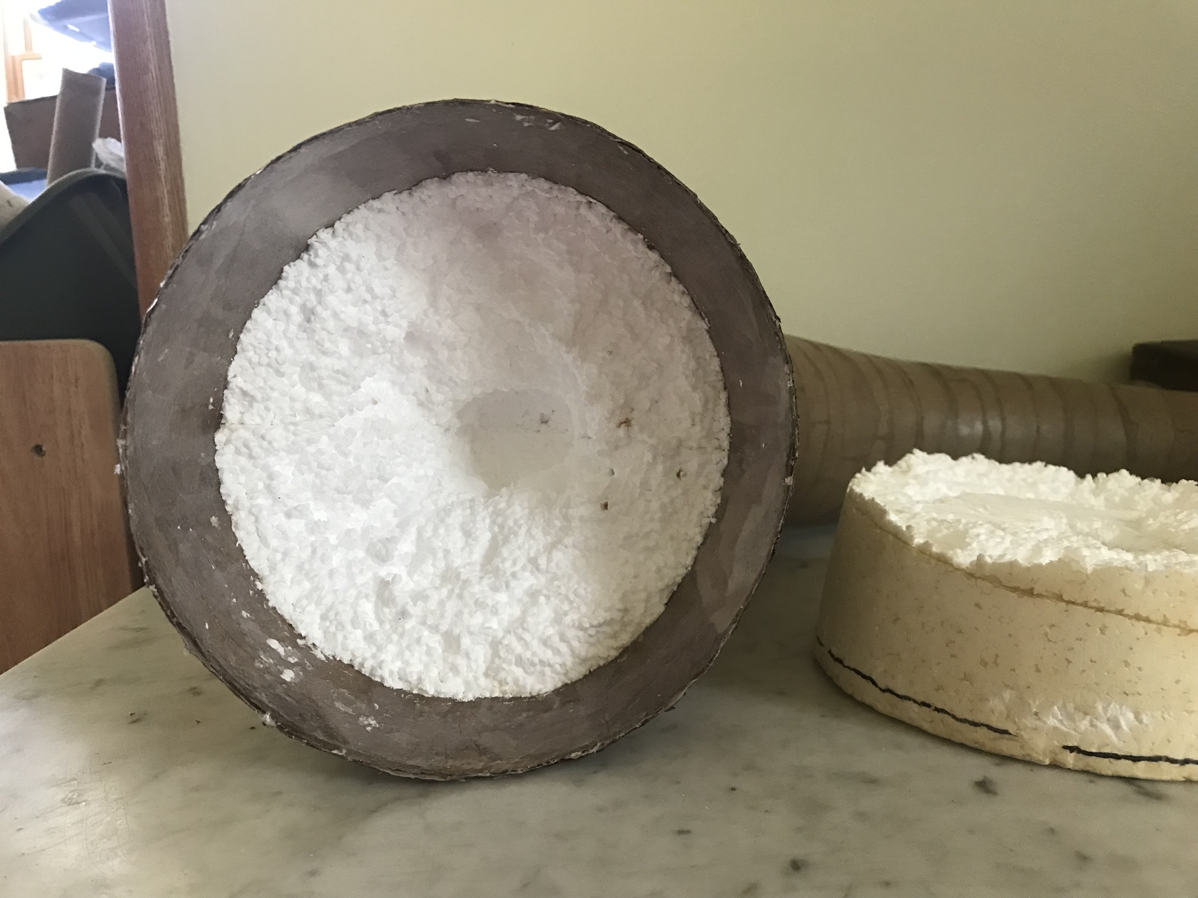

The horn is now about ⅛” thick, so I tried extracting the former again, this time using the wooden ramrod, but still with no luck—I looked inside the throat with a mirror, and it looks as though the end of the rod was just crushing the foam. I was able to excavate some of the foam near the mouth and pull out a roughly two-inch disc, but it was rather time-consuming, so I’ll probably try dissolving the rest with D-limonene; as it’s already damaged, there isn’t much point saving it.
The next steps will be filling in the gap where the paper shrank away from the end of the former, installing the wood ring that allows the two halves of the horn to be joined, and then adding another ⅛” of paper over that—fortunately, the new paper bags seem a little thicker than what I was using, so it should go a little faster now.
The horn  with part of the former removed and part still inside.

The inside of the horn--the black line on the extracted piece of the former marks how far the paper shrank; to fill the gap, I'll put the extracted piece back in, and apply paper mâchê over it.  The inner layers of the horn were originally off-white, but the Vaseline soaked into them and made them translucent, so now the interior is only a little lighter than the exterior...Methinks perhaps I might as well start the mouth with the sturdier brown paper, and maybe do a decorative final layer over the whole thing.

"Has anyone else made EMG-like horns with plastic-like glue and thin paper, to say how their strength compares to the original horns?"
What glue are you using for this project that you describe as "plastic-like"?
Maybe the glue is adhering to the styrofoam and Vaseline is not a good release agent? Just wondering, since not all glue adheres to styrofoam... This is only a thought, not based on real experience... What if you used a glue that doesn't adhere to styrofoam for the initial layers closest to the form and after it hardens use something else for the outer layers - after the form is removed? Just thinking out loud... what do I know?

Perhaps dissolve the foam with methylene chloride paint stripper, or acetone?

I used kitchen cling wrap on my mold… it separated on the first try.

And the plastic film doesn't adhere to the horn paper?

dzavracky wrote: Wed Jul 07, 2021 6:23 am I used kitchen cling wrap on my mold… it separated on the first try.
David
Very useful to know, many thanks. That's what I've been planning to use at some point in future when I remake the majority of a broken EMG Mk IX horn.
