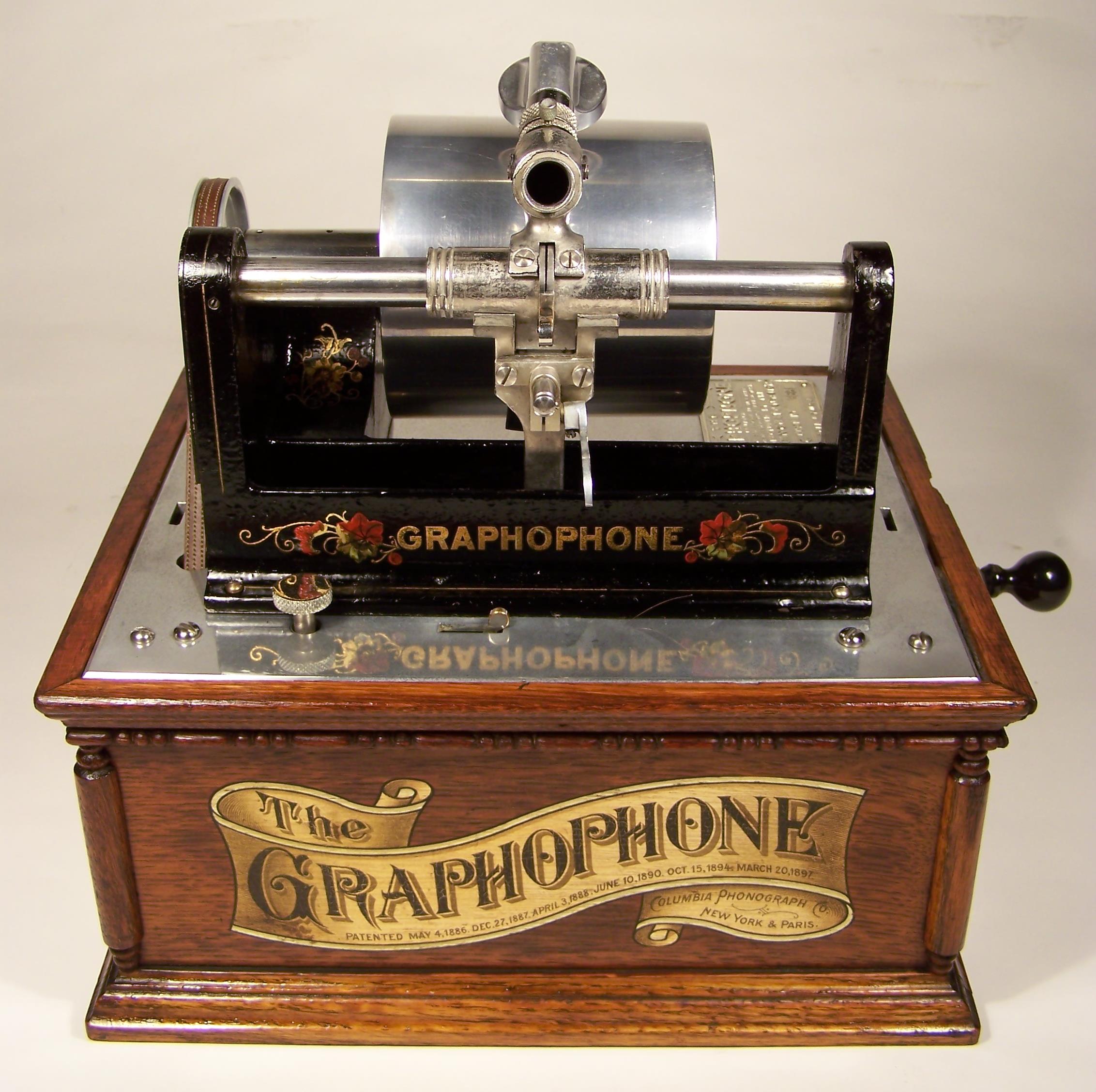

The earliest versions of the AG are virtually identical to your 1st Type HG with a nickeled bedplate. Soon, a polished aluminum bedplate was supplied with the AG (which was still priced at $75.00). The final version of the AG had a black-painted bedplate, and was priced at $50.00.
Here's a polished aluminum bedplate version:

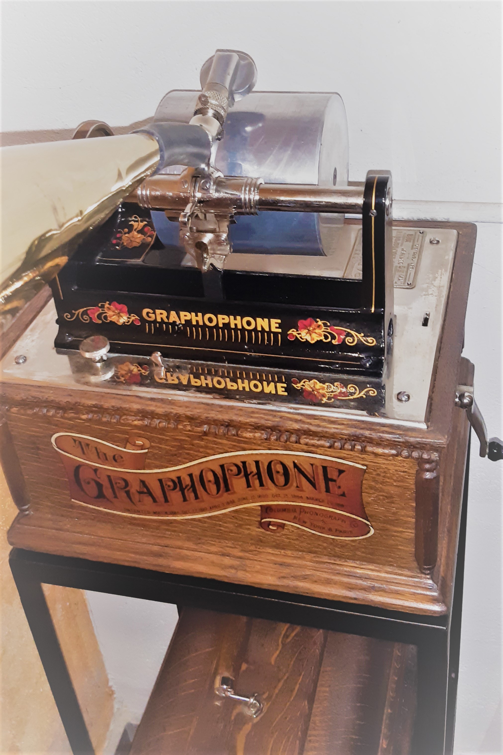

Thanks for your comments.
I wanted to send you some pictures of my Columbia, but am having trouble adding image attachments.
Ferran
Ferran

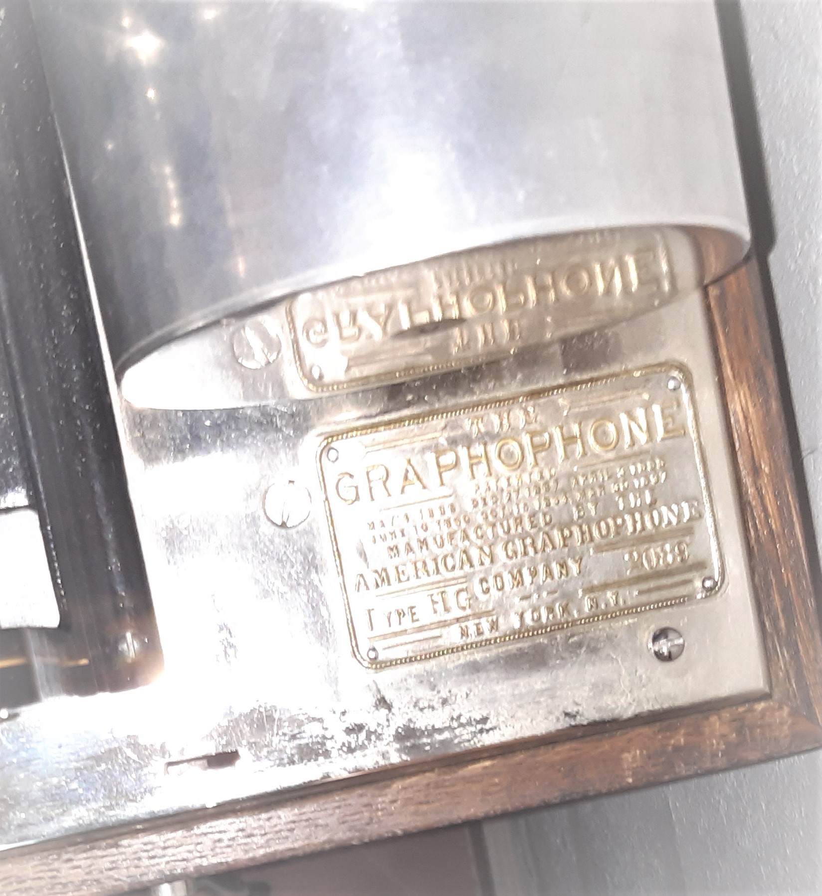

Your HG is in my database, it was sold at Stanton's auction Nov, 2019.

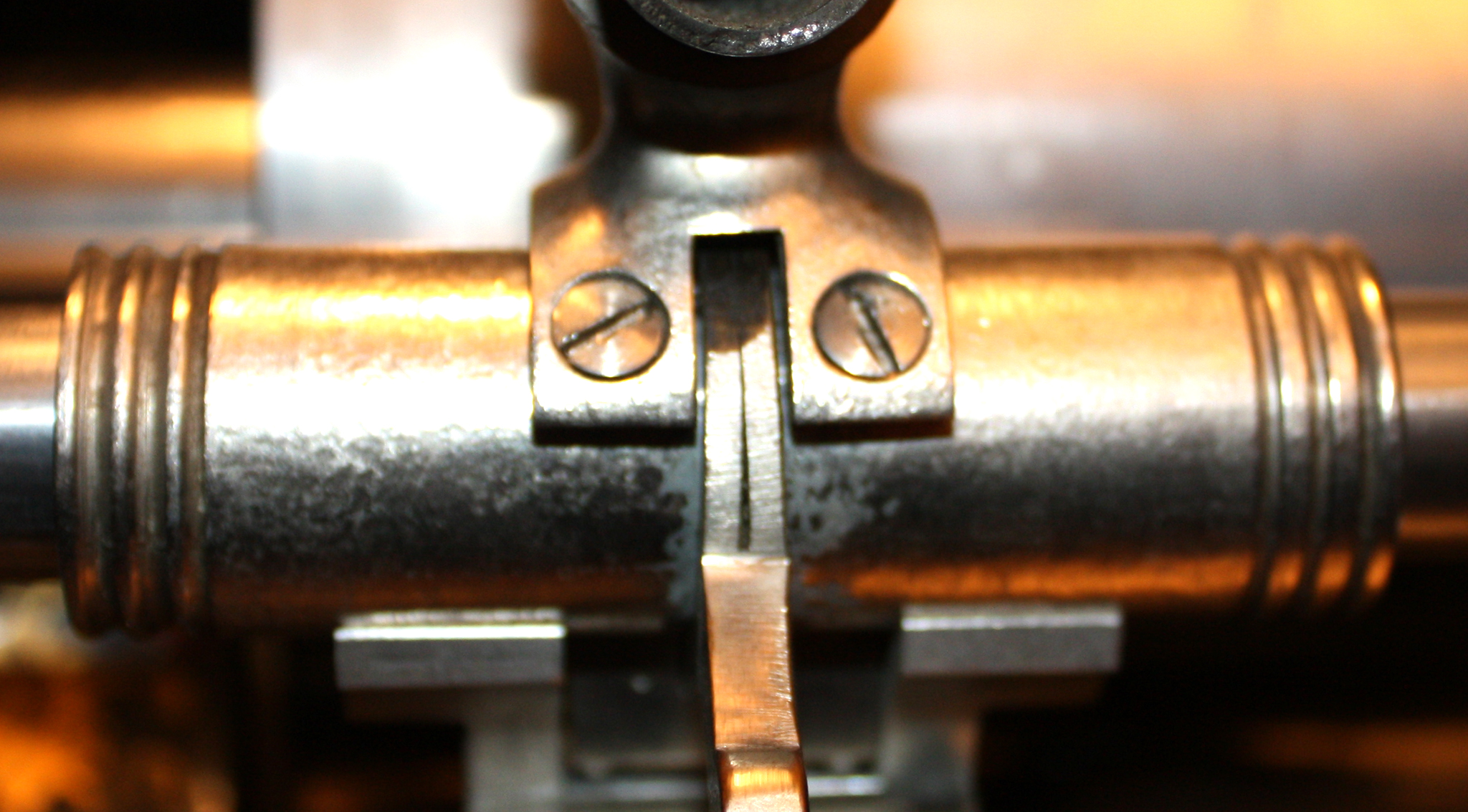

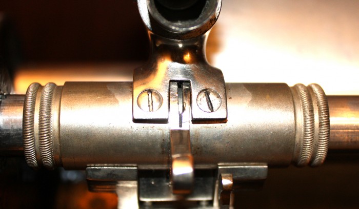

Carriage and mount from HG #491 All brass, notice the tooling on the ring ends of the sleeve.
This style is not usually reproduced. Carriage and mount from AG #2104 Pot metal, you can see the swelling of the metal under the nickel plating. The sleeve has been
changed to having three grooves cast in the ends.
Reproductions of this style are machined from aluminum, not usually nickel plated as it is very difficult to plate aluminum without chemically
treating the aluminum first. Chuck

Chuck makes an excellent point of showing the differences between the carriages of the early HG and the AG. You'll find the same changes in carriage during AT production, with only the earliest ATs having nickeled brass carriages.
Note that the carriage on the AG (#3861) I pictured above is the pot metal variety. This is one of the last $75.00 AGs manufactured, and the original paperwork that came with it suggests it was sold in August 1900.
