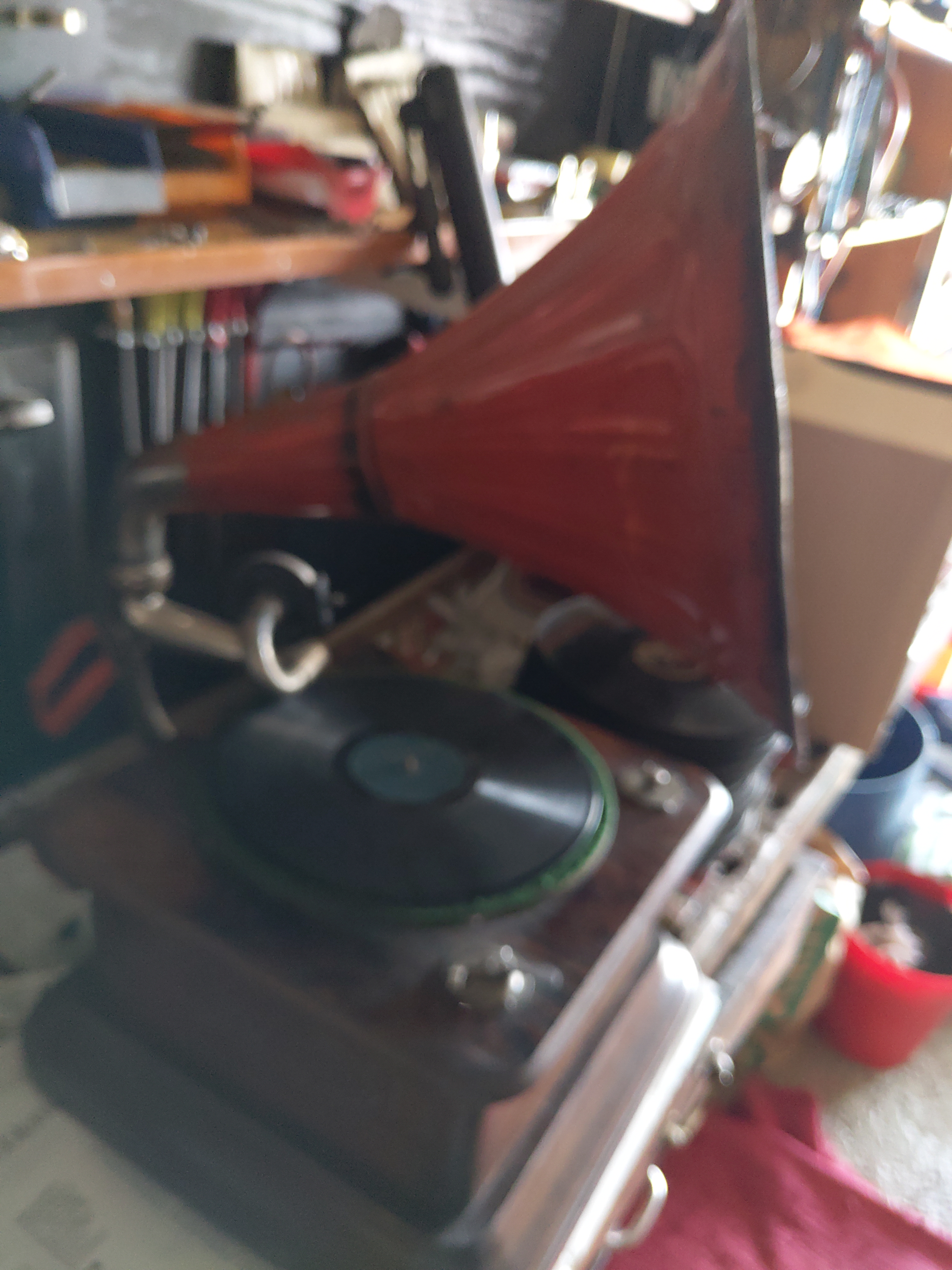

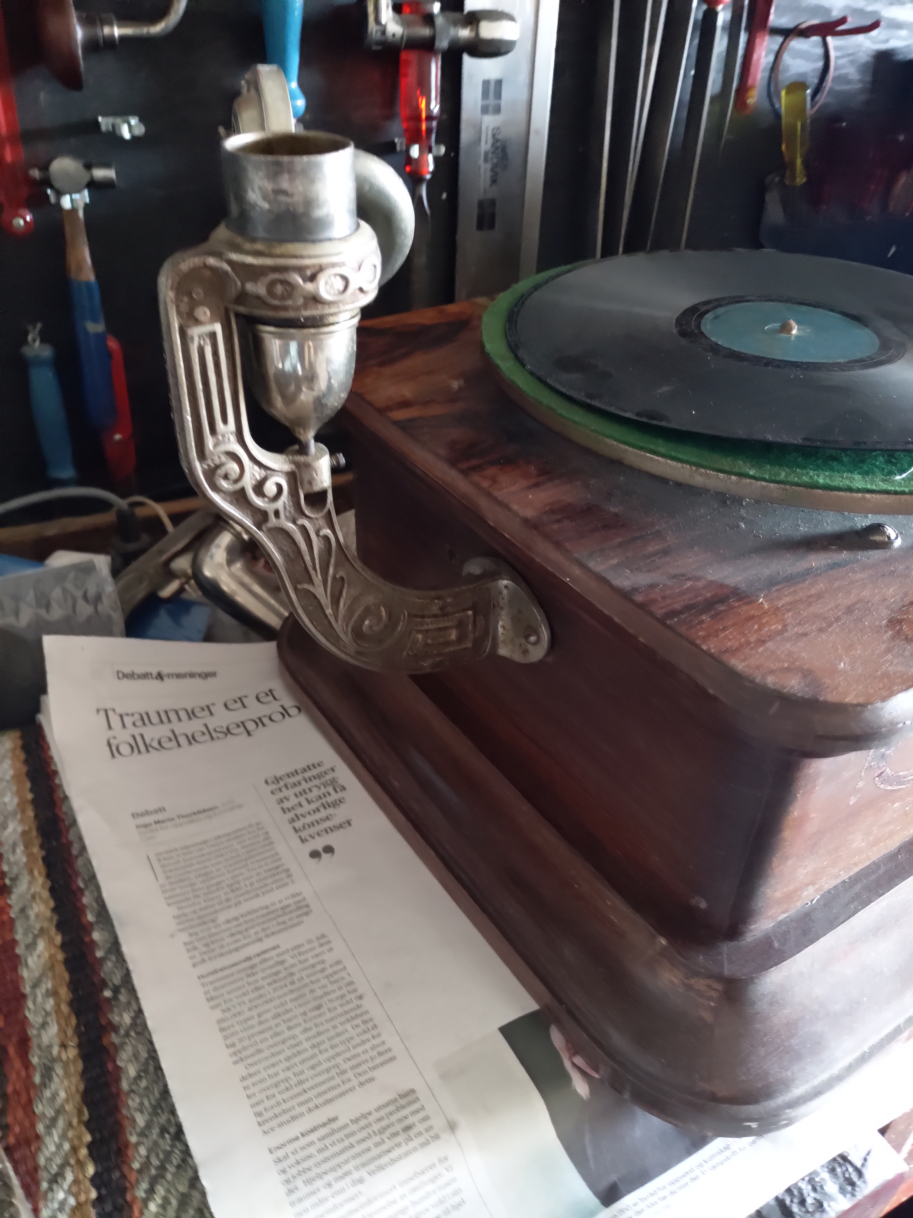

Now I need help! I came across this gramophone yesterday in my close neighbourhood, and that does not happen to often. There was only one photo available from the seller, and on this photo one corner looked broken off, and the total impression was not good, at a price of €120 euro, also without a winding handle. Still, we know photos can deceive, so I decided to check the machine, and soon discovered the gramophone cabinet was trully beautiful, absolutely no destroyed corners, but...with the back bracket and tonearm exchanged at some stage in the past. Now the machine had a back bracket and tonearm from a small Swizz/German horn gramophone, while this is a big cabinet horn gramophone. I still made an offer on the cabinet, and got it for a very low price.
As you can see the cabinet is really beautiful, and the motor is a heavy horse, a double spring motor, that really has "horse power!" And the wood, it is really beautiful, does someone recognize the wood type?
1. I am myself not able to identify the motor, it has a Swiss cross with a kind of arrow across the cross. I don't recognize this as early Paillard logo, since the early Paillard logo incorporates a post horn on top of a cross.
2. If someone can identify the motor/ gramophone, it will maybe be possible to at some stage in thet future find a back bracket/tonearm that fits this machine.
I upload some photos, at the bottom how the machine looked when I bought it, and on top we can see it after a general clean up.

The motor logo is Thorens. You found an extremely beautiful machine - congratulations.
It apparently had metal embellishments on the sides at one time...
Does the needle reach the spindle when in playing position? If so, the tone arm is not too short and the setup and horn may be correct, it looks like a Swiss back mount and horn... Does it say anything inside the reproducer, behind the diaphragm?

I quickly saw the tonearm was not genuine, there was an extra hold drilled in the wood on the back side to attach the back bracket, and the horn is a small type of peackock horn, typical for the small Swizz horn gramophones of which I already own a few. The needle does absolutely not reach the spindle area, and it was when showing this to the seller, he said I could offer what I wanted for the machine, if I wanted buy it.
A scrappy Columbia 20 soundbox with destroyed diaphragm was attached to the tonearm.
So now I need go hunting..for a Thorens back bracket and tonearm. It may take a while, but it will be worth the effort when looking at this machine.

Regarding the wood, most of the case is mahogany but the dark grain on the motor board looks like rosewood.
That is most unusual to find on a gramophone. I wonder whether the motor board has been re-veneered.

This nice deluxe double-spring machine appears to have a fine rosewood veneer to the top. The rest will be mahogany, the rosewood adding an exotic touch.

You make a good point! Nostalgia needs to check the underside of the motor board to see if the rosewood veneer is covering redundant holes.
