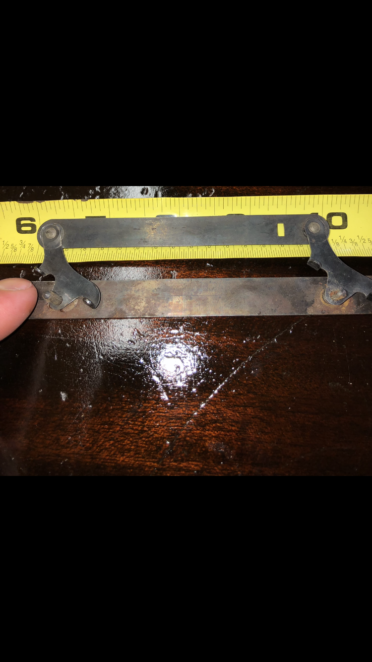

My Columbia Nonpareil has those same louvers. When I get home tomorrow from class I can post some pictures. If I am remembering correctly, you are missing two pieces actually. They are two rectangular pieces that have a pivots with two feet (is that that right word for them?
) that rest on the back of the louvers. The right piece is different from the left side because it has a small hole to attach that little rod into (the one you drew the arrow to). When you turn the knob on the side of the cabinet, it moves that rod up/down; which in turn makes the louvers open/close.
Hopefully this will make more sense when I post the pictures tomorrow.

Thanks guys, any info on the linkage will be helpful. Curt, I used Varathane sandable wood filler for the missing wood. It is water based and dry quickly. I used a quill pen with dark walnut stain to fake the grain.
I got my ¼" oak board to make my louvers and can see from many pics that I have researched that there is a cove back cut on the upper edge of the lower louver. I have not been able to see if there is a round over on the upper louver lower end. I would think there would have to be to get a nice tight seat and minimize the middle gap of the louvers.
Again any help would be much appreciated.

I will use a router to do the cove back cut and then and round over "I think" then cut to length. Then veneer the tiger oak to both sides. That is the plan and will update as I go.

Here are some pictures. Hopefully this helps! There is only one piece that actually moves the louvre... not two like I had said yesterday. On my cabinet, the two vertical pieces of trim are NOT glued into the cabinet. That way when the 4 screws are removed.. the louvres can be pulled out of the cabinet. I am not sure how it was done on yours though.
The top louvre has a small horizontal cut across the top where the bottom louvre sits in when closed.
David

Dzavracky, thank you, thank you. This is what I have been looking for. Thanks for putting in the scale, I know how to convert that to any piece in the pic. I know that the pics are from a standup model but at lease I know the thinking behind it and don't think that there would be a difference. Time will tell as I make each piece and put them together to see if I was on the right path. The only question is are the louvers on the machine three inch top to bottom, It does not matter how long just height and that is for the pivot points for the louvers

The bottom louvre is 3 13/16” tall. The thickness at the top end is ⅛”. In the middle of the louvre (31/16” ish from either end) the thickness is 7/16”. And at the other end, the thickness is ⅜”. Hopefully these measurements will help will the tapering on the back sides. Each front side is flat. Both top and bottom edges are rounded. The center of the holes on the sides of the louvres are 1 ⅞” from each end, and is set back ⅜” from the FRONT of the louvre. Meaning it’s 1/16” from the backside of the slat. The hole is ⅛” in diameter.
Now for the top louvre it seems is 3 ¾” tall…. But maybe I am just off by 1/16”
. Except on the front side, it goes up 3 9/16” before the horizontal cut. The hight of the set back part is 3/16” and is cut ¼” back from the front of the slat. It seems to be 3/32” thick, and is slightly tapered at the top.
Hopefully these measurements make sense and will be helpful for you ! I am attaching a hand drawn picture as well to help clarify
David
