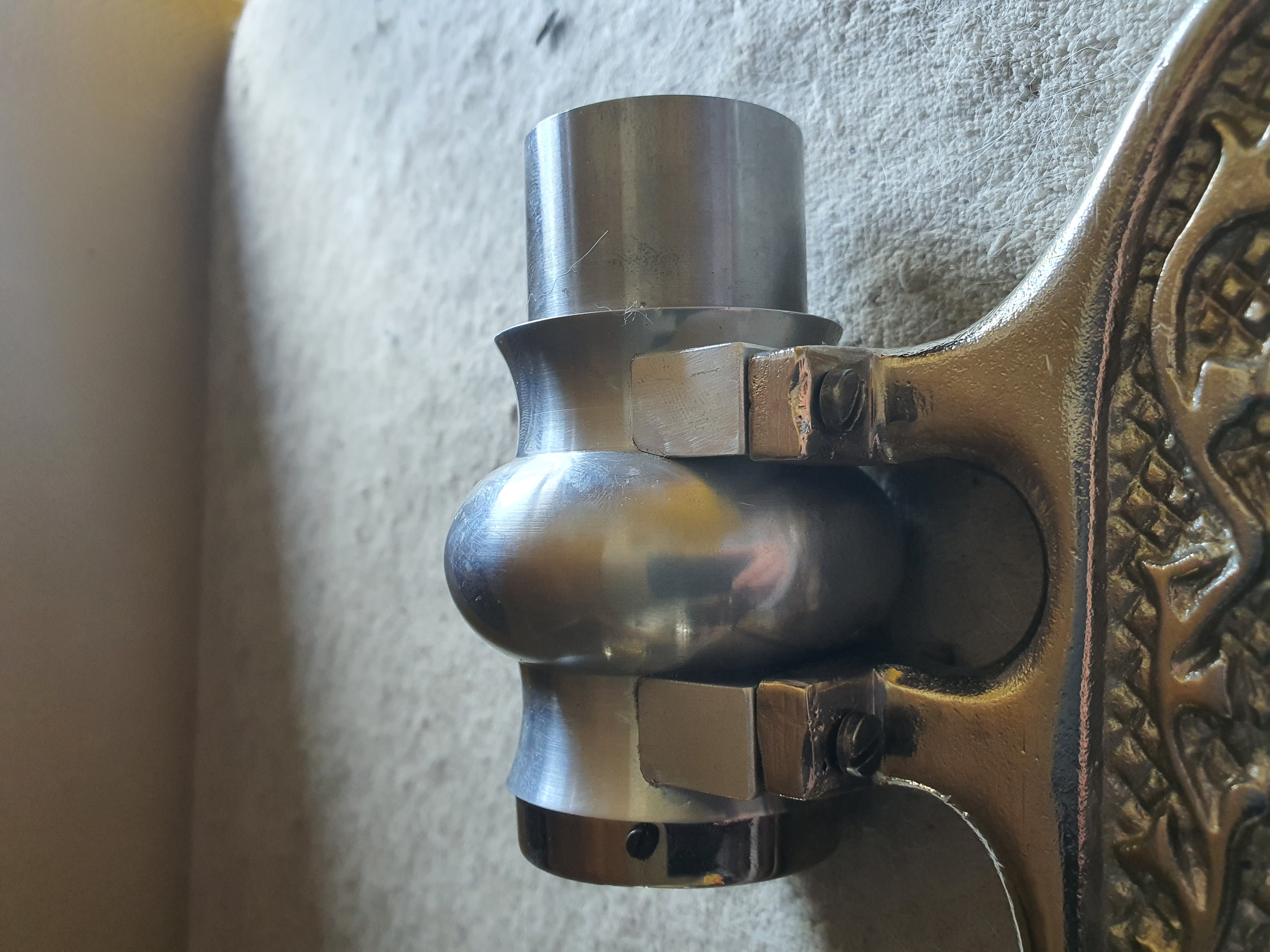

This is a very nice decorative machine! It’s a Pathéphone 12.
The damage is a common problem with Pathés. The pot (junk) metal swells and then cracks and crumbles against pressure from the inner support tube. The YouTube picture suggests that someone has repaired this part with filler and then painted it silver. To provide strength they have made it thicker than it originally was. You can get quite a tidy repair like this using a hard epoxy or resin and then fine sanding to achieve a smooth uniform finish.
I don’t know of anyone making this part but member ‘emgcr’ had a similar, or the same, part made by 3D printing. You can see his interesting photos at the bottom of the first page of this thread, link below. Unfortunately the process is quite expensive so repair maybe a better option.

If it's a local repair, I also prefer to repair with suitable 'liquid steel' repair mixture, etc, and even not painting it. I prefer to show the repair work (war scars) than to hide it. I don't know... I believe this approach is more respectful to the originality of the machine. And if someone later wants to improve the repair, the new or added parts are clearly identifiable! ;)
In my case, I have an eternal problem with a mazak Vocalion tonearm which has broken at the finest part, the end with the revolver mechanism where the soundbox elbow is attached. My last repair was a bit of reconstruction with metal epoxy and a standard pipe clamp of suitable size (½") added outside, with its horrendous chrome finish (the rest is gold painted) :D it works!
viewtopic.php?uid=1043&f=7&t=41802&start=0
I have a couple of original Pathé arms that survived with no prblems over the years. Indeed the toroidal interface is quite thin, but if not abused it will resist and survive, in a much better way than other pot metal parts. There are also modern reproductions of the toroidal interface, made in aluminum. I have one of these - it is quite well done, not distinguisheable from the original - see photo below. I presume someone made a batch of these in the recent past, and every now and then one of these show up for sale on French Ebay.
