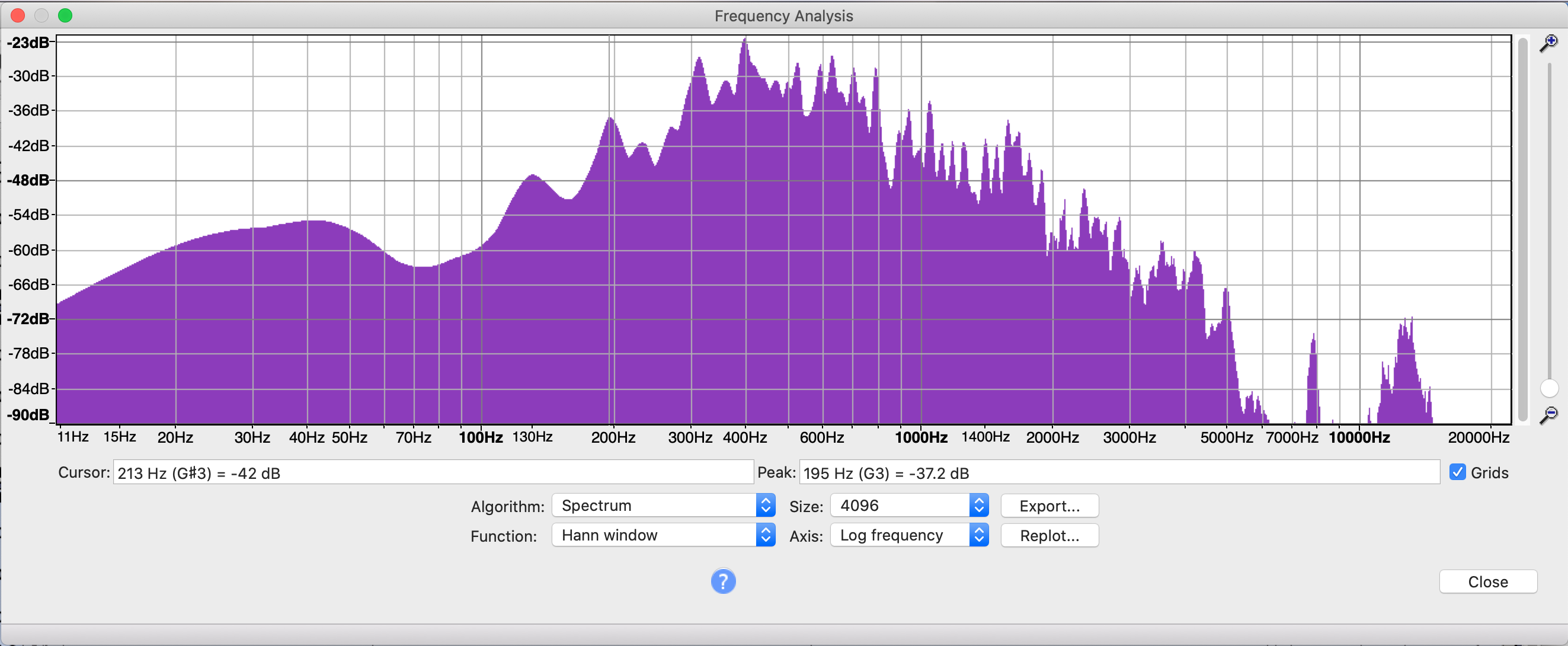

As emgcr noted, the bass does seem to be rather lacking considering the theoretical 100 Hz. cut-off; after adding a few more layers to the neck, the typical frequency content for a late-’20s Victor record is as pictured below—roughly equivalent peaks at 130 and193 Hz., large peak from around 300 to 1700 Hz., and high cut-off around 5000 Hz. I presume that the peaks around 8000 and 10,800 Hz. are mostly surface noise, and the peak at 50 Hz. may be in the recording, but is probably from the environment. I know that the recording levels are supposed to decrease gradually as frequency decreases, to prevent bass grooves from running into each other, but this response looks more erratic than I would have expected for the recording system, so I presume that the fault is in the reproduction.
Frequency content while playing Nat Shilkret's recording of "Get Out and Get Under the Moon" (Victor 21432-A, 1928) with an extra-soft tone steel needle.  The low cut-off appears to be around 130 Hz., but it looks as though the region from that up to around 300 Hz. is relatively too quiet.  (Or perhaps 300 - 1700 Hz. is too loud...). The ~50 Hz. peak is probably not from record.
Based on its dimensions, I’m guessing that the horn’s lower cut-off should be somewhere around the cut-off of the Mk IX or X; does anyone know roughly what their frequency responses typically are?

I did some more not-very-scientific frequency response tests over the past few days, and after adding three layers overlapped halfway (six sheets) to the horn and one layer overlapped two-thirds (three sheets) to the internal conduit, there seems to be a slight improvement in bass; measuring the frequency content of the same record, the 130 Hz. peak has dropped to 125 Hz. and increased in amplitude—hopefully a sign that the increasing thickness is preventing low frequencies from passing through the horn walls. I’ll be adding more layers over the next few days, so it will be interesting to see—and, more importantly, hear—whether the trend continues.
Frequency content of Ted Weem's "Anything Your Heart Desires" (Victor 21767-B, 1928) played with an extra-soft tone steel needle before adding more layers to the horn and internal conduit--the response drops off below about 300 Hz., with large peaks around 200 and 130 Hz.  The peak around 40 Hz. is probably not from the record.
The same record played with the same type needle after increasing the horn/conduit thickness--the frequency content is similar, but the lower peak is now at 125 Hz. and is somewhat wider and higher.  Again, the 50 Hz. peak is probably (mostly?) from the environment--I'll have to record some "silence" in my room to see what the ambient frequency content is.
