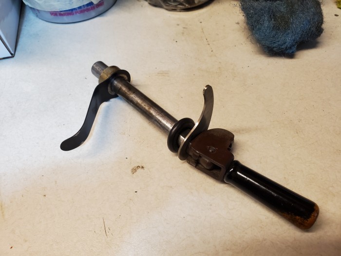

I have an Edison LU37 that I took apart to clean and re-Lube. Unfortunately I failed to take those all important photos and have forgotten how to re-install the parts on the Lift shaft and handle.

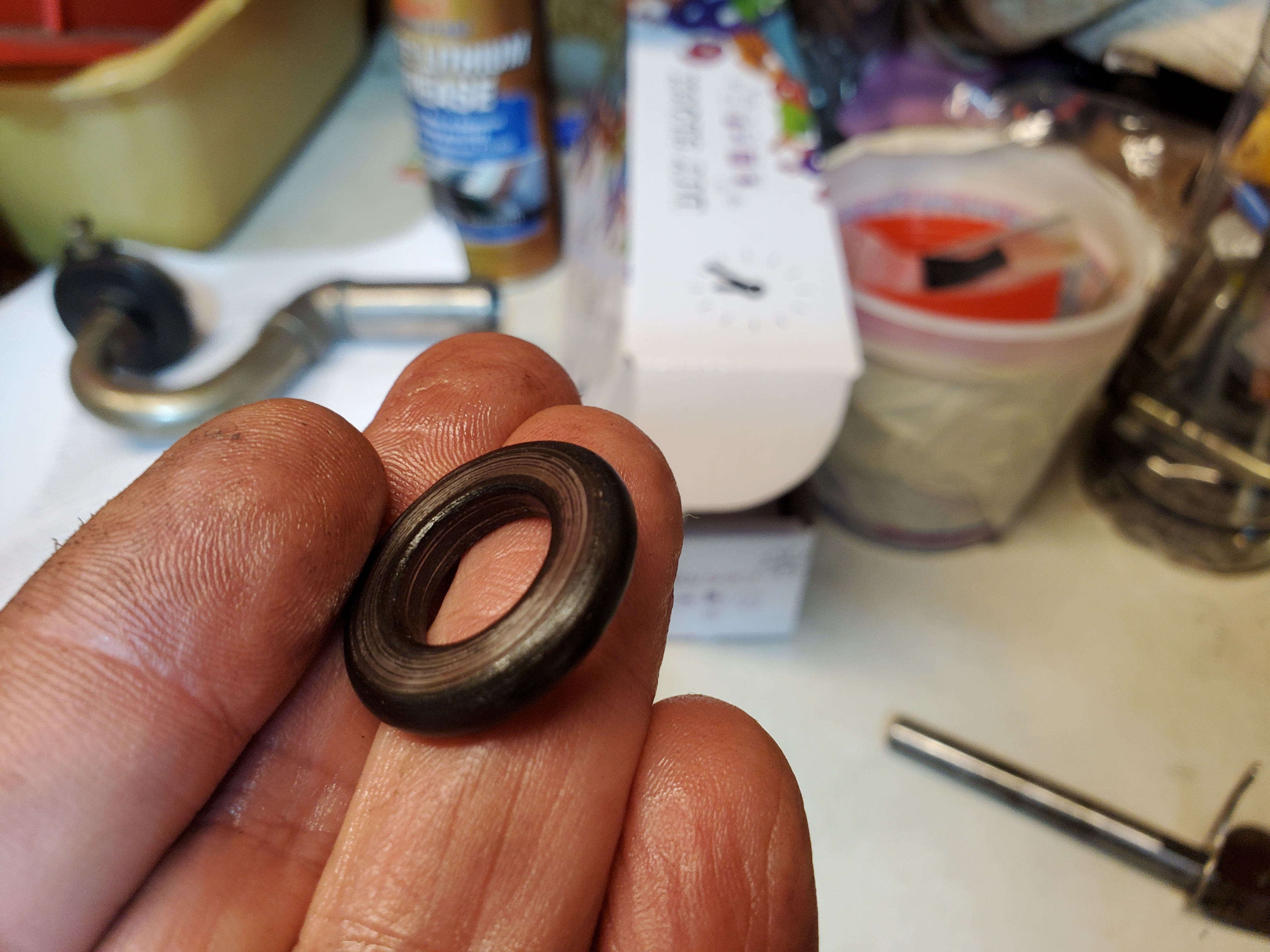

I have a very thick washer that I'm not sure which side it goes on.. top or bottom.

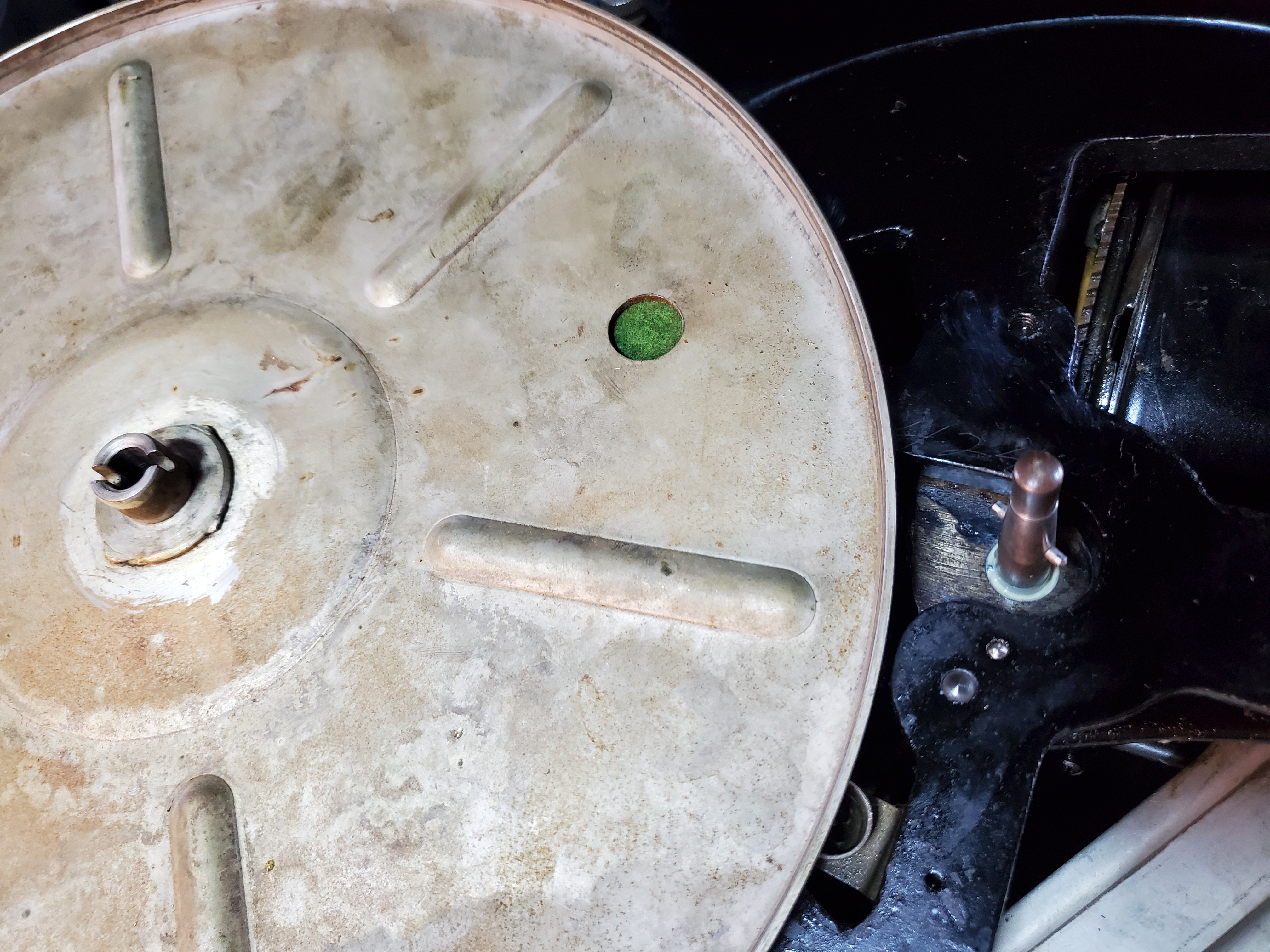

Also, I was wondering if there was suppose to be a washer between the platter and bearing.

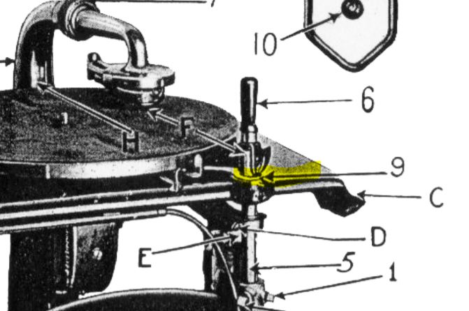

The thick washer goes on the top side of the bedplate, directly under the "stop finger" and lift knob.
I don't recall there ever being a washer between the turntable and bearing on any I've worked on.
