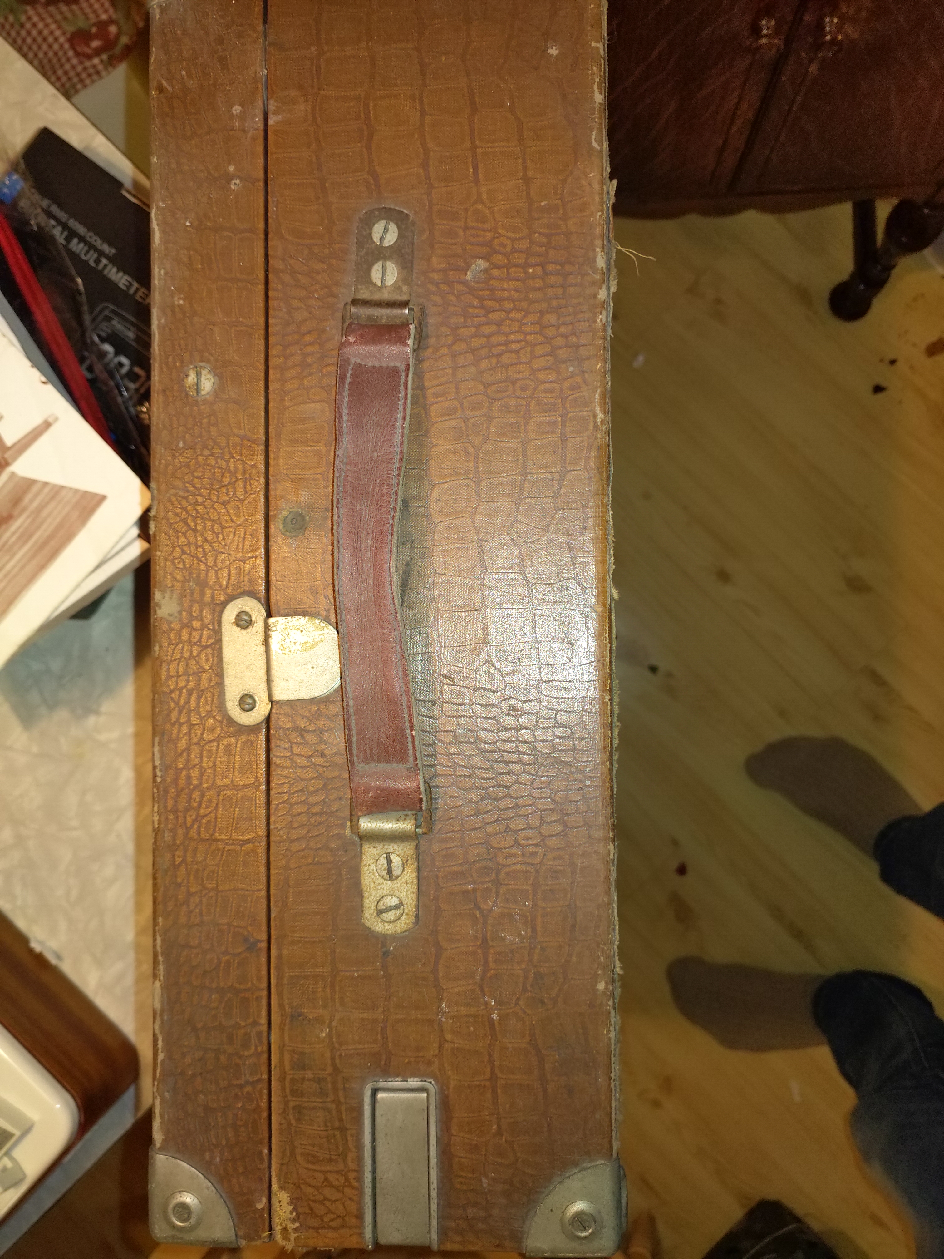

I got this HMV 101 for free today, I acted on a second when I saw an ad, also because the gramophone was situated 10 minutes away, and in a color that I don't have. It is tatty, and the cover is not at all good looking, but it is brown crocodile..or? If it is brown crocodile, is that the machine that is listed in the HMG bok as Brown (B.C.), manufactured in 1881 copies?
It has some peculiarities, the carrying handle, it must have been replaced, and this clasp, or whatever it is, under the carrying handle...

Yes, its a brown crocodile (B.C.) and extremely collectible. In 30 years I'd never seen one for sale and then 3 turned up in the past year on Ebay, the last two of which I bid on, winning one of them before setting a new world record for one as underbidder on the other superior condition example.
The leather part of the carrying handle on yours has been replaced, yes, but all the rest is correct and original.

You can renew the crocodile rexine cover by careful cleaning and then using a good shoe cream of suitable color, not difficult to find. It is a very common mid brown shoe colour. For the corner and edge areas that tend to peel off you can retouch with an ink marker of same color.
My original leather handle was also broken, not strange, as for this model it was a simple thin leather strip with two D rings at the ends. I replaced mine with a new thicker leather cinch, simply tied to the two D rings.

Inigo, thanks for posting photos of your machine, and for recommendations. I have tried shoe cream in the past for some 101 and 102 machines, and sometimes it works well for minor spots, but for bigger and more troublesome areas, I have met some challenges. It may also be caused by the brand of shoe cream of course, but for a black 102, that really had a beautiful motor board and fittings, BUT with some annoying white marks of paint on the cover, I tested a black spirit based leather paint/stain, and it worked wonders. It blended perfectly with the texture of the cover, and well...it was impossible to see that the cover had been repaired in any way. Unfortunately I did not take photos before I painted the rexine with black leather paint/stain, but the after photo is here, and as we can see...it worked wonders: viewtopic.php?f=11&t=49585&p=294438&hil ... am#p294438
I will today go out to get hold of some brown leather paint, and see if I am able to mix the paint to the correct color for the cover of this machine. I know they sell both light and dark brown of the same brand that I used for the black 102.
