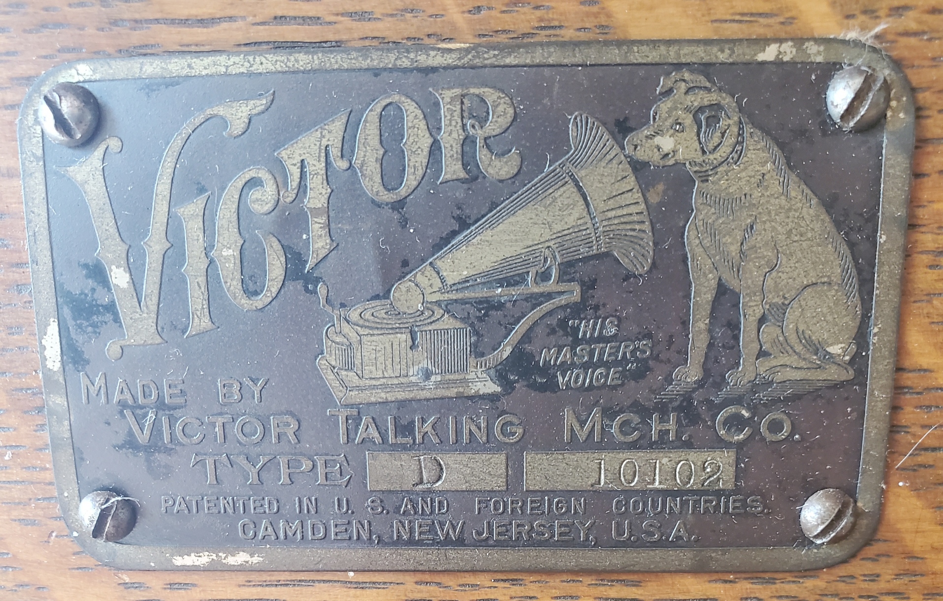

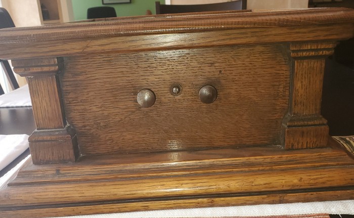

I was gifted a cabinet for a late Victor D, which is the Victor V style cabinet. It has no motor, crank, and the center of the motor board has been cut out. There is no back bracket and no horn. Am I crazy for thinking I can find these parts and restore it? The motor is identical to that of the Victor V, they used the same motor when the name was change from D to V. I have attached a photo of what I have and a photo of the motor I need. ALso need back bracket and horn. I am a little afraid of what this will cost, but I can't stand seeing the cabinet empty and I feel like it is crying out for restoration. If you have as empathetic a heart as I have for these machines, please help!

From my perspective you need:
1, 12" cast iron turntable. It's not the same as a Victor V because the D motor has a smaller spindle shaft................$200
2, Victor D motor. It's not the same as a typical Victor V.........................................................................................$400 or more
3, Big black and brass Victor horn..........................................................................................................................$300
4, Original horn elbow...........................................................................................................................................$200
5, Elbow clip & screw............................................................................................................................................$ 25
6, Back bracket. Only a back bracket from a D, V, or VI is the correct size................................................................$200
7, Original slotted crank.........................................................................................................................................$ 75 or more
8, Round hole Exhibition........................................................................................................................................$ 75 or more
9, Nickel tone arm.................................................................................................................................................$100
It's an uphill battle to start with an empty cabinet or one with a damaged top board.

It looks like the motor board was cut out squarely, leaving a frame around the hole. I think you could make an insert to complete it, preserving the edge molding detail.
