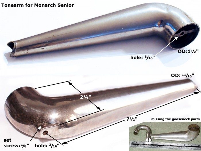

1. The tonearm of my 1908 Gramophone Co. Monarch Senior "Ionic" misses some parts of its tonearm (see picture, note that it is about 1" longer than for the Intermediate Monarch and that the hole for the swiveling rod, 3/16" is larger than for some G&TC and HMV tonearms). The original cylindric piece broken off, had the Gramophone Co. recording angel trademark sign engraved (https://i.etsystatic.com/10438453/r/il/ ... 4_n1fu.jpg). I will also be happy to get it without that trademark. How difficult is it to solder or weld that piece into place?
2. I need also the elbow connecting it to the mahogany speartip horn.

1. tonearm: I am not sure which of the two tonearms you have for sale. And I also cannot see the right ends of them. Attached is a drawing I made, that shows several variations of Victor tonearms. It is important that all essential features agree, that is the length, gooseneck size, screw, and pivot hole diameter. I found out that the tonearm of the Monarch Senior and the Victor M are identical.
2. horn elbow: Again I don't know which one you are selling. I need the one, that is marked "original", with the screw cutout on top. My back bracket is it the one where the elbow is held in with a flange, clamp and thumb screw.

Please note that it has some dents on the underside and the set screw mount has been re-soldered at some point.
It looks like it's 8 inches on that measurement, but it's less then that, but a little longer then 7-¾ inches.

Also, if you have the tone arm and it's only missing the goose neck, there's lots on eBay that will work, you just have to know how to solder _ a jig would be required and it may need nickel plating once the soldering job is done.
If you're still not sure about my tonearm, you may try it, and if it doesn't work, you may send it back, but I'm pretty sure it will work.

This goose neck should fit in this tonearm.
You can adapt the whole tonearm, if you can live with the screws which will now face up, half way up the tone arm.
You can also fill the screw holes and nickel plate over the filled holes, the plater can do that for you.
Or you can use the goose neck mount to solder on your tonearm.

If you use my bits on your tonearm, you may have to re-plate it.
Unsoldering may ruin the plating because it would have been soldered first and then plated.
Heating things up after the fact may discolour the nickel, but you be able to polish that out, it's hard to say.
