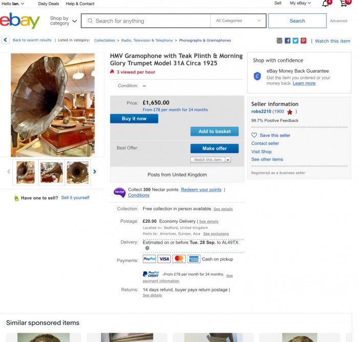

I see this machine has reappeared. The seller has put more effort into his pictures than the auction house and these do reveal a rather beaten up horn. I think the sellers hope of making a grand on the machine is a little ambitious especially considering the parts that are not correct.
https://www.ebay.co.uk/itm/313680155470 ... nl%3Dmkcid
The brief appearance of an HMV 31

That's got to be worth £200 of anyones money.

Check the spring barrel marking - looks like 10 (feet). If this is correct it carries budget length springs normally only used for portables, suggesting a cheapo Indian origin ??.
32 Motors are equipped with 13, 15 or if you are very lucky, 17 feet springs. My 13 footers (cleaned, re-greased and fully wound) only manage about 5 minutes of "useful" tension and another minute or so of "rundown" so this thing will probably have a severely restricted running duration.
The horn is a joke and the soundbox a bit ratty so, even £200 seems optimistic....
