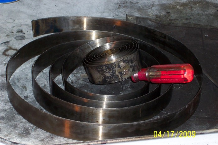

Not too happy to see this in the first spring barrel I've ever taken apart... Judging by the grease, someone (fairly professional by the looks of it) repaired at least one broken spring in the Vic 3. I haven't taken apart the other spring barrel, but I hope it's not the same way. It seems to be riveted together (and probably the source of quite a bit of noise in the motor). Anyone else run into stuff like this? I think it's pretty neat to find old, old repairs.
Yeah, I've run into several of those, but usually on British or Indian (tropical) HMV machines. I think it was a fairly common repair when and where replacement springs were hard to get. Reiss actually talks about it in his book, "The Compleat Talking Machine." Whenever I encounter those, I throw them away and replace them. On one Indian HMV 2 spring machine, both springs had been spliced, one of them in 2 separate places.
I think the more of them you do, the more weird stuff you will see. The worst thing I have ever seen was a spring that was broken at the inner coil. The previous repairer poured molten lead into the center coil to fuse the broken spring.
